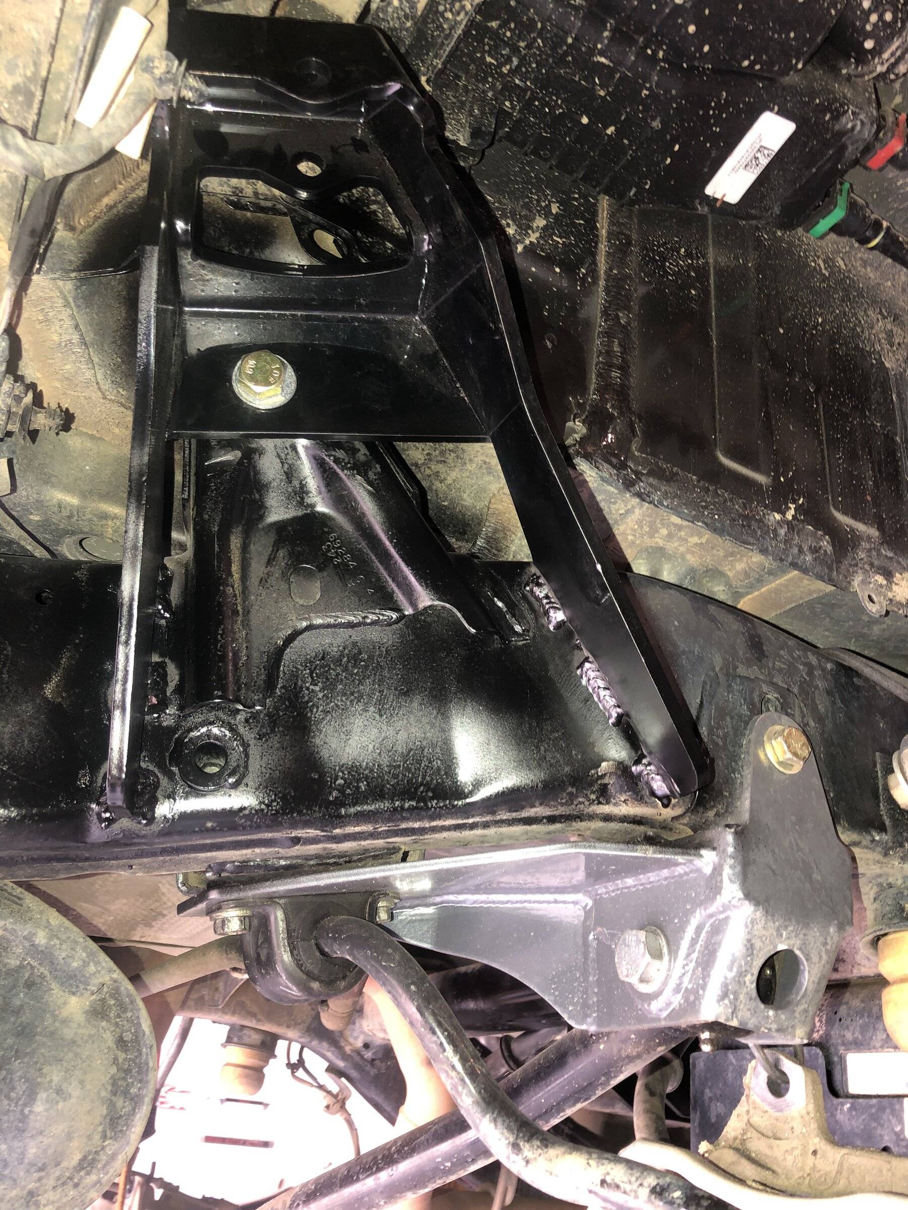

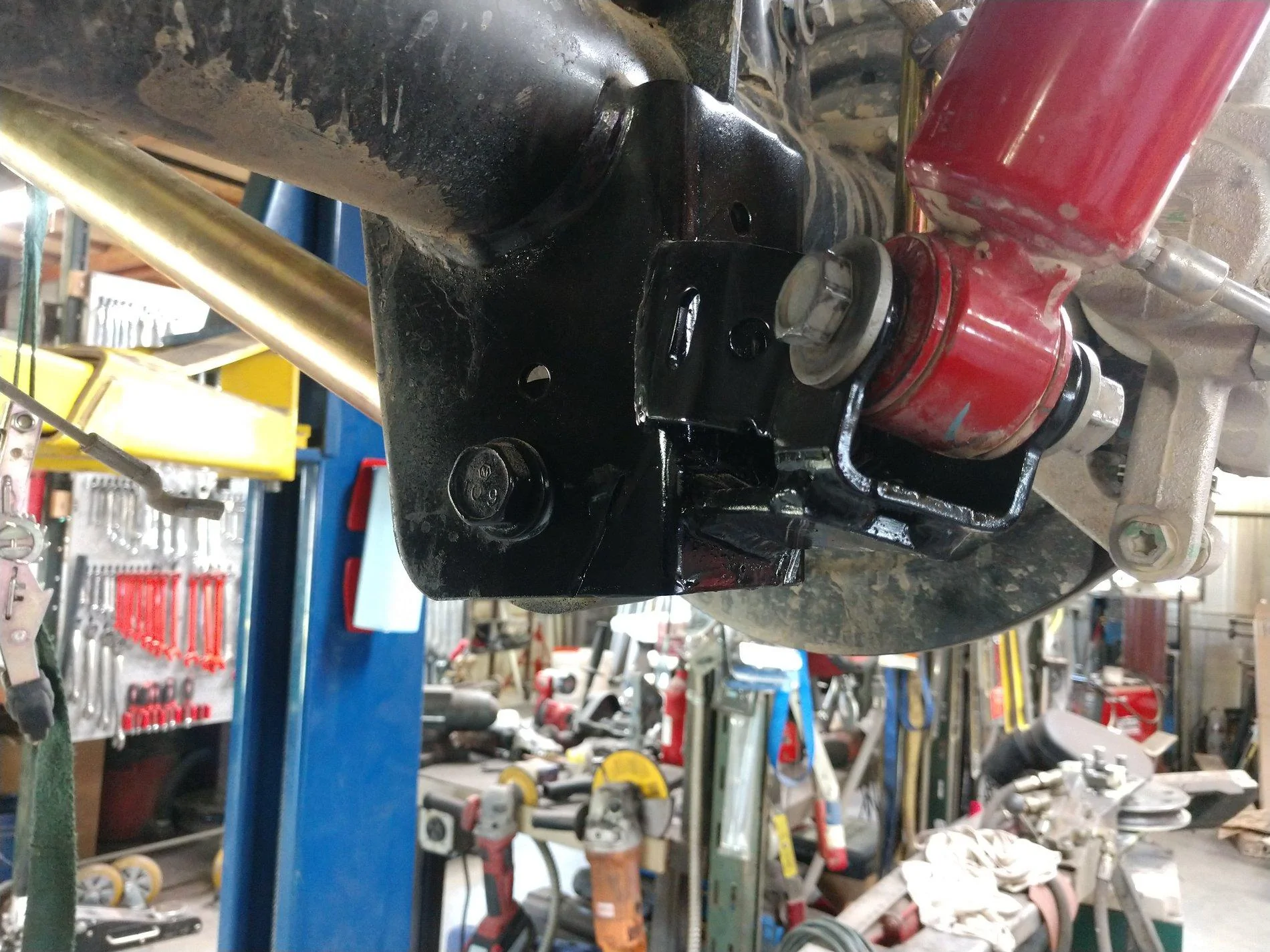

I can't be the first one to have done this but the factory shock mounts are pretty easy to cut off.
Grind off some paint, move 'em up and make some bright light....
I figured why give $90 to MC when I'll have to lop the originals off anyway. Oh, I did weld in the nut for the sway bar so I just use a wrench from the outboard side
Now when I get the "knock" in my rear diff the dealer can claim my welds caused the differential to give out (hey, ya never know!) :)

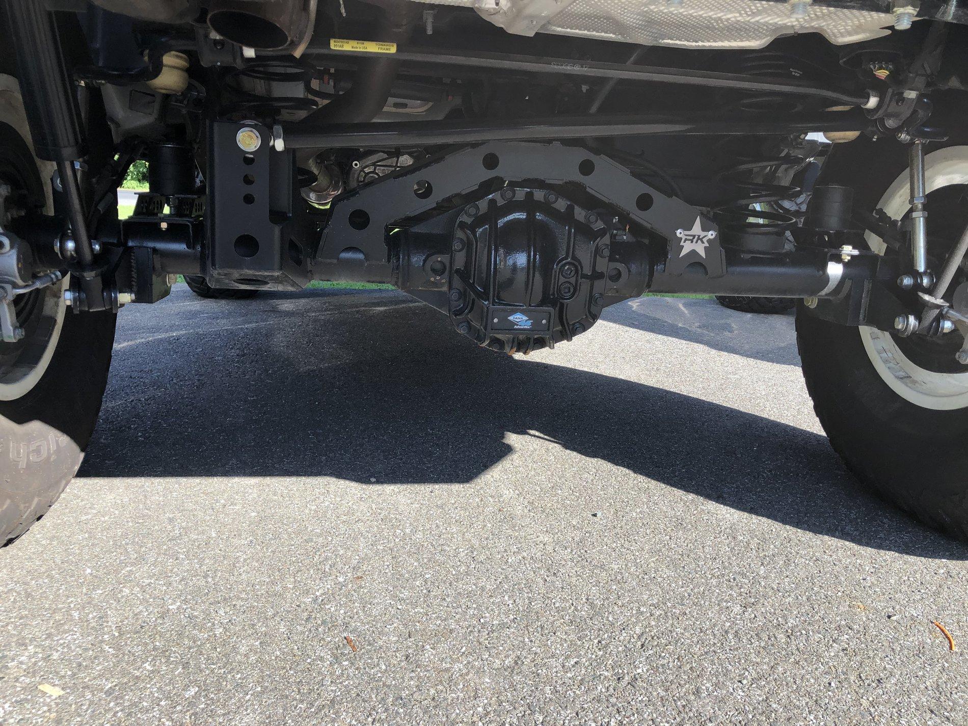

We do a similar thing with rear shocks on our 3 link long arm rears. We move the shock mounts up to get the bottom of the axle tubes cleaned up and help to prevent hang ups as well as shock damage. We also raise the mounting point on the frame side to account for the raise on the axle so you don't loose suspension travel.
