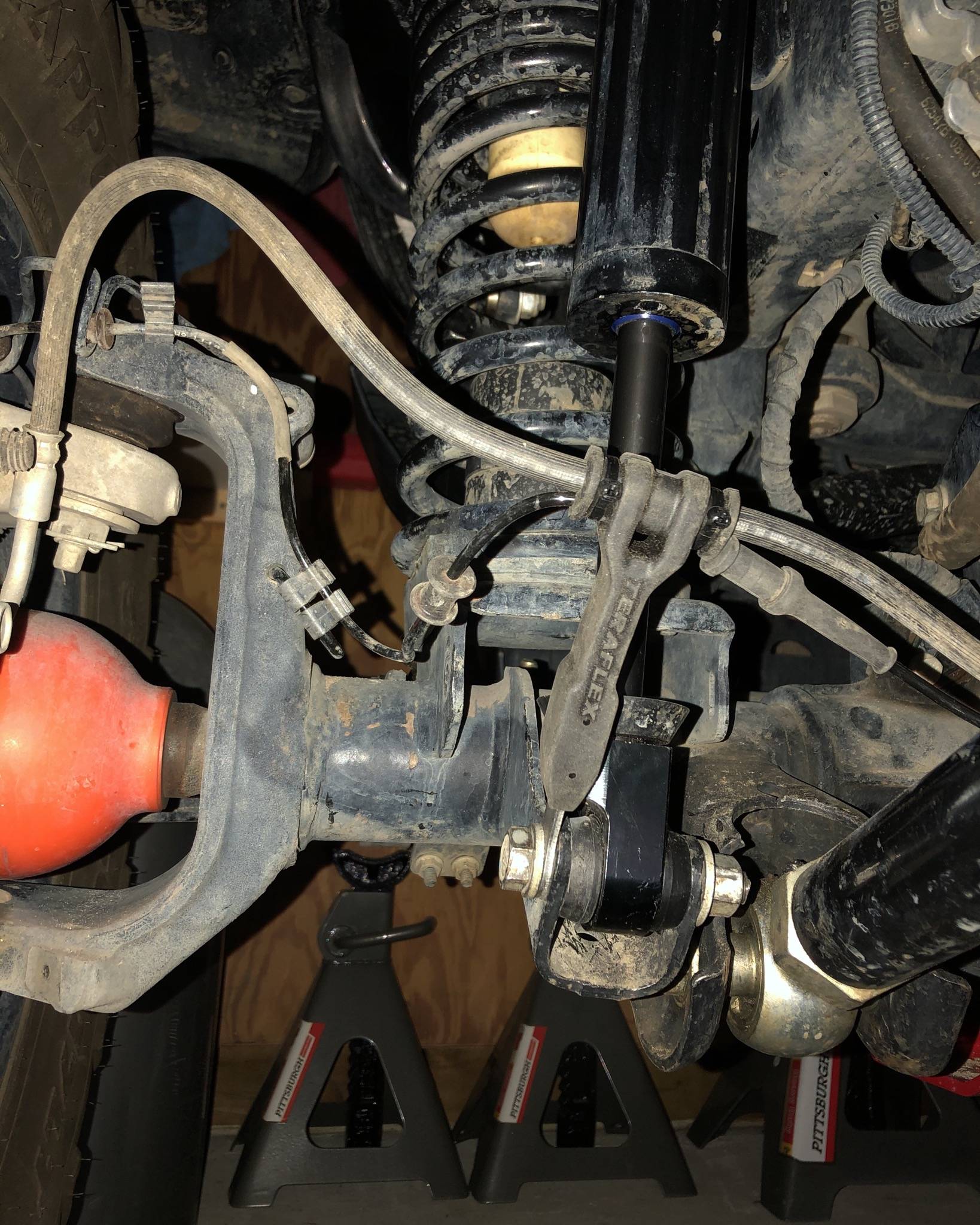

I’ve used a right angle impact adapter and an impact step bit successfully in those kinds of tight spaces. As to the brake line bracket (the one that used to bolt to the lower control arm) remove it altogether using pliers and vice grips to bend it open.
Jeep Wrangler JL Metalcloak Front Lower Shock Relocation Brackets 1700793536763

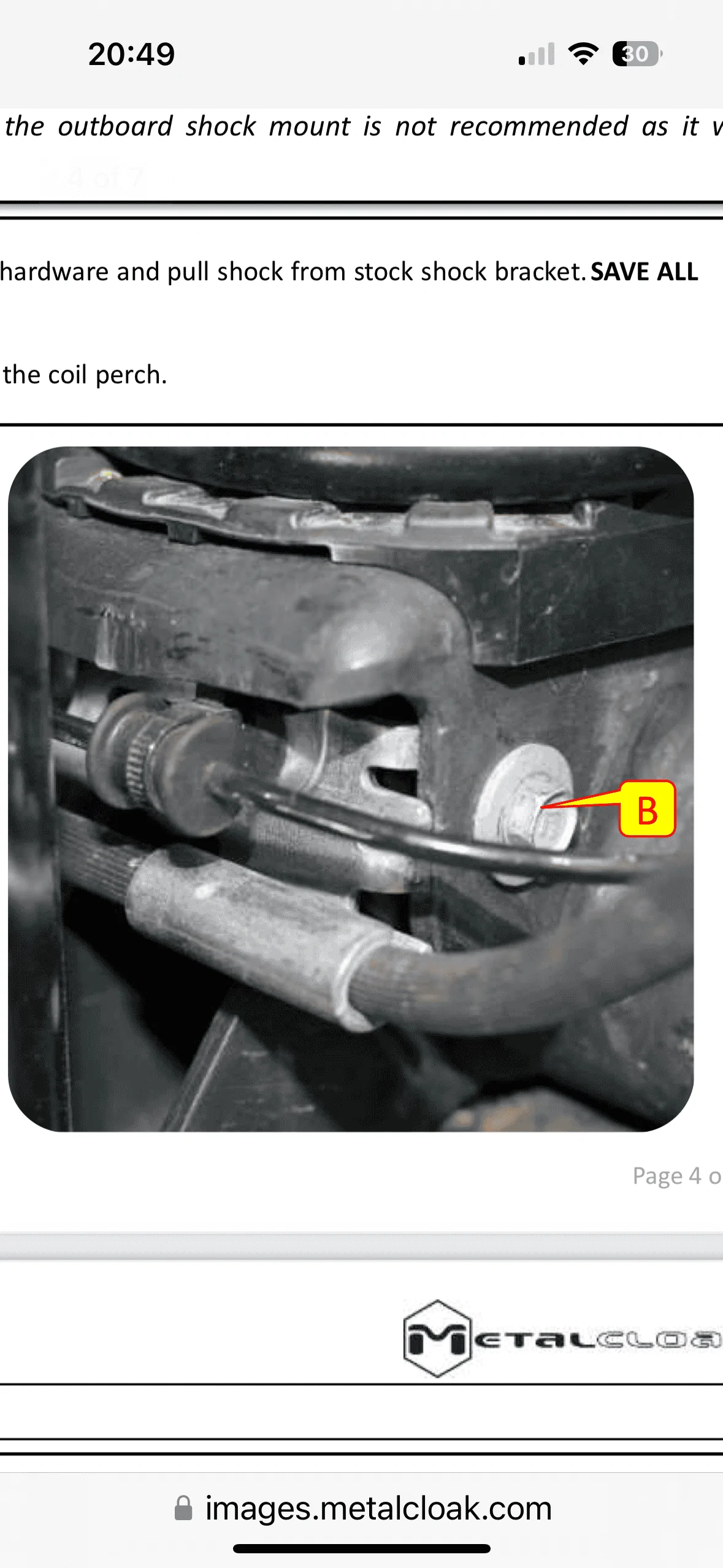

This is the bracket that nests under the spring perch. Not the LCA one.
Jeep Wrangler JL Metalcloak Front Lower Shock Relocation Brackets IMG_6262

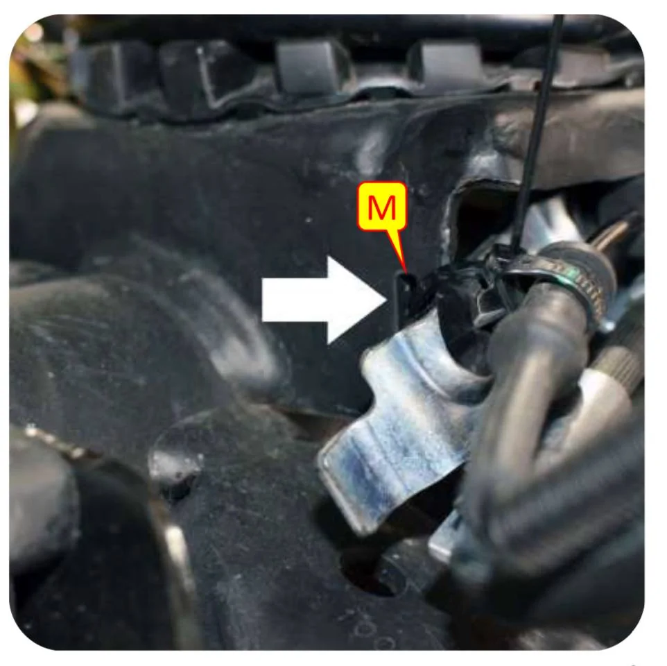

You just zip tie it around the line, to the slot on the inner side, where the metal tab used to go. Their photo is of the passenger side.
Jeep Wrangler JL Metalcloak Front Lower Shock Relocation Brackets IMG_3363
