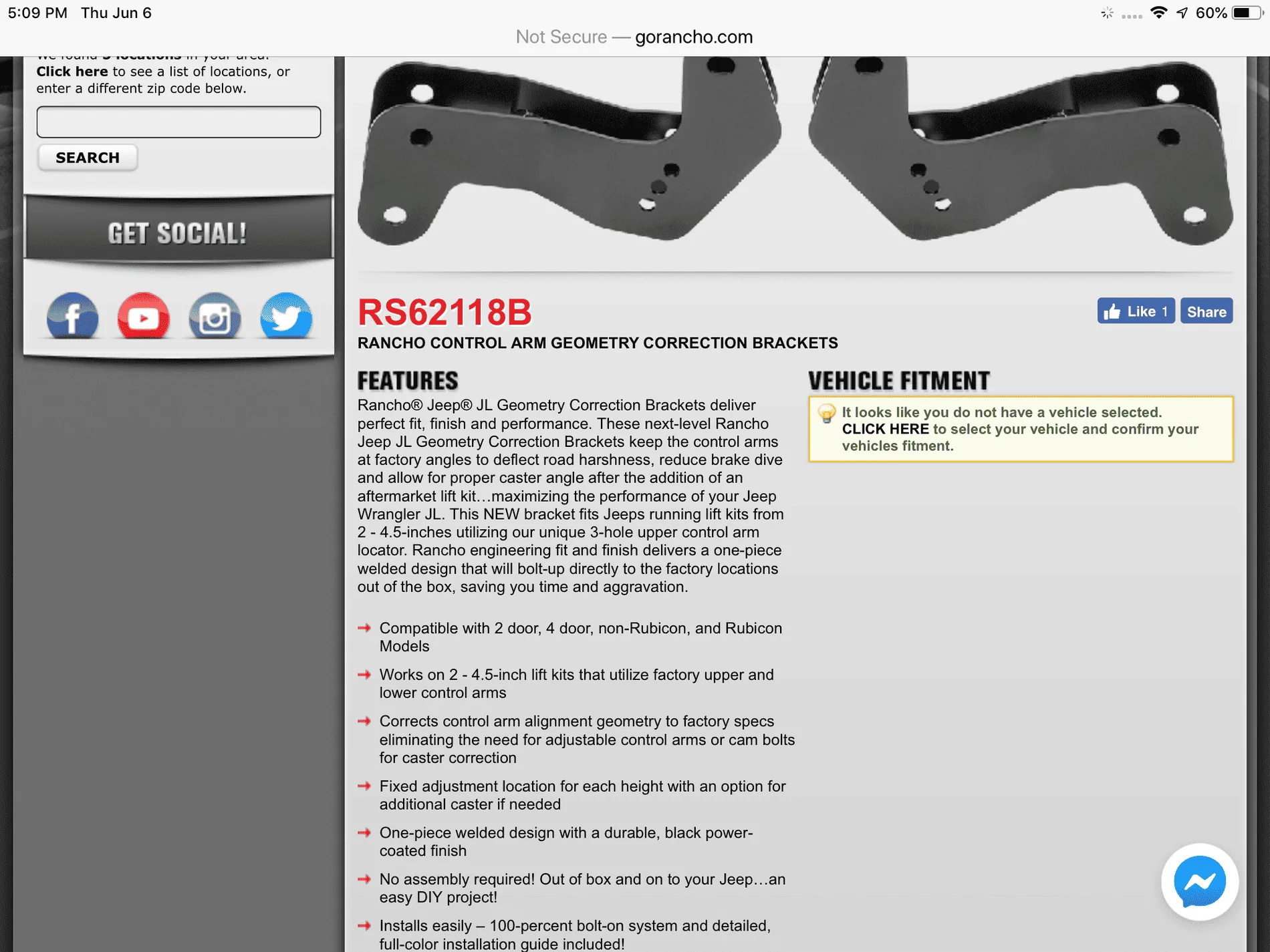

you definitely don't need a new steering stabilizer. in fact, you don't even need a steering stabilizer at all. it's just something places like 4wp like to push to separate you from your money. as far as brackets vs adj control arms, you really need to think about what your end goal is for your Jeep. are you going to be doing mostly on highway driving, fire and dirt roads, etc. then geometry correction brackets can be better for that. are you planning on getting into offroading in rocks and more technical stuff? then, you'll want adj lower control arms as the brackets will hang up on stuff.

From what you listed, I’d suggest new adjustable control arms. I try to avoid the brackets as they diminish ground clearance and there’s no way to dial them in to your particular Jeep

If you are a rock crawler, I'd avoid brackets and go with arms.
If not, they are great. I have had them on a few jeeps and they really improve the ride. Rubicon Express has them if you want to stick with the same brand. The Rancho ones are super beefy. Either will do the trick.
