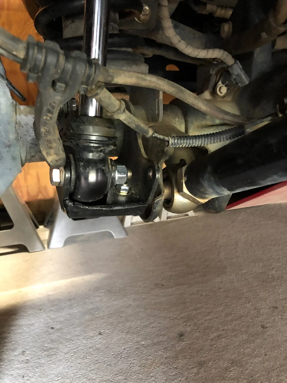

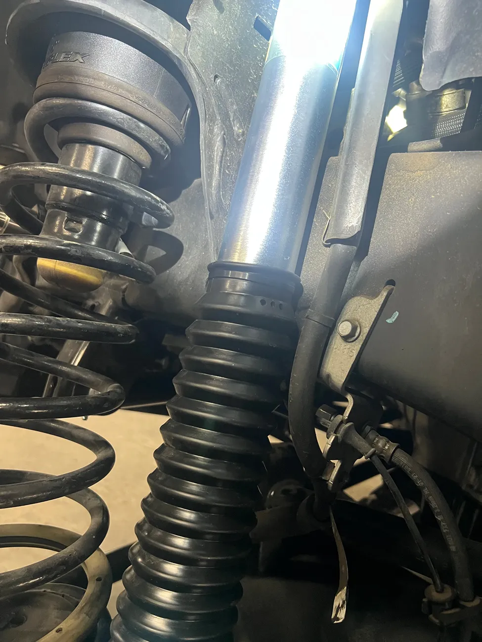

This is the photo they sent me of the contact being made when they picked her up with the forklift.
Jeep Wrangler JL Question about Shock Compression / Extension with Relocation Brackets 1746809645783-I6SXD2G7HU5MTF4ULNC40W
It was almost at full flex, but they said it had some room left to go and they stopped before it fully hit.
I did have removable sway bar endlinks installed (and in the removed state) at that time, and this is with them removed. With the Rubicon sway bar disconnect, will I get less travel and mitigate this issue?

It is just making contact with the boot or actually leveraging the body?
They said it would have made contact with the body of the shock if they continued lifting, but they stopped to not damage my shock before achieving full flex.
I'm really wondering if swapping to the Rubicon swaybar in it's disconnected state may be relevant. Maybe the disconnected links allowed more flex than I should have ever had, and now that I'm back closer to OEM, maybe I'd be ok.

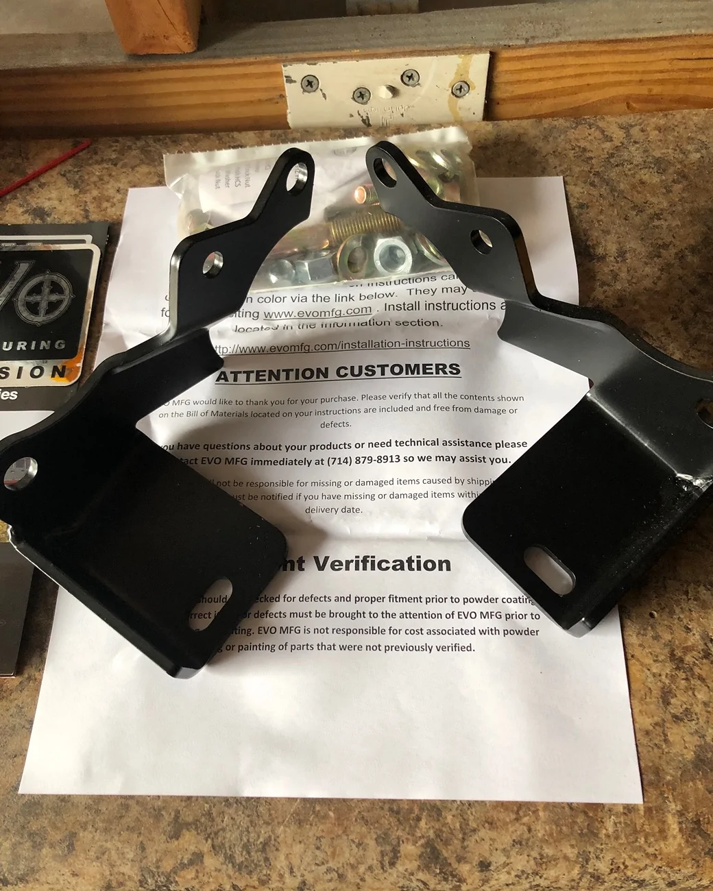

If you have to use an outboard bracket, and you don’t want to raise the elevation of the shock, and you can’t use the 7716s then get the EVO brackets…. I ran them for a couple years, then switched to the 7716s when they came out…
I’m running long travel shocks and I liked how the MC bracket turned the shock eye 90 degrees…… here’s pic of EVOs on …..

Do you have these on Rubicon or a non-Rubicon? Curious if the clearance issue MetalCloak refers to is valid here too.

Here’s a link, look in the fitment section to be sure, but I think they work on all trims… mine is a Rubi though….
https://www.northridge4x4.com/part/...blQYvVSNgB8IO2Xdlo7HSHjqCMJ#confirmed_fitment
Unfortunately, per EVO:
Thank you for bringing This to our attention. Narrow axles is not recommended.

This is good to know about the EVO brackets, thanks….. As for the sway bar links, you want them long enough so the sway bar doesn’t invert at full droop if you’re using the Rubi disco……Also by moving the shock shaft up, you’re increasing the droop so just make sure the spring is staying put, since it’s not a dual or triple rate spring….
I would take another look at just how hard the shock is hitting the frame, I don’t think it’s enough to worry over looking at the pic, but it’s hard to tell for sure…If it’s just touching the frame you’re fine….
