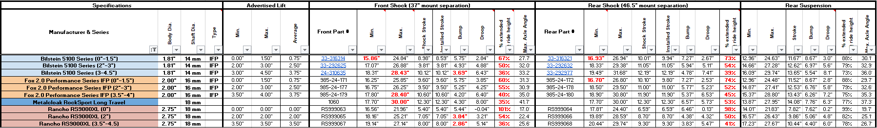

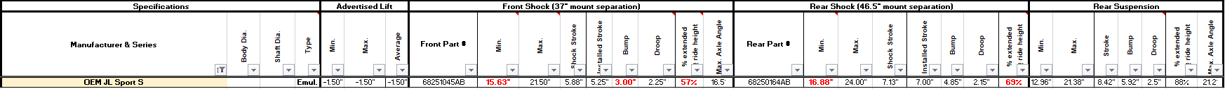

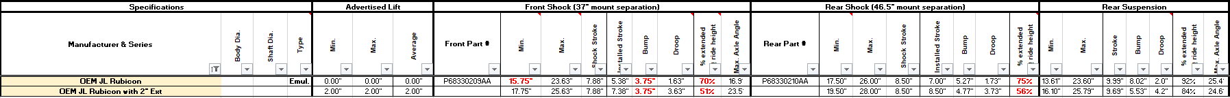

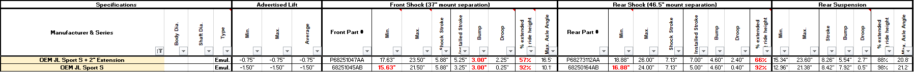

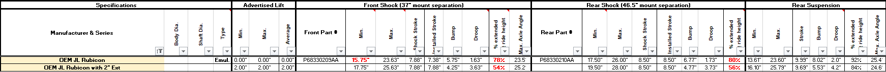

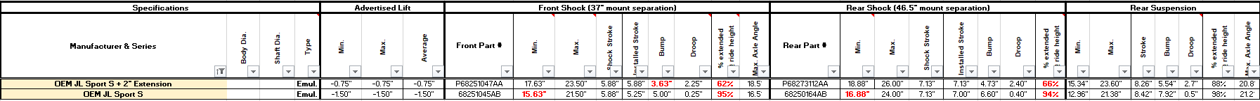

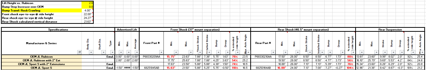

Alright, I geek out on this shit, and there's so much partial info that its easy to just accept that the manufacturers know what their talking about when it comes to "lift heights" for shocks.
While I have a 4xe, I have a Rubi instead of Sahara, so I'll try to account for that in this. I went through all this and have personally run, AND I have the ride height shock measurements for them after spring settlement:
1. 1.5" TF + 2" Bump + 2" TF Shock Extensions on 35" KO2s
Front: 22" Rear: 24.25"
2. 1.5" TF + 2" Bump + Bilstein 5100 3-4.5" on 35" and 37" KO2s
3. 3.5" MC Springs + 3" Bump + Bilstein 5100 3-4.5" on 37" KO2s
Front: 24.25" Rear: 26.75"
Note: The 1.5" TF Spacer is 2" in front!! That means Stock front shock length at ride height on a 4xe Rubi is 20" Settled. Let's assume 3/4" less for the Sahara (I can change this if OP gets me the measurement) and that the Sahara has the Sport Shock Travel. I'm using AnnDee's spreadsheet and data, plus some additional stuff I have, I'm adjusting to settled height per my measurements.

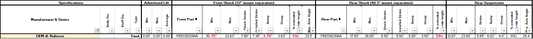

Stock:
Rubi 4xe @ 20":
Jeep Wrangler JL Shock extension question 1644595030081
Sahara 4xe @ 19.25":
Jeep Wrangler JL Shock extension question 1644595065306
1.5" TF Spacer, No Bump (2" Front, I'm not going to adjust the rear specs down for the 1.5"):
Rubi 4xe @ 22":
Jeep Wrangler JL Shock extension question 1644595185249
Sahara 4xe @ 21.25":
Jeep Wrangler JL Shock extension question 1644595292994
1.5" TF Spacer, 2" Bump (2" Front, I'm not going to adjust the rear specs down for the 1.5"):
Rubi 4xe @ 22":
Jeep Wrangler JL Shock extension question 1644595410550
Jeep Wrangler JL Shock extension question 1644595369985

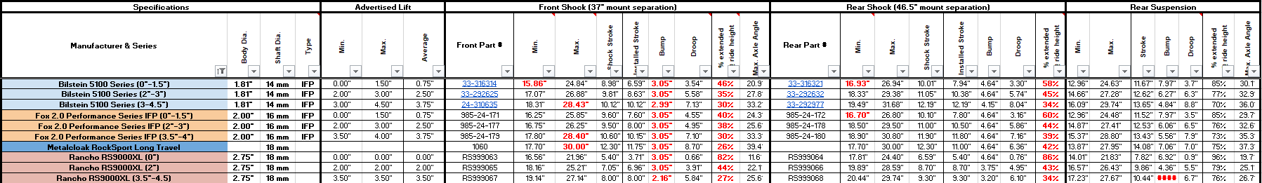

Some Aftermarket Options, 1.5" TF Spacer, No Bump (2" Front, I'm not going to adjust the rear specs down for the 1.5"):
Rubi 4xe @ 22":
Jeep Wrangler JL Shock extension question 1644595934884
Jeep Wrangler JL Shock extension question 1644595917980

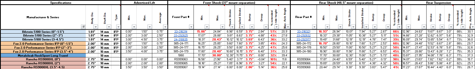

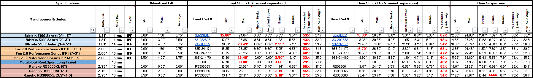

Some Aftermarket Options, 1.5" TF Spacer, 2" Bump (2" Front, I'm not going to adjust the rear specs down for the 1.5"):
Rubi 4xe @ 22":
Jeep Wrangler JL Shock extension question 1644595592298
Jeep Wrangler JL Shock extension question 1644595613397
Conclusion for the OP's 4xe use case:
1. If extensions are used, bumps must be extended because the shocks become the bump stops.
2. If extensions aren't used, there is approx 0.2" of downtravel available!
3. Rancho was smoking something when they designed their JL shocks.
4. Without bumps being extended, OP is limited to Bilstein or Fox 0-1.5" Shocks because the shocks become the bump stops.
5. With bumps extended, OP can use Bilstein or Fox 3-4" Shocks and end up with 33*+ of front axle articulation
TLDR:
1. No Bumps and No Extensions would suck.
2. Bumps + Extensions bare minimum
3. No bumps, Bilstein or Fox 0-1.5"

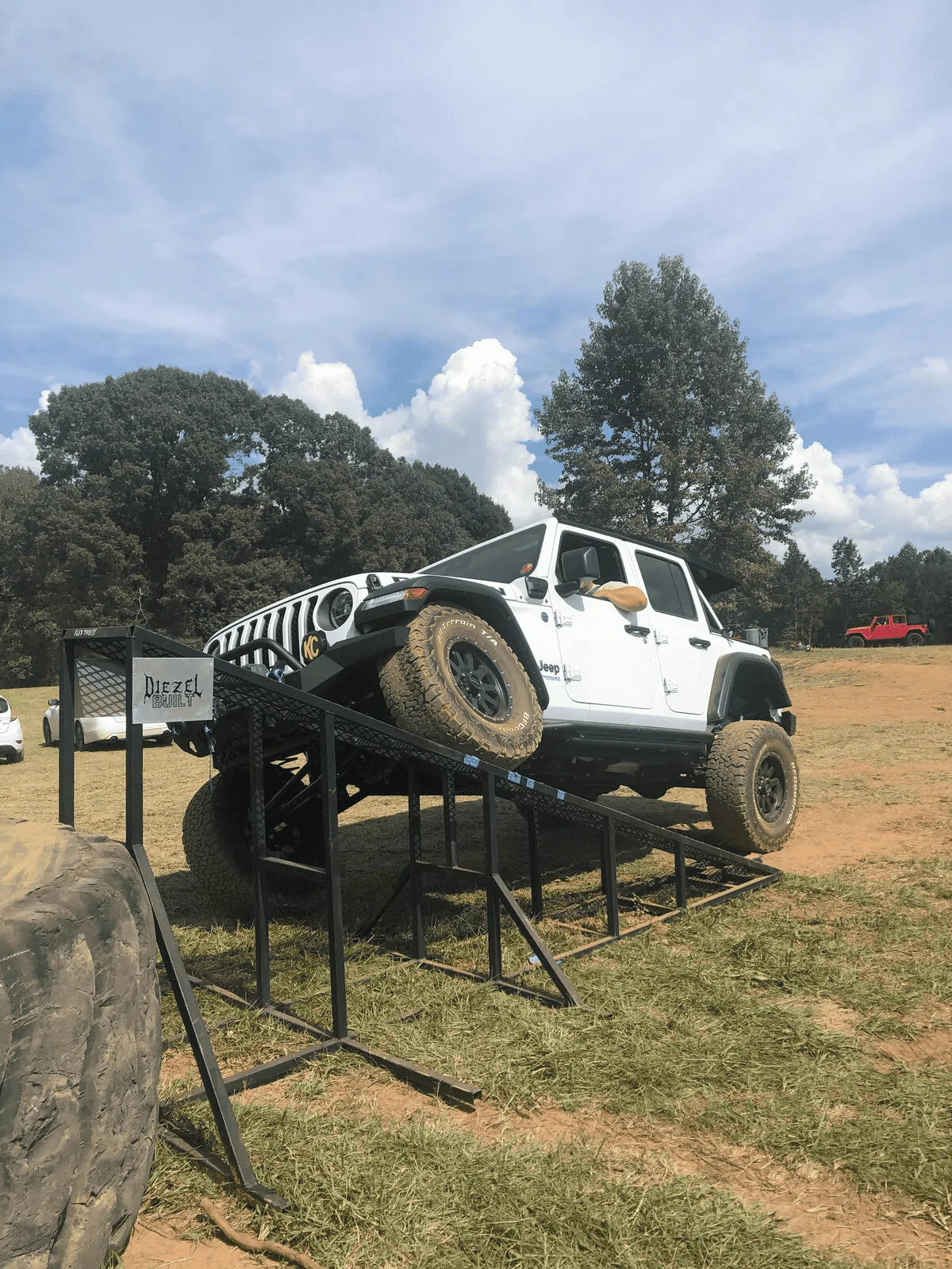

4. With bumps, Bilstein or Fox 3-4", and you can show off on the ramp at Jeep events. This is 1.5" TF Spacer, 2" Bumps, 3-4.5" Bilstein's, and was bumper clearance limited at the time:
Jeep Wrangler JL Shock extension question 1644596690383

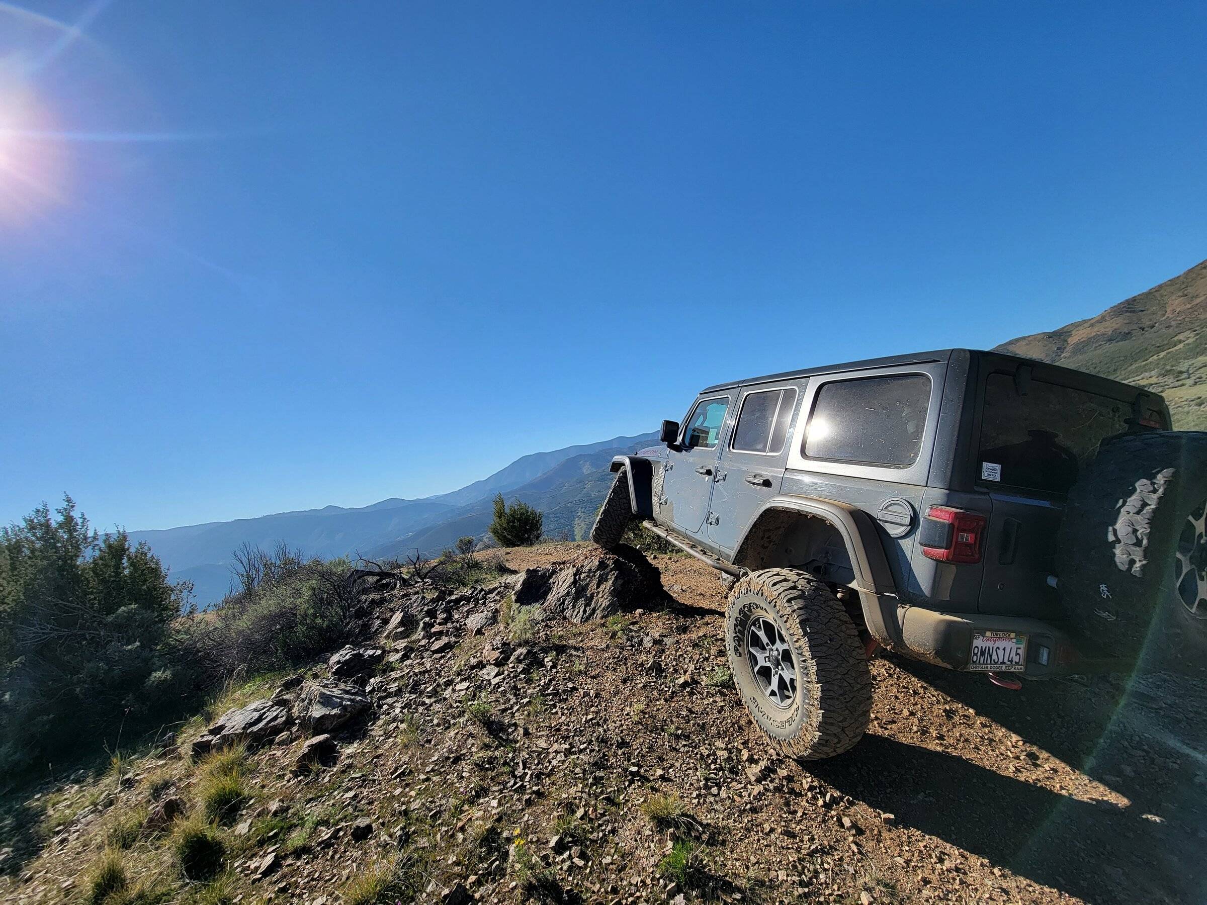

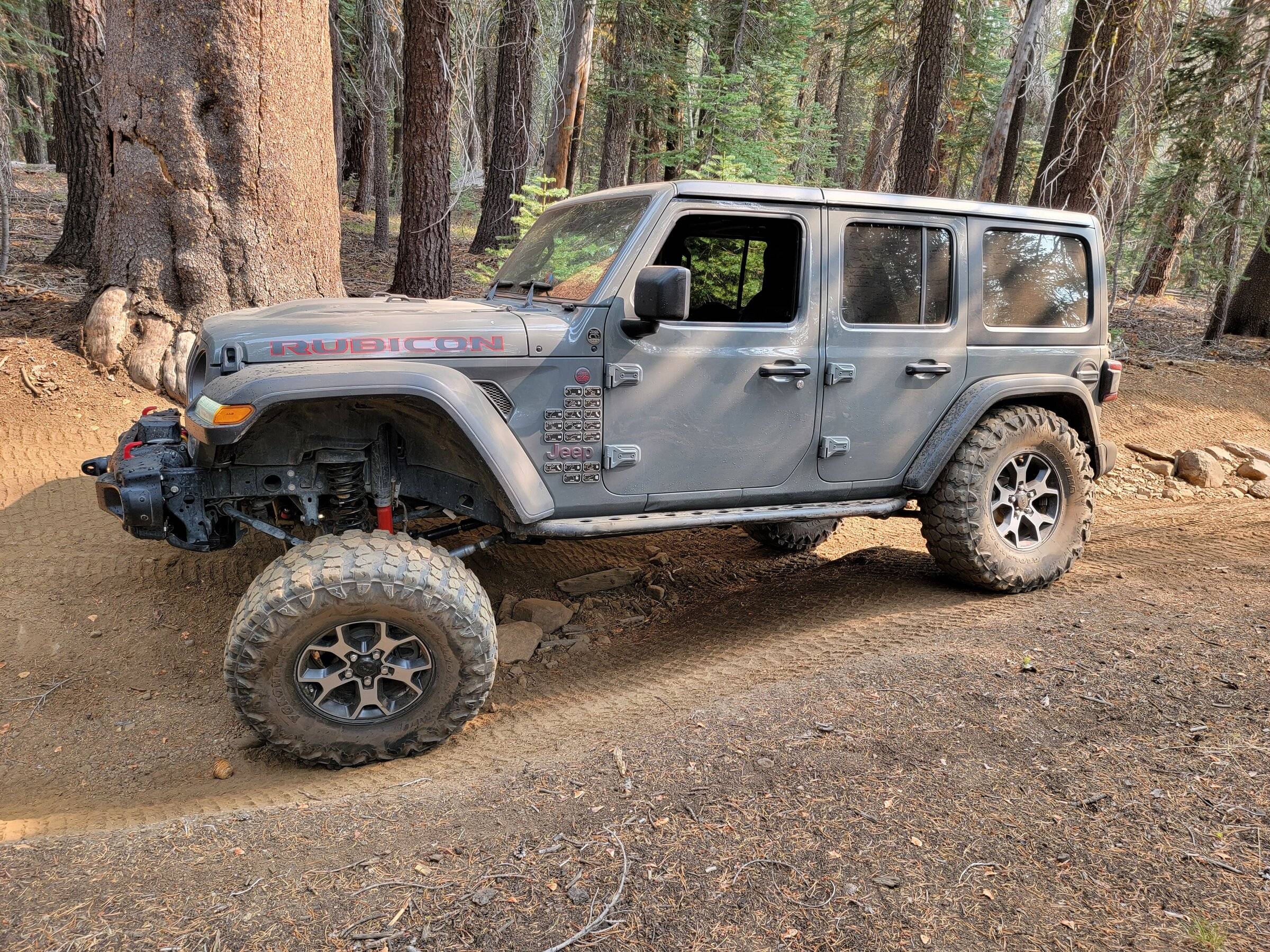

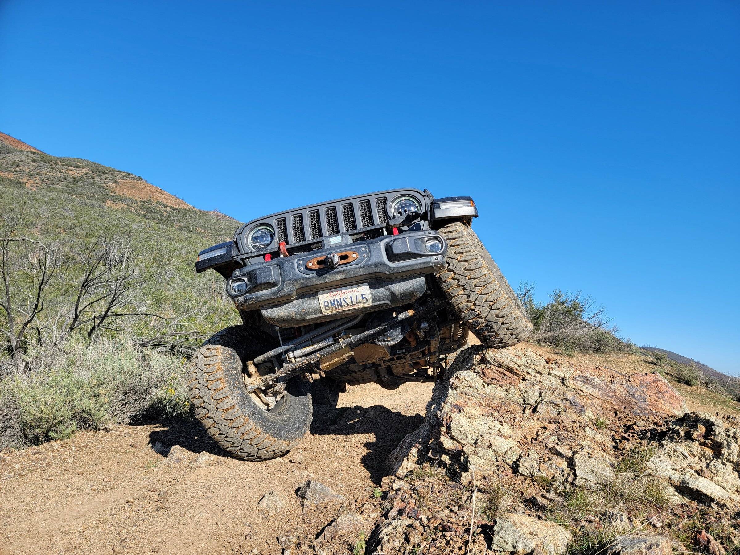

A simple 2” bump stop extension and metal cloak rock sport shocks for the budget conscious and the Jeep will flex like it should. We ran a 2.5” spacer, rock sports, and 37’s for ~20k miles with stock track bars, steering, and ball joints. Only other suspension mod was rubicon express adjustable LCA’s in the front. From John Bull/Holcomb creek/ gold mountain in CA, to Moab including Hell’s revenge/fins/top of the world/poison spider/golden spike/gold bar rim to tillamook,OR trails to the Dusy Erishim trail. Anybody who thinks you need a full kit to flex and/or wheel is buying in to a narrative not speaking from experience. We then swapped out the springs, front track bar, tie rod and ball joints. Improved steering, which was worn from ~30k miles of hard use but didn’t make a huge difference in flex or ride. We are now at about 4” of lift and only ~$2,500 total in to the suspension/steering. I'd say it flexes amazingly for a budget build.

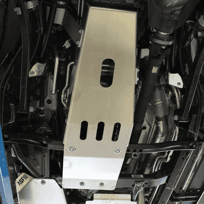

Great feedback, I agree it's easy to look past what really determines flex and buy into the "you have to have a full, proper lift kit" whatever that means.
One note, and I'm not sure how close the non-4xe is, but with the 28.43" front extension on jackstands full droop, my stock driveshaft contacts the crossmember at the slip joint. I assume this is slightly worse than ICE because the transmission is longer, pushing the transfer case output toward the back.
I may be overconcerned because it would only really happen if you were turtled on a ledge, but I could definitely tear that slip joint boot, and I have more than 1.5" less droop than the Rocksports.

The front crossmember got deleted when the asfir engine skid went on and the front driveshaft got replaced with a traditional u-joint style for more travel. If you are going for maximum flex other mods start to become necessary, but they don’t come with the ”complete kits” either.
GATORB8
May 30, 2021
8,833
11,735
CLT NC
21 JLURe, 06 LJ, 25 HDZR2
Damn, you got my hopes up. Looks like the 4xe specific ASFIR uses the crossmember, unlike in the gasser.
