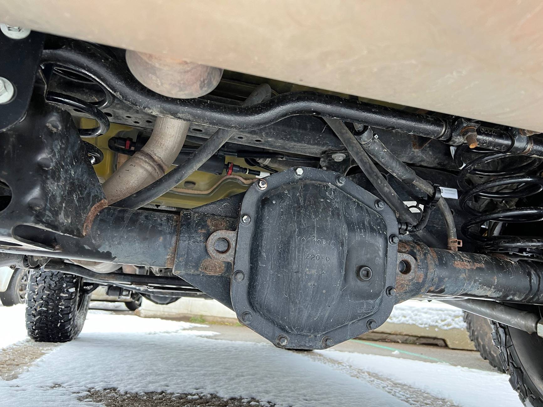

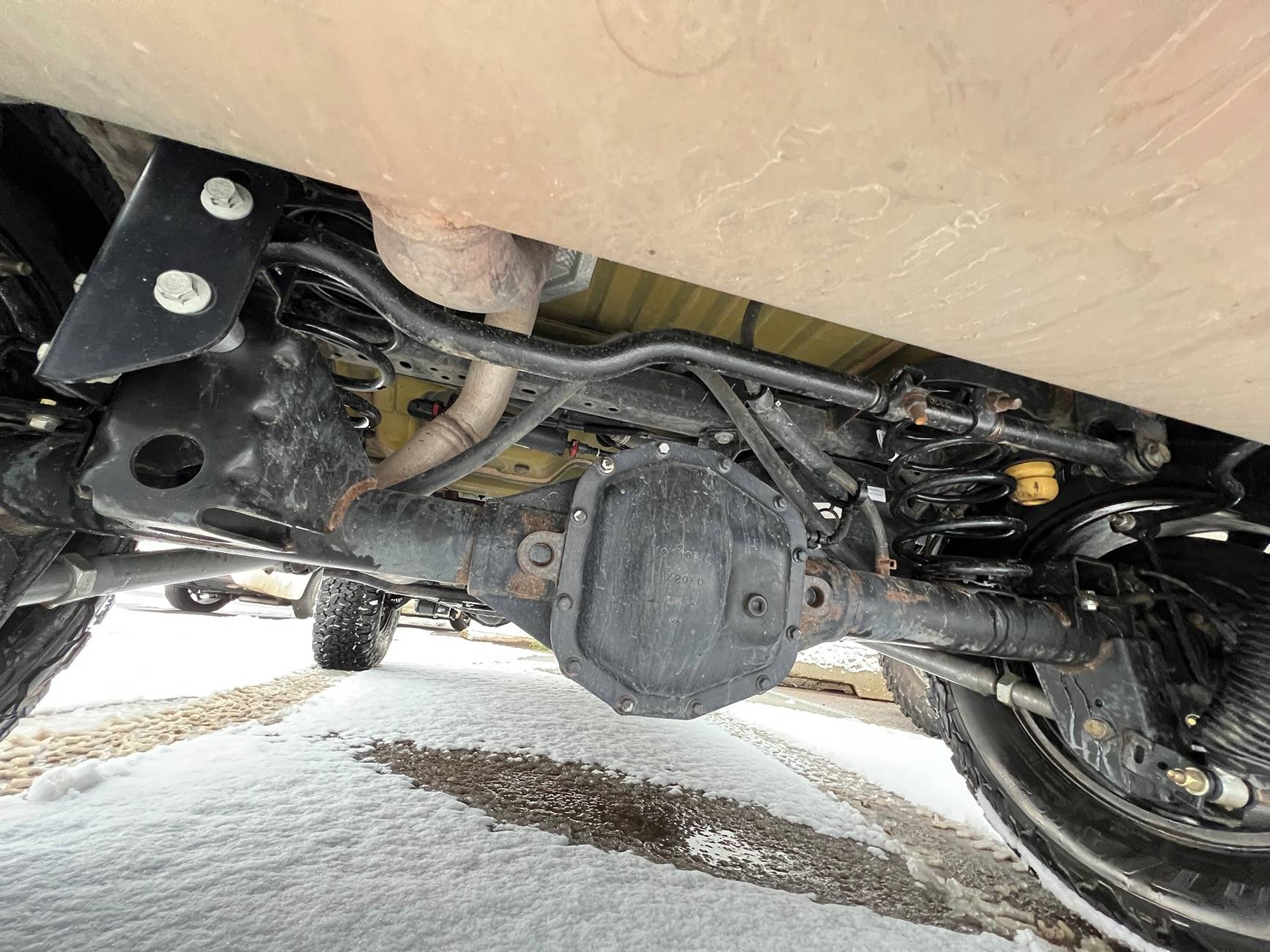

For those guys out there who are still chasing a fix for the JL passenger side lean/lower on passenger side.
After installing my Teraflex rear track bar relocation bracket for my 2.5 in lift ( I already had an adjustable bar), the Jeep is no longer leaning to the passenger side. In fact it is now a little higher on passenger side but that is because I had put a 0.5” spacer on that side in attempt to level the jeep initially, which only brought it to within 0.5” of drivers side. So I may pull that spacer out soon.
I never believe in things like the gas tank or spare tire weight so much because from experience those things had a negligent effect on the level of the Jeep on a 4 corner basis.
