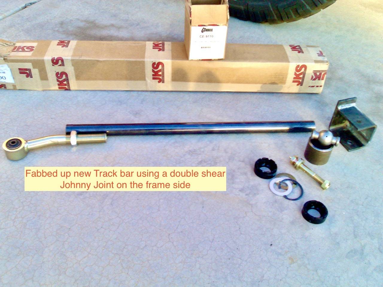

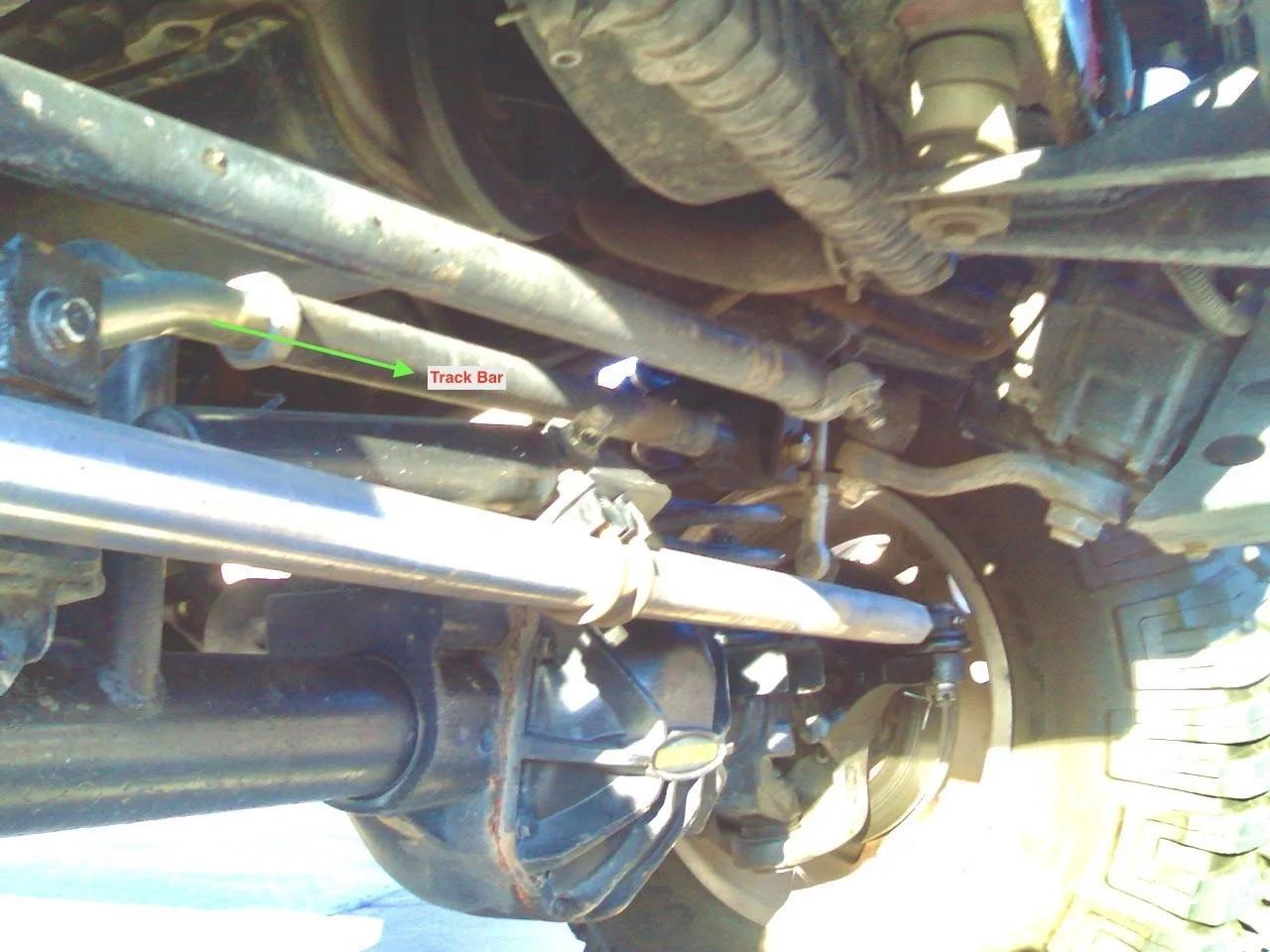

Been there done that about 20 years ago. Did it on other Jeeps.
Easy Job:
Bear in mind you are making a MAJOR change and your resale or trade is not going to happen unless you find another Jeeper that UNDERSTANDs what you have done and buys into it.
I put all my bars parallel to the axle/ground plane, Death wobble never showed up again after I did that and I drove it for another 80k miles.
NOTE the Track bar does not NEED to be centered with this setup.
The reason why I relocated the steering box is due to the pitman arm angle, which I changed and it also gave me a change you really weld down my Steering box assembly and straighten the angle. Bump Steer comes from a mis-angled Pitman Arm.
This is why my Jeep is engineered and fabbed by me and not buying "KITS" which are always a compromise, nor are they built to my standards.

This pic (above) still has my old curved Track bar, I changed in the first pic.
This is the redo of the Track Bar axle side mount.

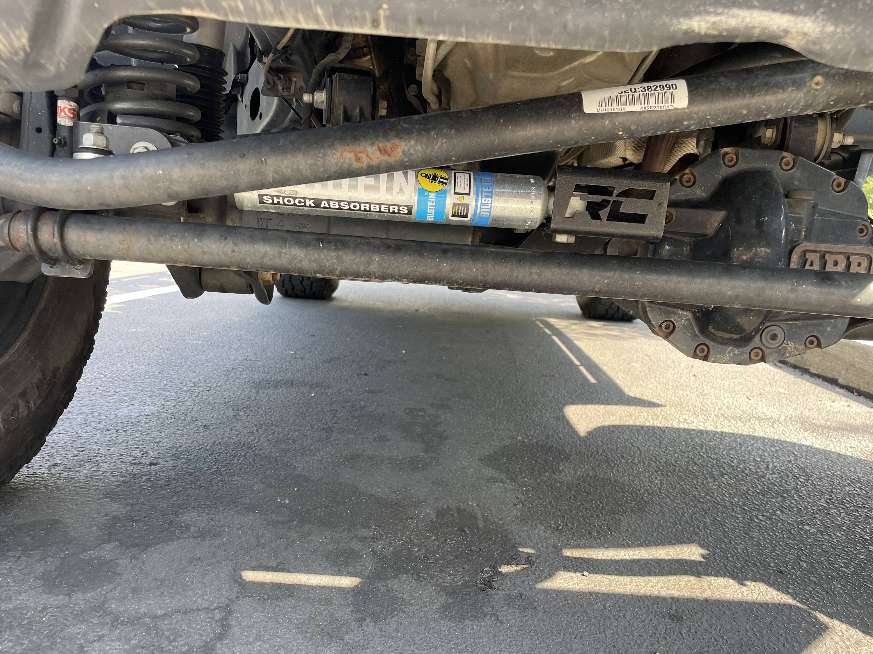

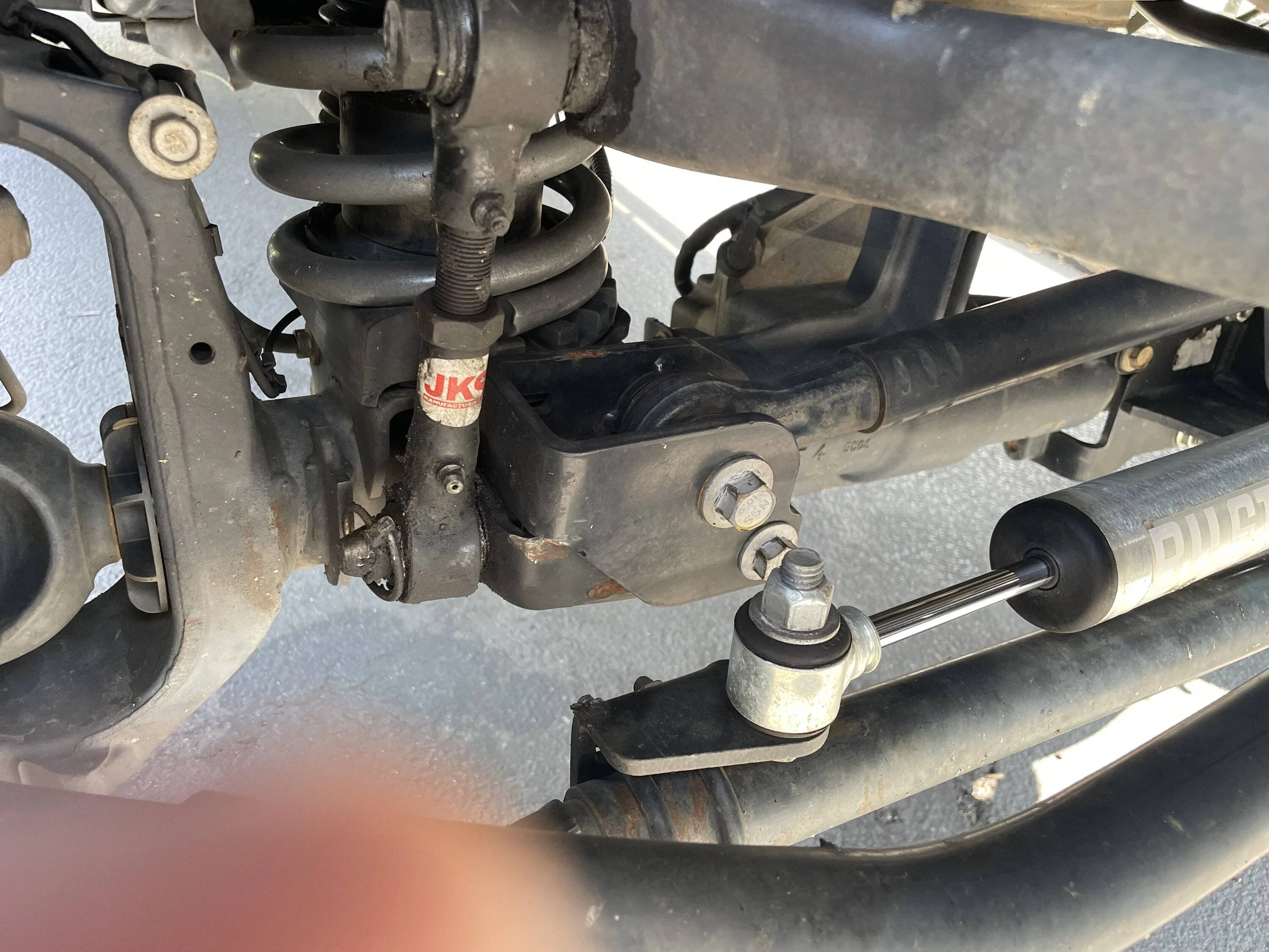

Here is a couple pics with my teraflex setup. No issues at all since install as I said. I drive 17 miles each way to work on highway and a half dozen wheeling trips.
