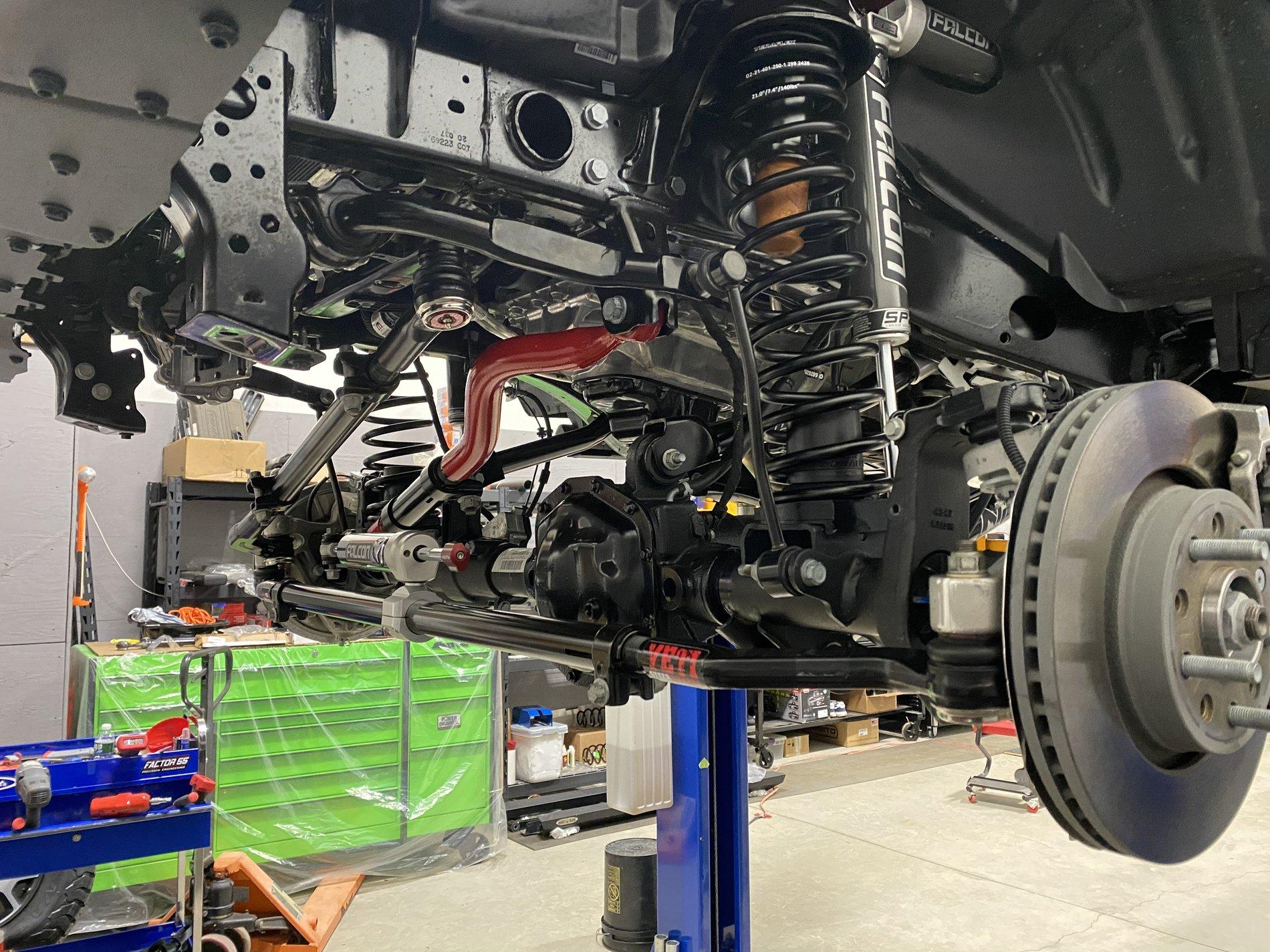

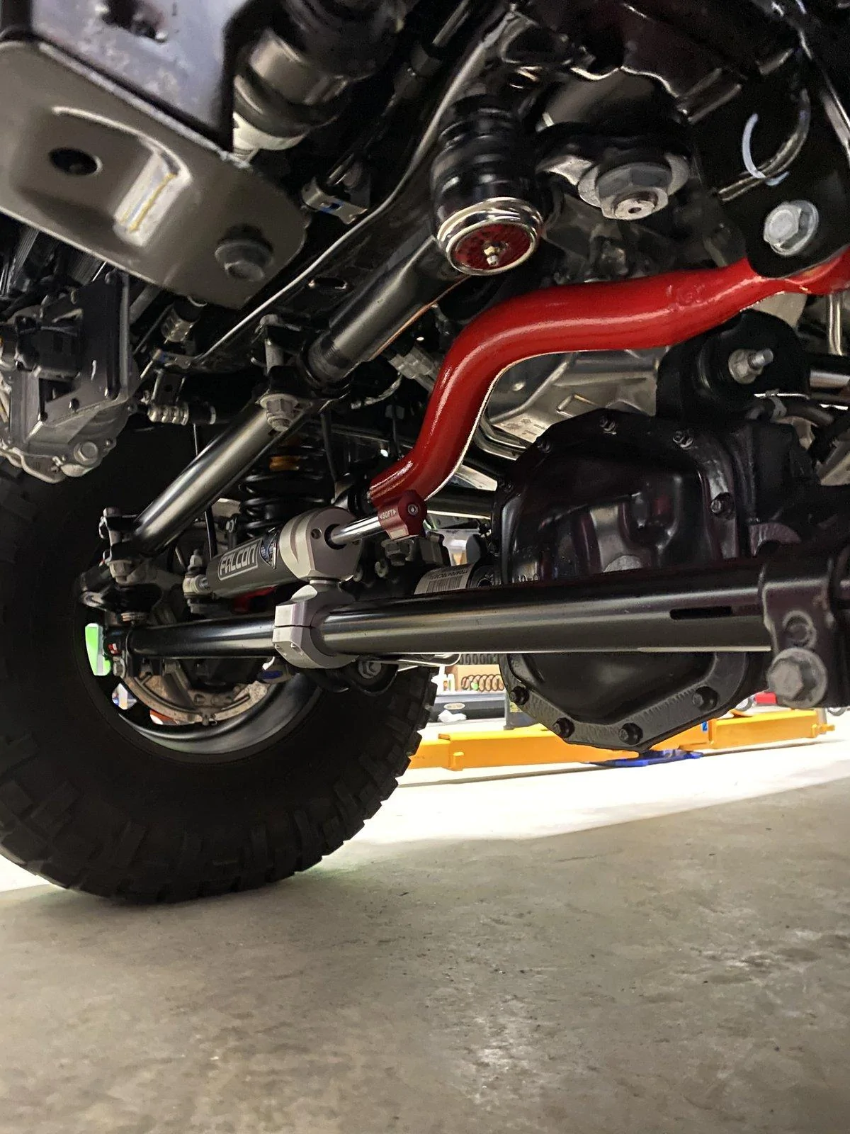

A good track bar and steering components makes all the difference in the world. I’ve tried and tested several different track bars and by far the best one made is the SS Yeti, no debate IMO. . There was a huge noticeable difference over the Teraflex track bar it replaced. As others have said, it is critical to keep your track bar and drag link in line. I run a 3.5” Teraflex lift on 37’s and it probably dives better and straighter then most factory stock Jeeps on the road.
