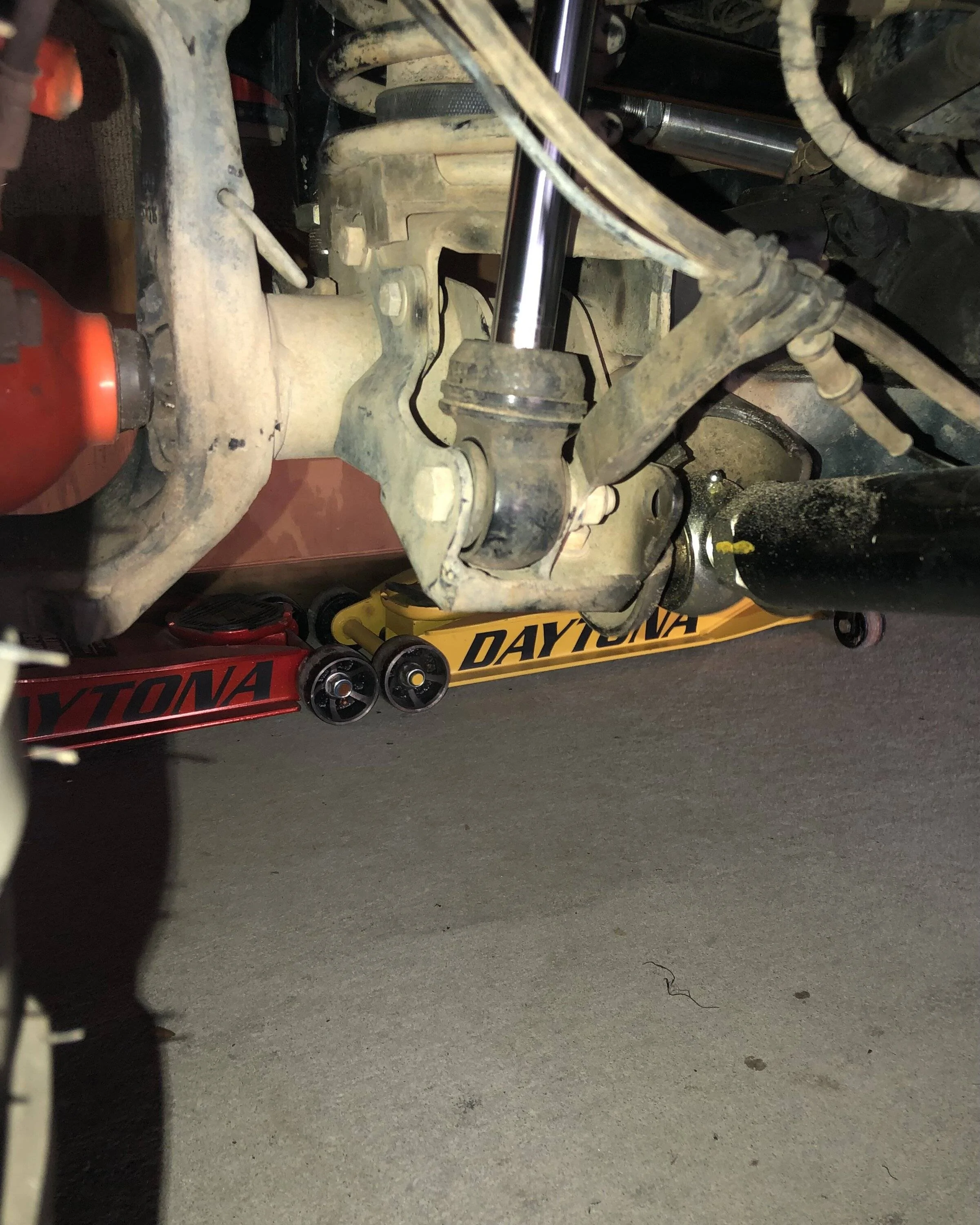

Asking anyone running a Dana UD60 which front outboard shock mount you are running? My Fox 2.5 are hitting frame a full flex. Thanks!

Thanks Roky. I have those but they wont work due to the bigger axels tubes and different bolts unless I moc it up which I might do.

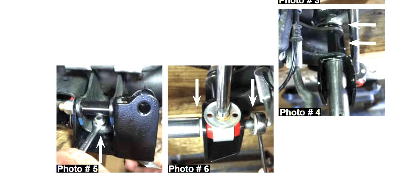

You take a look at the skyjacker's? They seem to mount differently than EVO/MC
Yeah, I was thinking you could use it as a guide, and fab something similar….
Yes, I think if I shave off some of the metal I could get it to work and maybe just throw some weld on it to give it more strength.

Looks like the Skyjackers may be the ticket. Just in case, as another option, the longer Bilstein 5160s come with an outboard mount. Would assume Bilstein may sell them as parts, would be pretty easy to fab. It's a U shaped bracket that goes from the inside face of the stock mount, bolts to the bottom of the mount. The longer shock bolt goes through both the factory and offset sections with a bushing in the factory mount.

Thanks! I just ordered the Skyjacker that looks pretty simple and should work. I will report back soon I hope.
