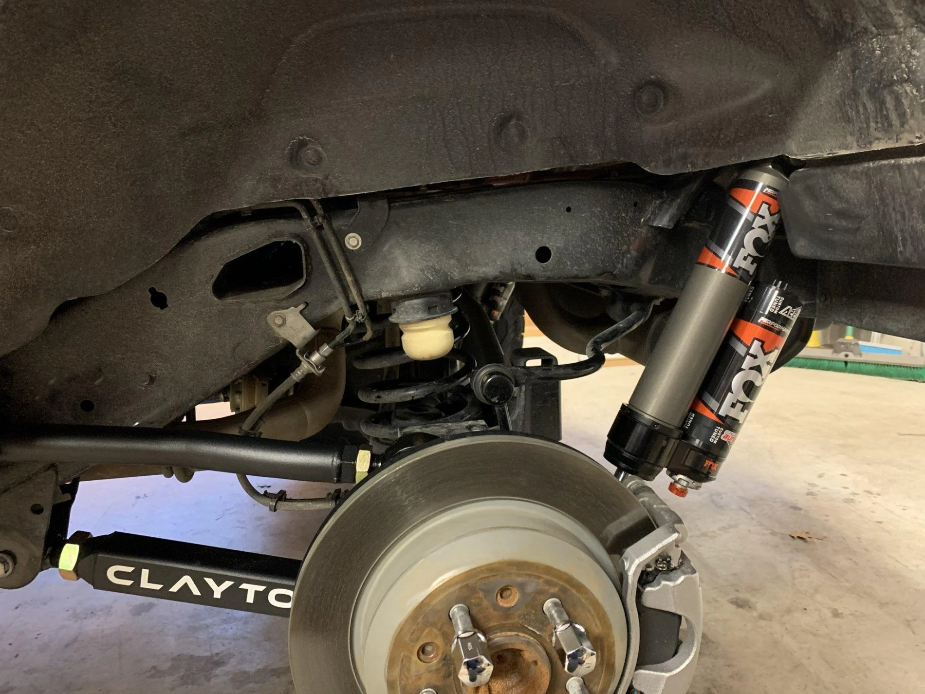

So I had a chance to get the shocks installed and put a few miles on them. I have to admit I didn’t think a Jeep could ride as good as it does. I switched from the Fox IFP’s that came with the Dynatrac lift to these and it is night and day.
The install is pretty straight forward, the only thing I didn’t care for was the self tapping screws they hold the bracket on for the front reservoirs, I ended up using rivnuts instead.
I ended up with the low speed one click in from fully open and the high speed two clicks in and the ride is fantastic. On some of the rougher county paved roads the IFP’s were like riding a skateboard, the 2.5’s it’s very smooth. Going up a click or two on the high speed I could bomb a set of railroad tracks at 30+ and you would never know you hit them if you were a passenger in the Jeep with your eyes closed.
The steering wobble I have been chasing was slightly improved with the new shocks also but still there. Once I get that sorted out I don’t know I could do anything to improve the ride of this thing.
Accutune did a fantastic job on the tuning these things.
