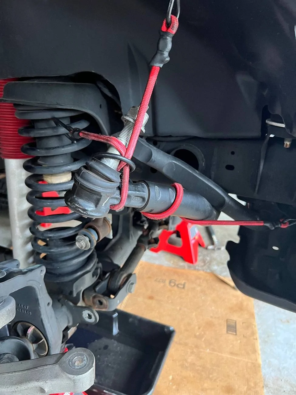

NEED HELP!!! Fing Stock Drag link won’t come off at Pitman arm!!! Using Fork and used heat and penetrating fluid:

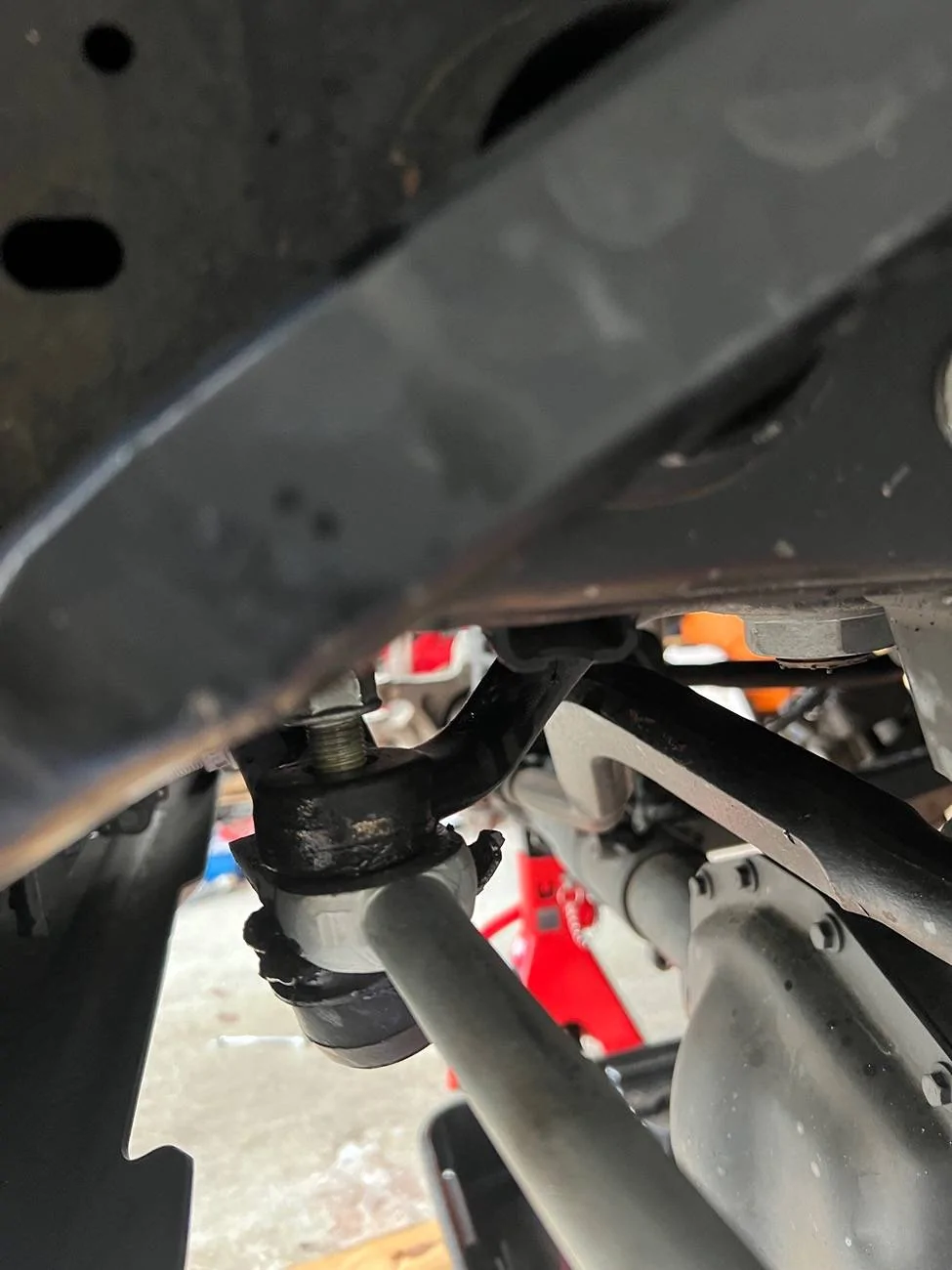

Even have other end up high:

Just keep after it, take the fork out and go in from several different directions, sometimes if you just go at it from the same place you can make it tighter because it kinda wedges it

not working 😭

You may have enlist an extra pair of hands, one working the fork, and one smacking the side of pitman, drowwn it PB let it sit a bit, sometimes it takes some doing…..
Drenching it in PB…unfortunately no other hand as my 14 yr old son is Autistic

Just ordered a pitman arm puller that will come tomorrow morning by 8am…will see if I can make something work or at least get it done today

Pulling the pitman arm off the steering box is a good move. Beating on the pitman arm while it's on the steering box transmits each hit into the bearings and gears of the steering box.
Once it's off the box, putting the outside diameter on an anvil and striking the opposite side with a big steel hammer, will elastically deform the tapered hole slightly and break the taper loose from the stud.

Unfortunately I do not have a socket that big

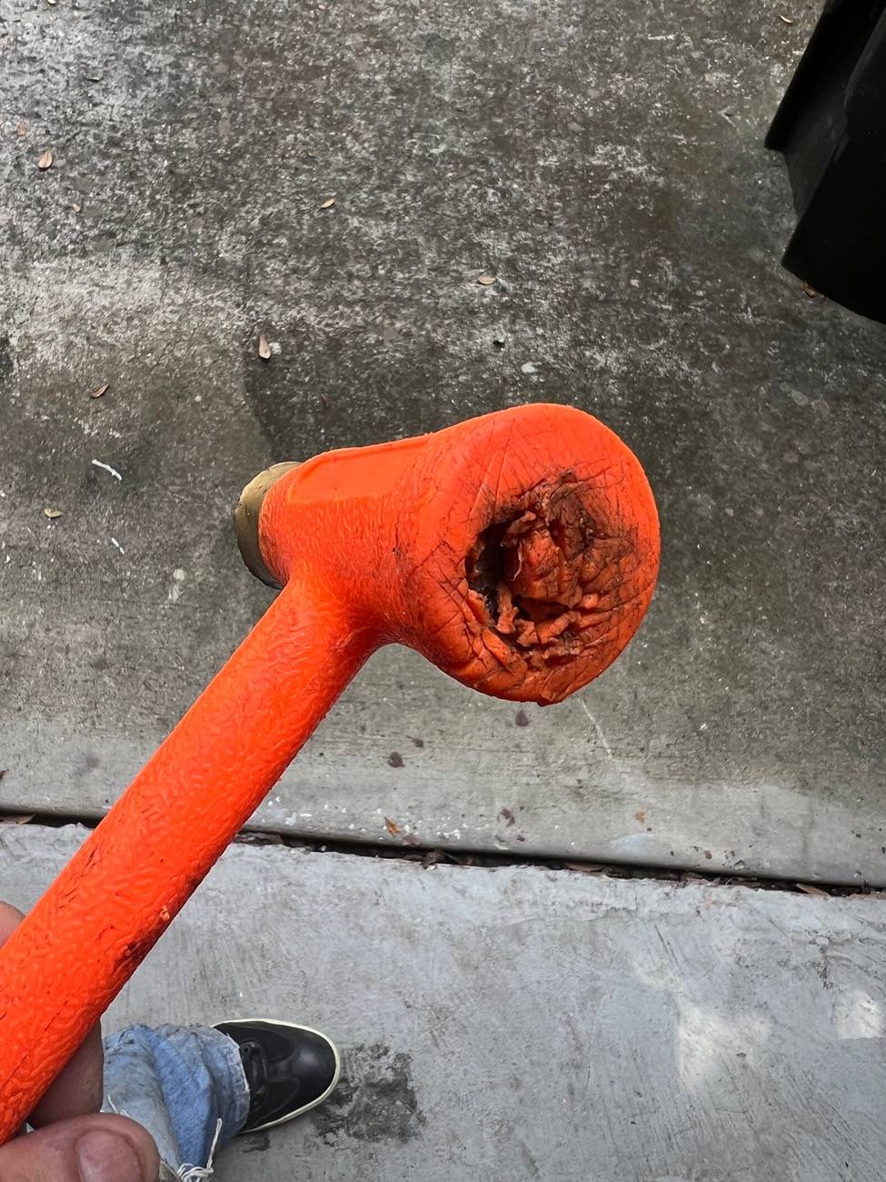

Any trick to get these off?
Jeep Wrangler JL Steering Upgrades when going to 37s? IMG_0323
Banging the shit out of them and used A LOT of PB
I new weighted mallets coming in the morning as well
