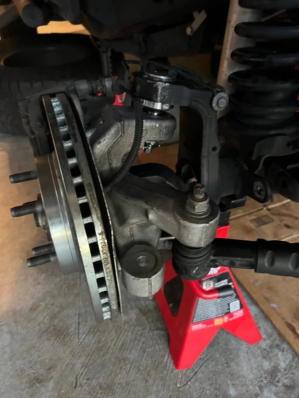

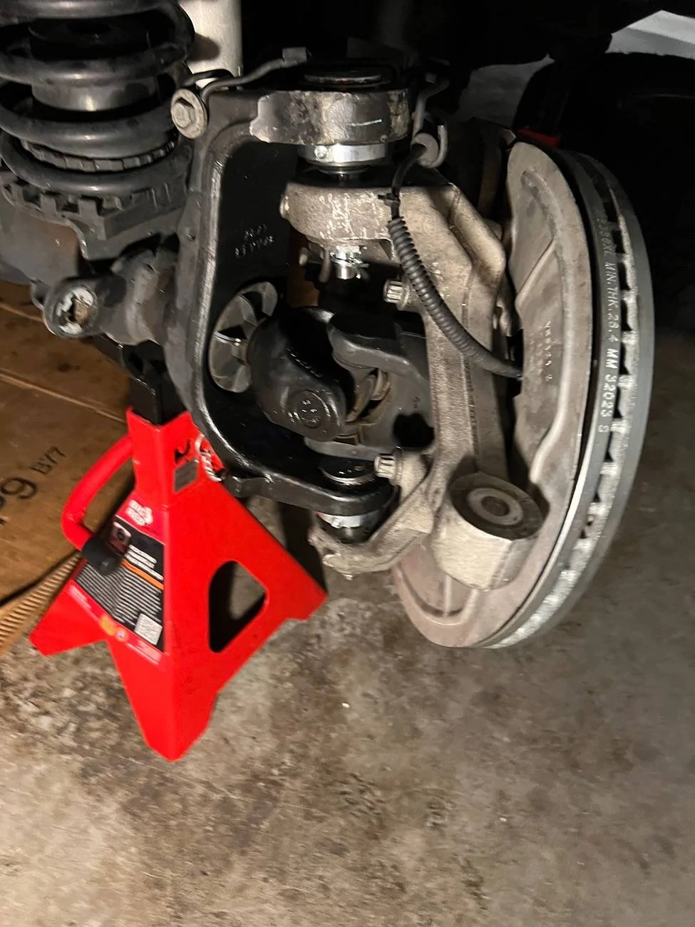

Tomorrow is Flush coolant till just water and then replace Coolant Tank, Water Pump, Pulleys and Serpentine belt and then close out with the new Steer Smart Tie Rod and Drang Link until the Stabalizer part comes in 😇

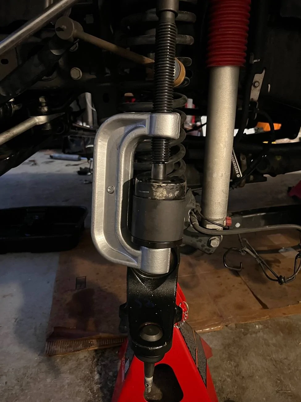

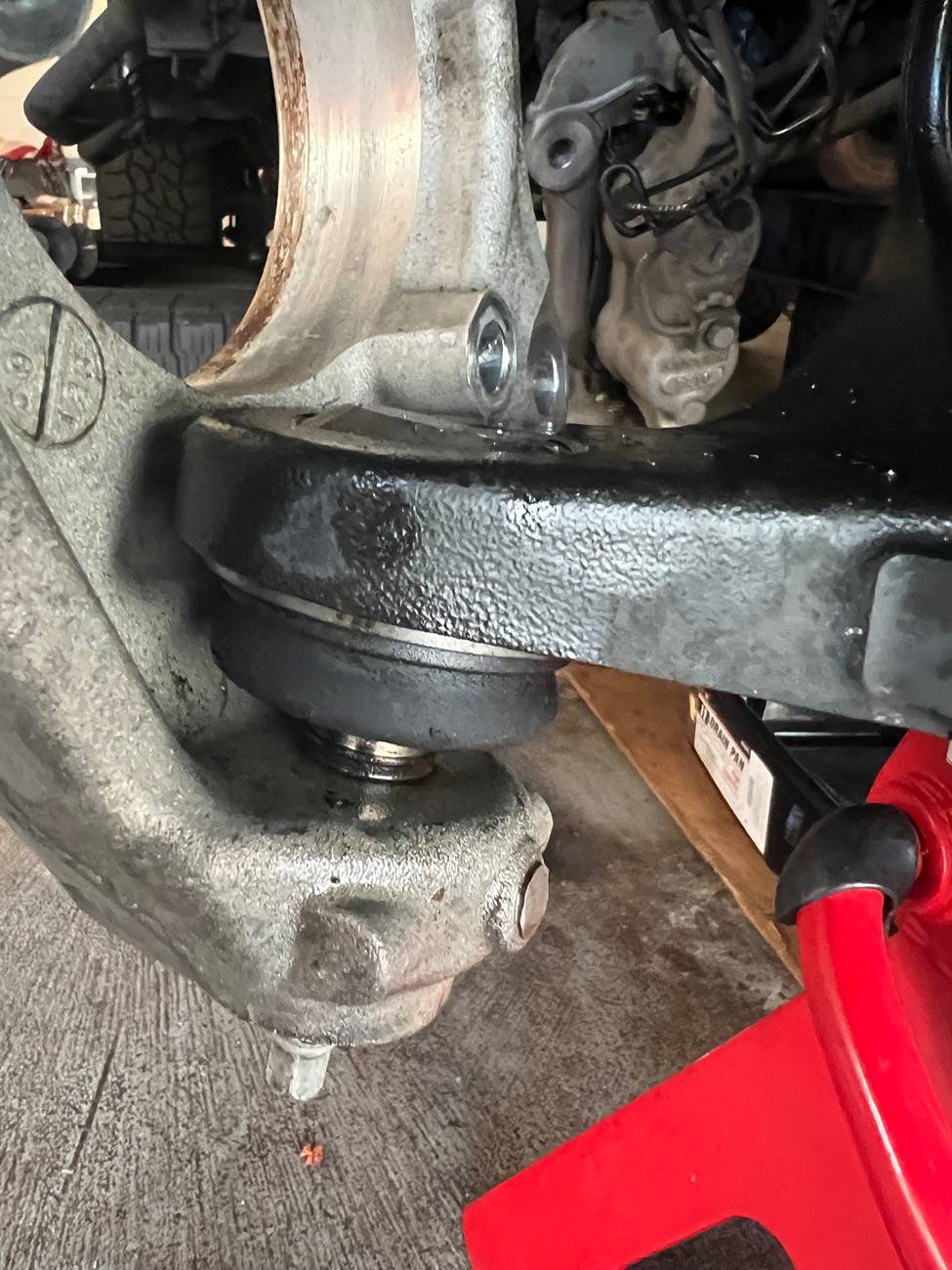

OH and @Roky, you will appreciate this “WTF”… the LAST Dynatrac Ball Joint to press in and the inside of the screwing press falls out…the ball bearing goes flying and rolling away…the press fell apart 😲
Luckily I had to make sure I put pressure on that pivoting end rod that went inside the threaded rod while positioning everything to press in the last Ball Joint…I was like, “Are you Fing kidding me!!!!” LOL
