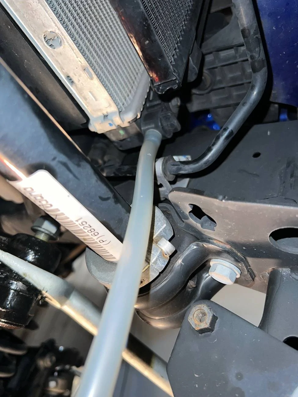

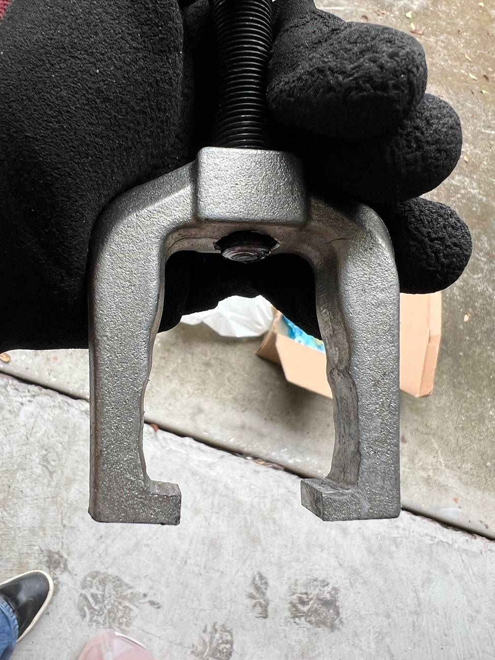

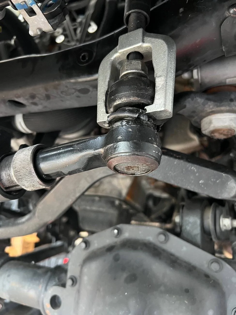

FINALLY got the drag link out of the pitman arm!!!
Wasted about 2 hours and had to modify the pitman arm puller (not wide enough to clear the outside of the pitman arm):
Jeep Wrangler JL Steering Upgrades when going to 37s? IMG_0370
Jeep Wrangler JL Steering Upgrades when going to 37s? IMG_0369
Was easier to access the pitman arm when I turned the steering wheel AND had the radiator fan out.

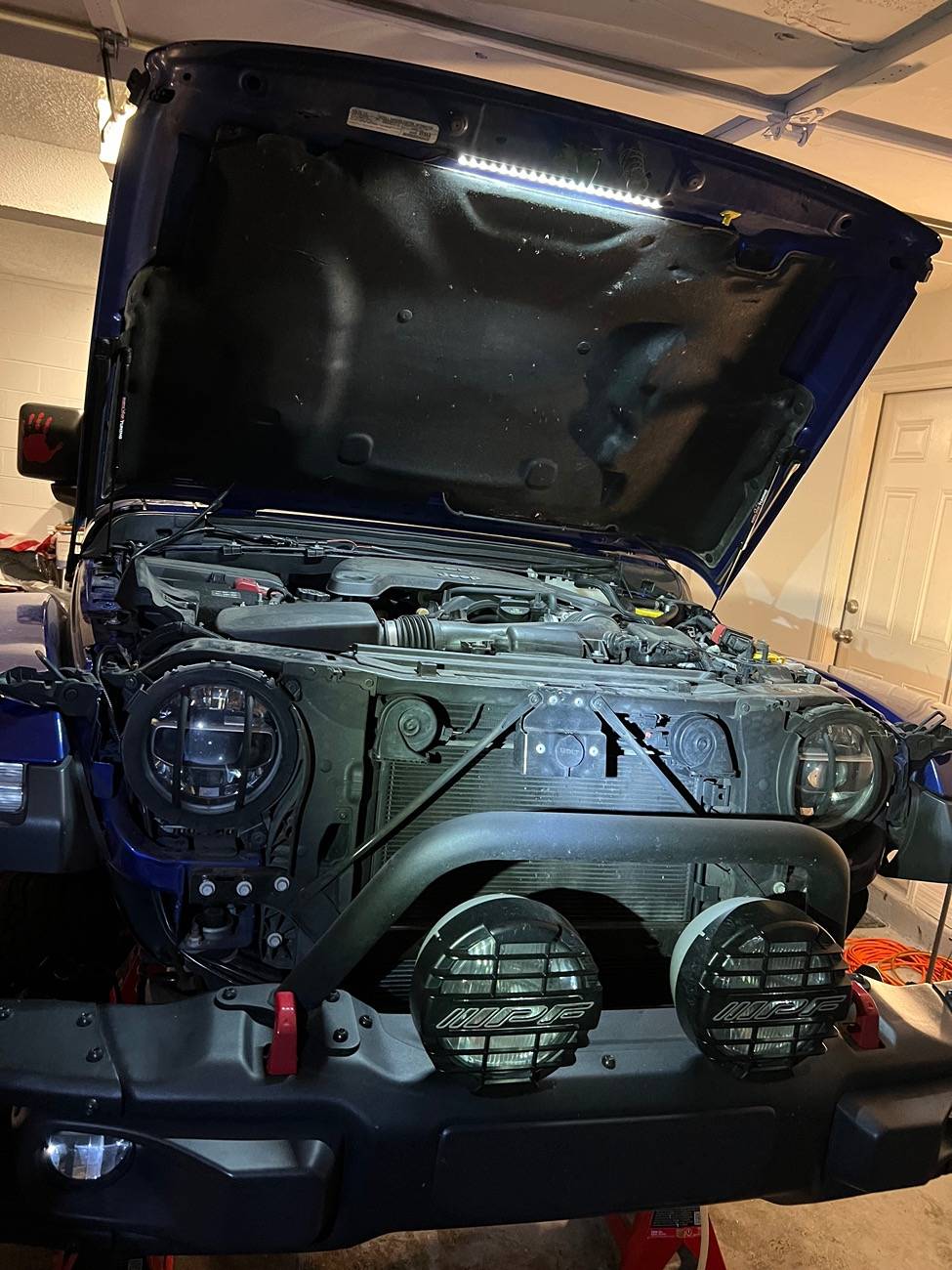

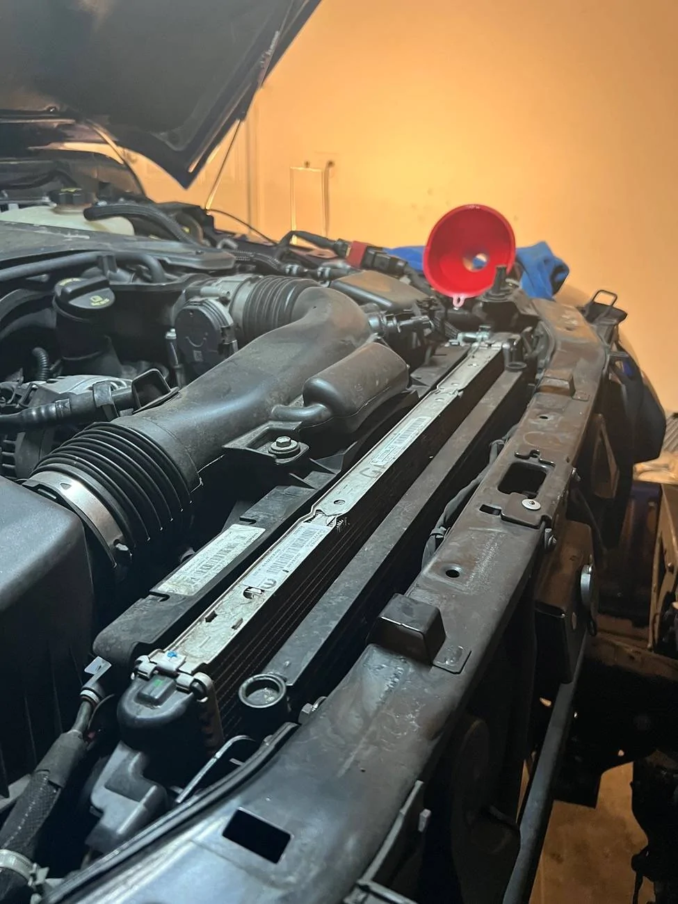

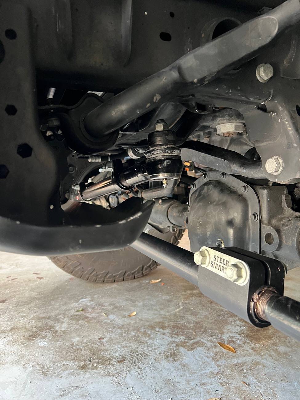

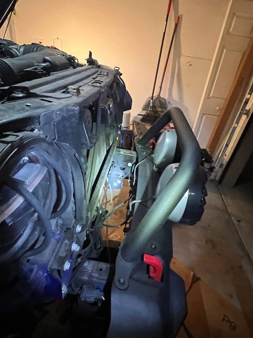

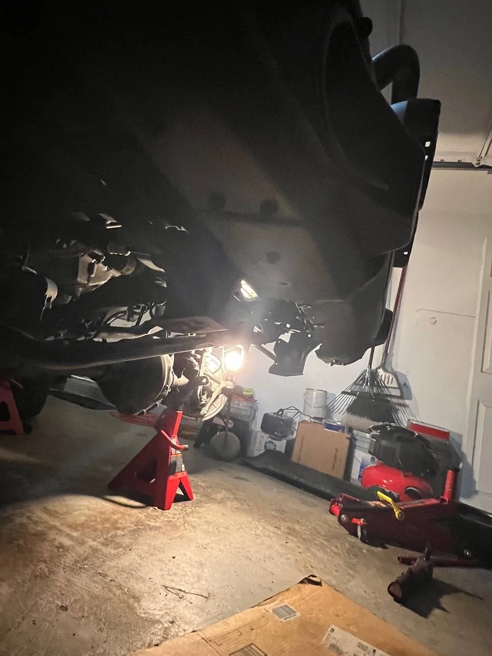

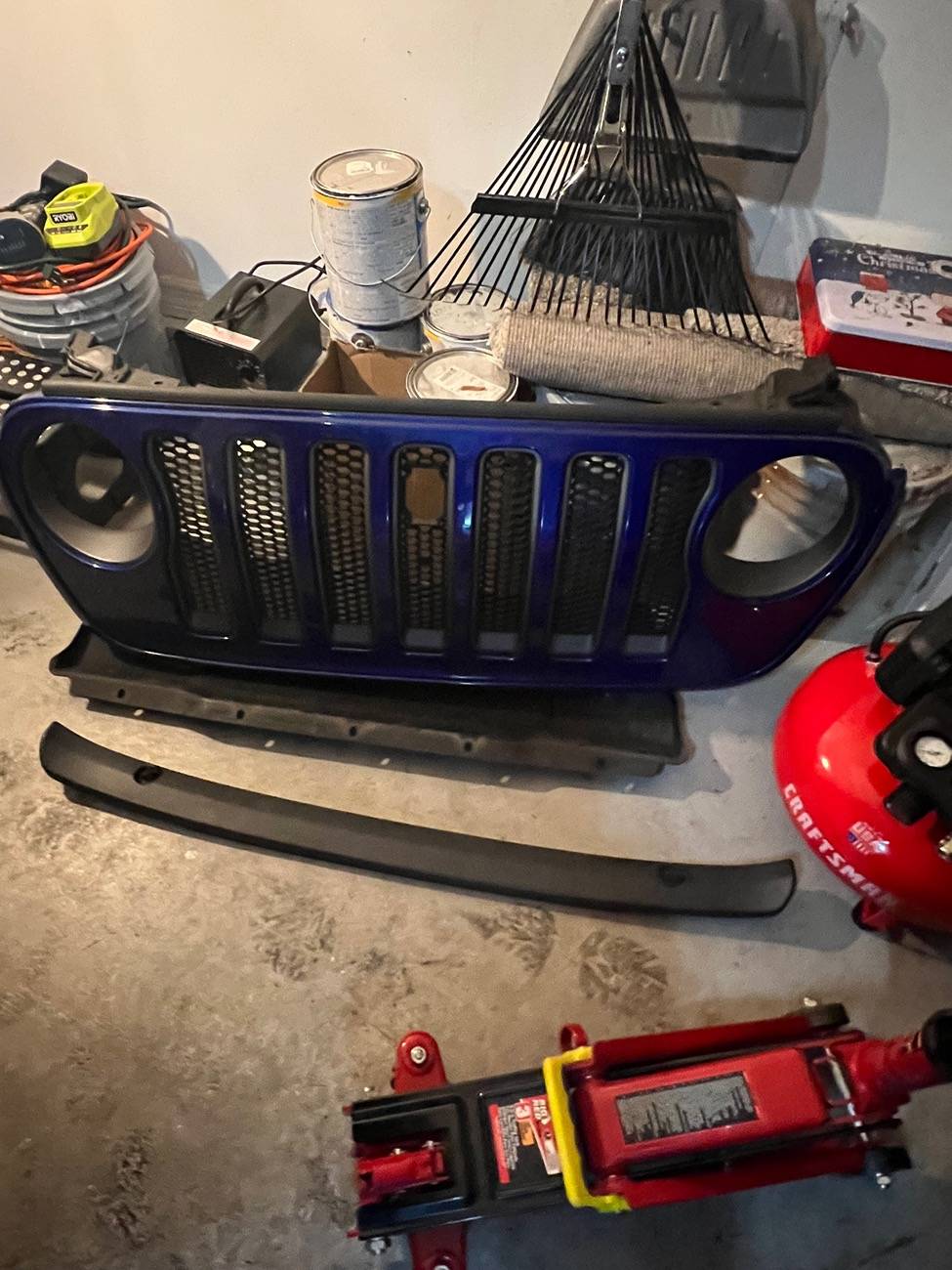

Day 3 DONE!!!
Put fan and air box back in…filled coolant.
Steer Smart Tie Rod And Drag Link in.
Jeep Wrangler JL Steering Upgrades when going to 37s? IMG_0378
Jeep Wrangler JL Steering Upgrades when going to 37s? IMG_0379

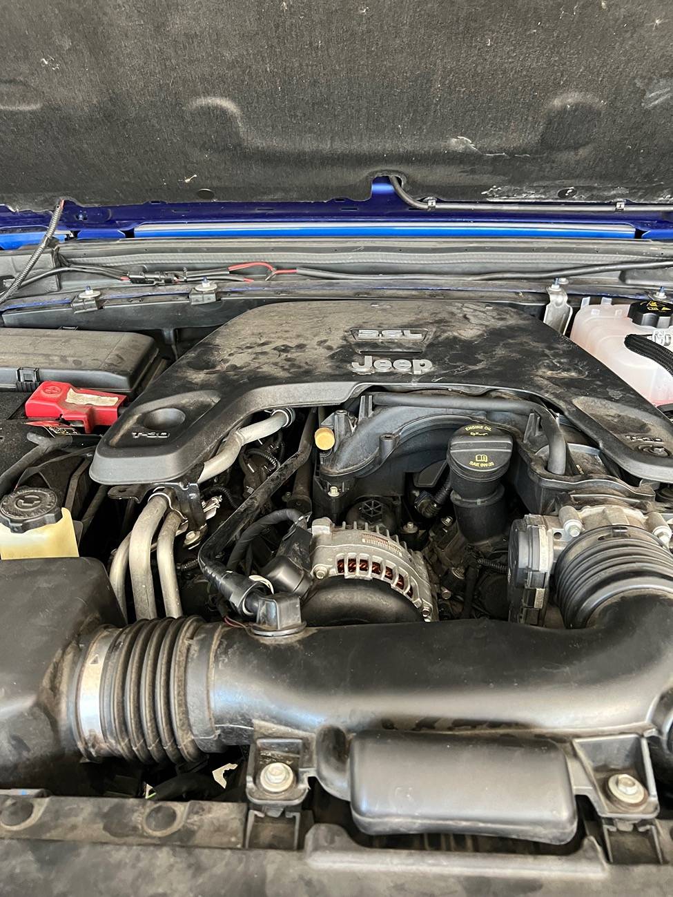

Also forgot, I installed the new Coolant overflow tank, which wasn't bad. ALL the videos I found on this replacement was for the JK or the only JLUR was some guy who fudged the removal.
So tip to hose doing the Coolant Tank replacement on a 2019+ JL 3.6L
Undo the 2 tank bracket nuts on the upper part of the bracket. Then start trying to lift the bracket & tank together (you will get resistance). I took my long hand pry bar and got underneath the center of the underside (directly below those 2 stud locations as it is just a rubber part that pops in a hole (similar to the bottom of the Air Intake box). Once popped out, the rest is easy peasy... 10mm screw out bottom of tank, with a screw driver unto bottom Coolant tank connector. Put new tank in and just reverse the process.

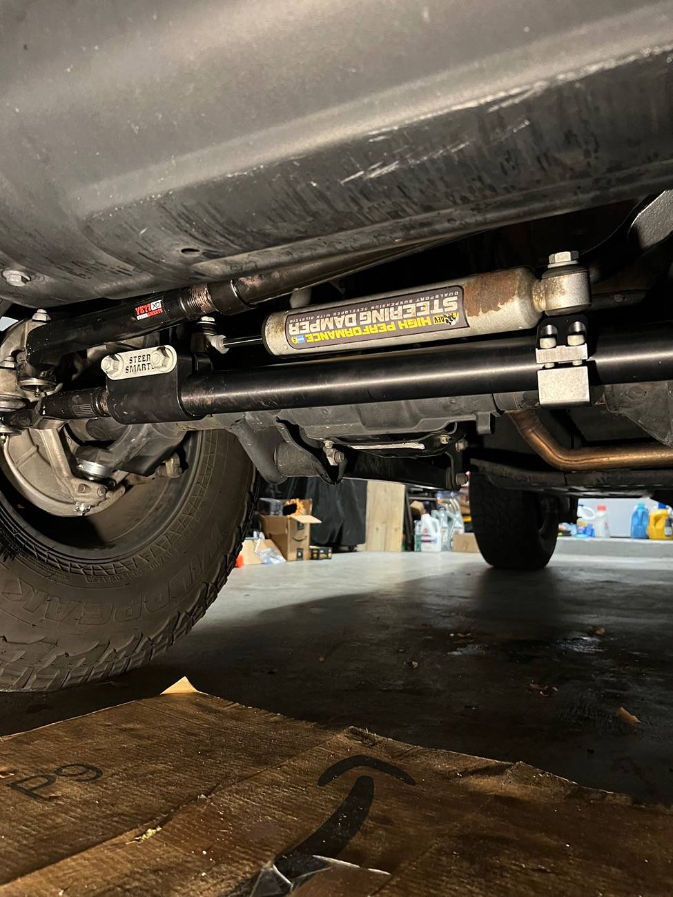

FINALLY ALL DONE…Steer Smart Steering Stabalizer mounting bracket came in….
Jeep Wrangler JL Steering Upgrades when going to 37s? IMG_0394
I read the whole debate about keeping the steering Stabalizer off or putting it back on…
MY opinion….keep it ON….I can tell you after driving without it for 2 days and now just test driving it right after putting it on…world of difference.
With it off, you felt EVERYTHING through the steering wheel. Also I felt I needed to get a real alignment as it would veer slightly when I would let go of the steering wheel.
With it ON, you feel comfortable and feel what you need to through the steering wheel. Also, I let go of the steering wheel and it drove straight as an arrow (yay me for self alignment 🤗🤗🤗)
