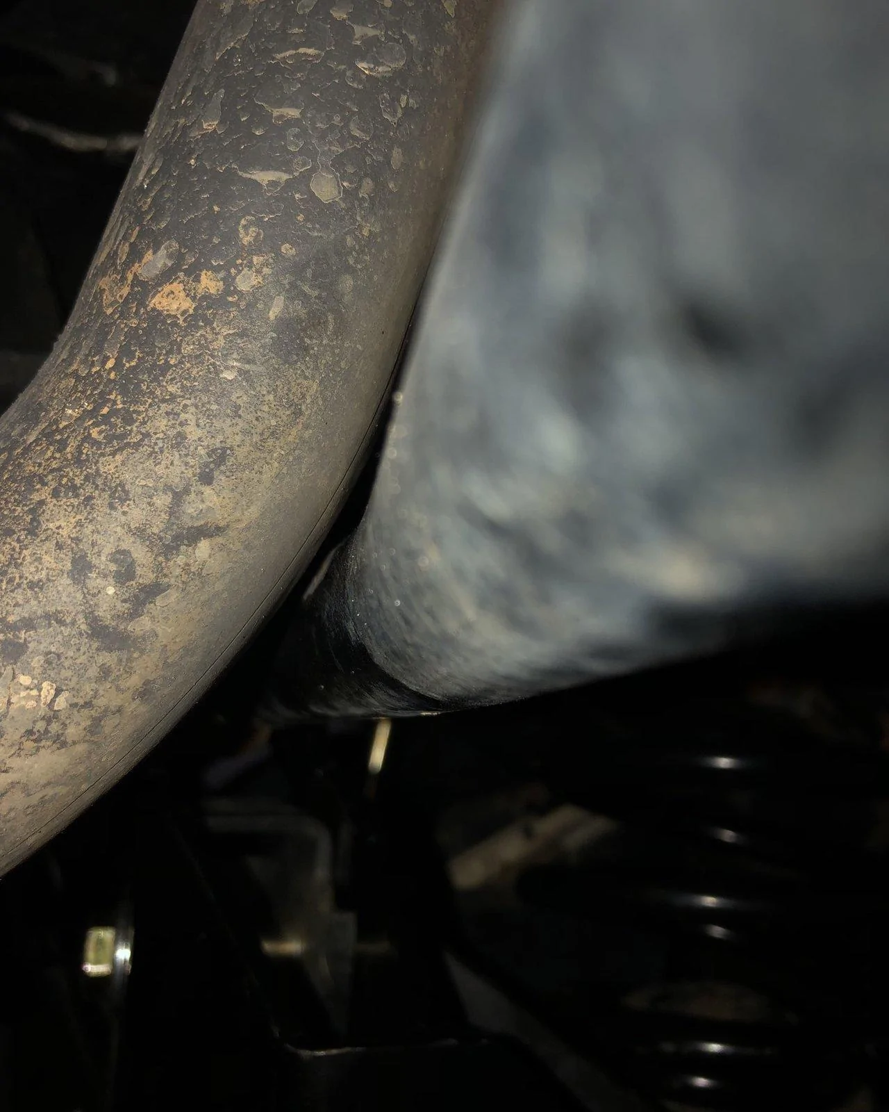

Speaking of that... do you have the bracket on your rig? I know you’re running rk. Mine is making the track bar hit the exhaust. How is yours, is it clearing? I got maybe a 1/4” now. My pinion angle was off so I rotated it down to better align it, that helped some, but was wondering how yours is. I contacted another member on the subject and when he checked, it had been rubbing as well.
Thanks

I have the RK kit with bracket and track bar but I'm not running the factory exhaust. Sorry I'm no help.
