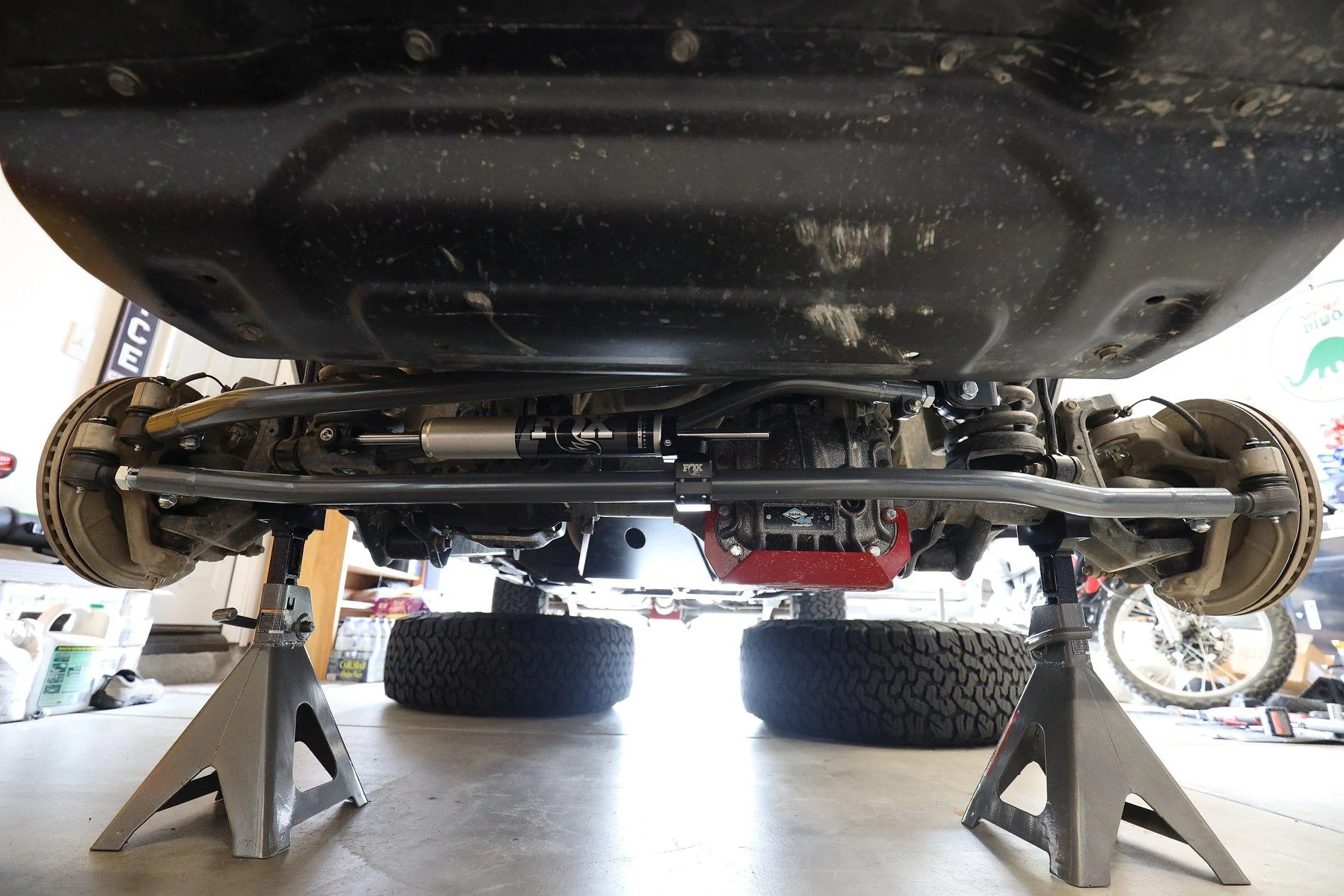

Did you use the Synergy stud on the axle side and the fox clamp on the tie rod side?
Here's what mine looks like.
So I had the Synergy stud in with the stock stabilizer. I actually swapped it out for the Fox stud. I wasn't sure if that was where some of my problems were coming from. Also, I liked the nut on the end of the fox one better. However, the fox one is harder to torque. Mine looks the same as your now. So far is significantly better. I have a rancho track bar becuase the Synergy one wasn't out yet. I may swap that so all the components play nicely together.
