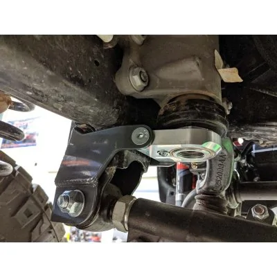

I installed the Falcon Nexus EF 2.2 adjustable Steering Stabilizer and set it to the medium setting. It helps a tad bit with wandering but im looking in getting the Synergy front track bar and sector shaft brace. Check out there videos. Looks like thatll help with the JL wandering all over the freeway.So that's it? Fox and Falcon are the only recommended stabilizers?

The sector shaft brace does more for the wandering steering than any stabilizer does. Honestly i keep telling folks that the cheapest stabilizer you can find is just perfect. The stabilizer does very lil. Also like to note Harmonic Oscillation does not go away if you just let off the accelerator, i can not state often enough that the two are unrelated.I installed the Falcon Nexus EF 2.2 adjustable Steering Stabilizer and set it to the medium setting. It helps a tad bit with wandering but im looking in getting the Synergy front track bar and sector shaft brace. Check out there videos. Looks like thatll help with the JL wandering all over the freeway.
Thanks for the reply jlopes68. So would it be worth it to purchase and install that synergy track bar brace?The sector shaft brace does more for the wandering steering than any stabilizer does. Honestly i keep telling folks that the cheapest stabilizer you can find is just perfect. The stabilizer does very lil. Also like to note Harmonic Oscillation does not go away if you just let off the accelerator, i can not state often enough that the two are unrelated.
I am very pleased with the performance of mine, been on a few weeks now. I would highly recommend it for tightening up the wander.Thanks for the reply jlopes68. So would it be worth it to purchase and install that synergy track bar brace?
awesome. Thank you. Gonna order one. How was the install? Did it yourself?I am very pleased with the performance of mine, been on a few weeks now. I would highly recommend it for tightening up the wander.
install was pretty simple and yes i did it myself.awesome. Thank you. Gonna order one. How was the install? Did it yourself?
