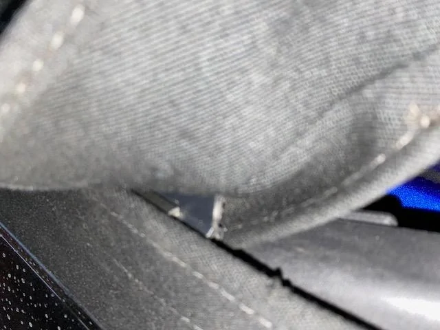

I just got the card in the mail, so I decided to fully inspect my soft top windows which just went on a few days ago. And I think I found a problem. The driver's side window is not seated as well in the top channel. This is the same window that blew out last summer. So the replacement is the one with the issue.
Bad Drivers:
Jeep Wrangler JL Soft Top window blowing out IMG_2181
Good Passengers:
Jeep Wrangler JL Soft Top window blowing out IMG_2176
I had folded the sunder portion back to get these pictures.

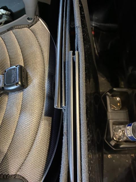

So i pulled both windows out to compare the top channel. You can see the driver's side expands towards the end.

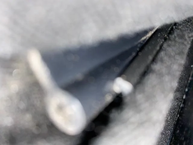

On the highway today and the rear driver side premium soft top window blew out and hit the highway. It was run over of course. Top up and windows down, Speed was 65 I know all the flaps were tucked and the channel threaded properly as it took the tapered tip with it. At least with a zipper it would stay with the Jeep. Anyone else have issues with the window not staying in-place? A full line of Velcro on the top might be better than just the small patch.
