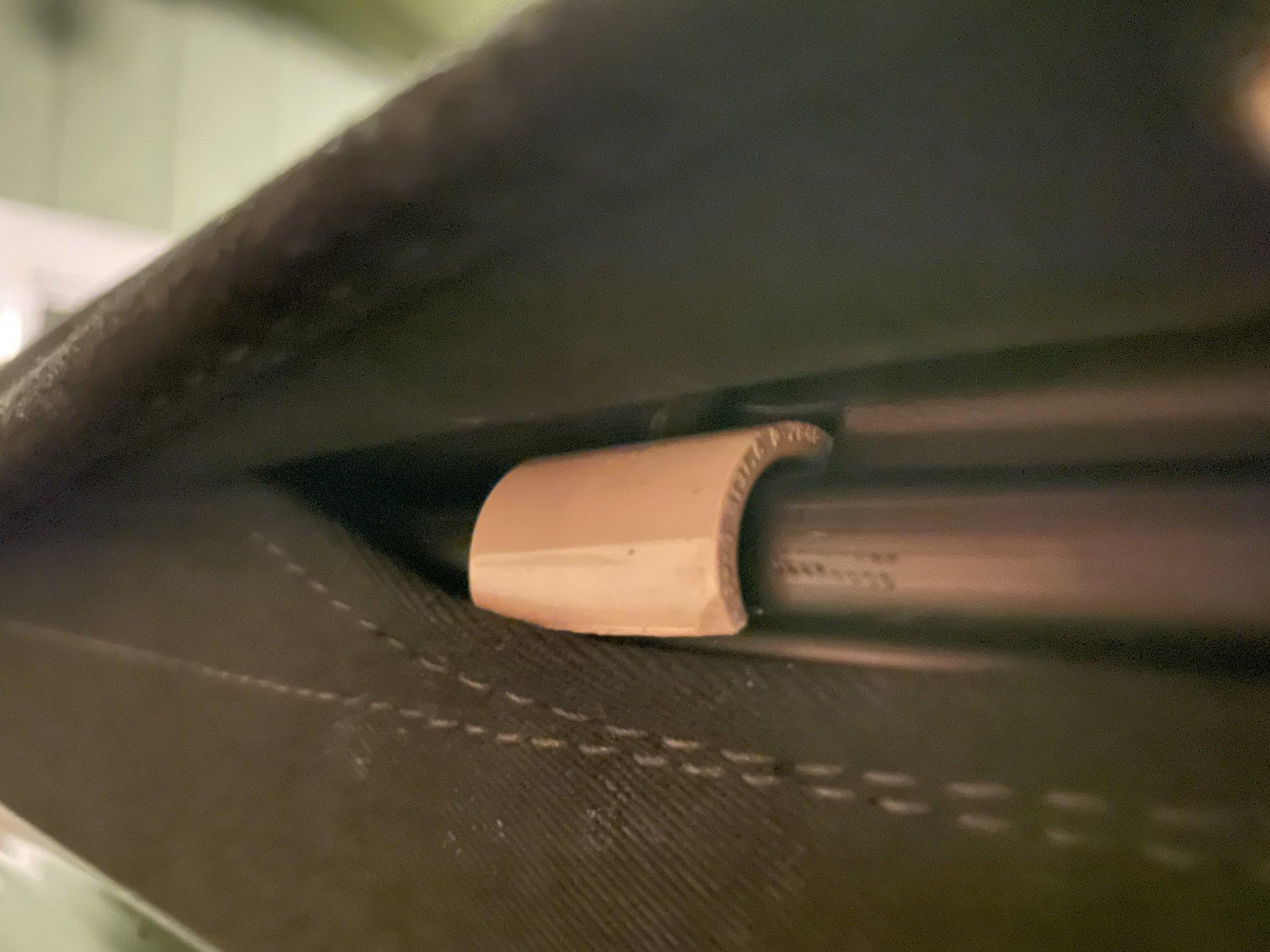

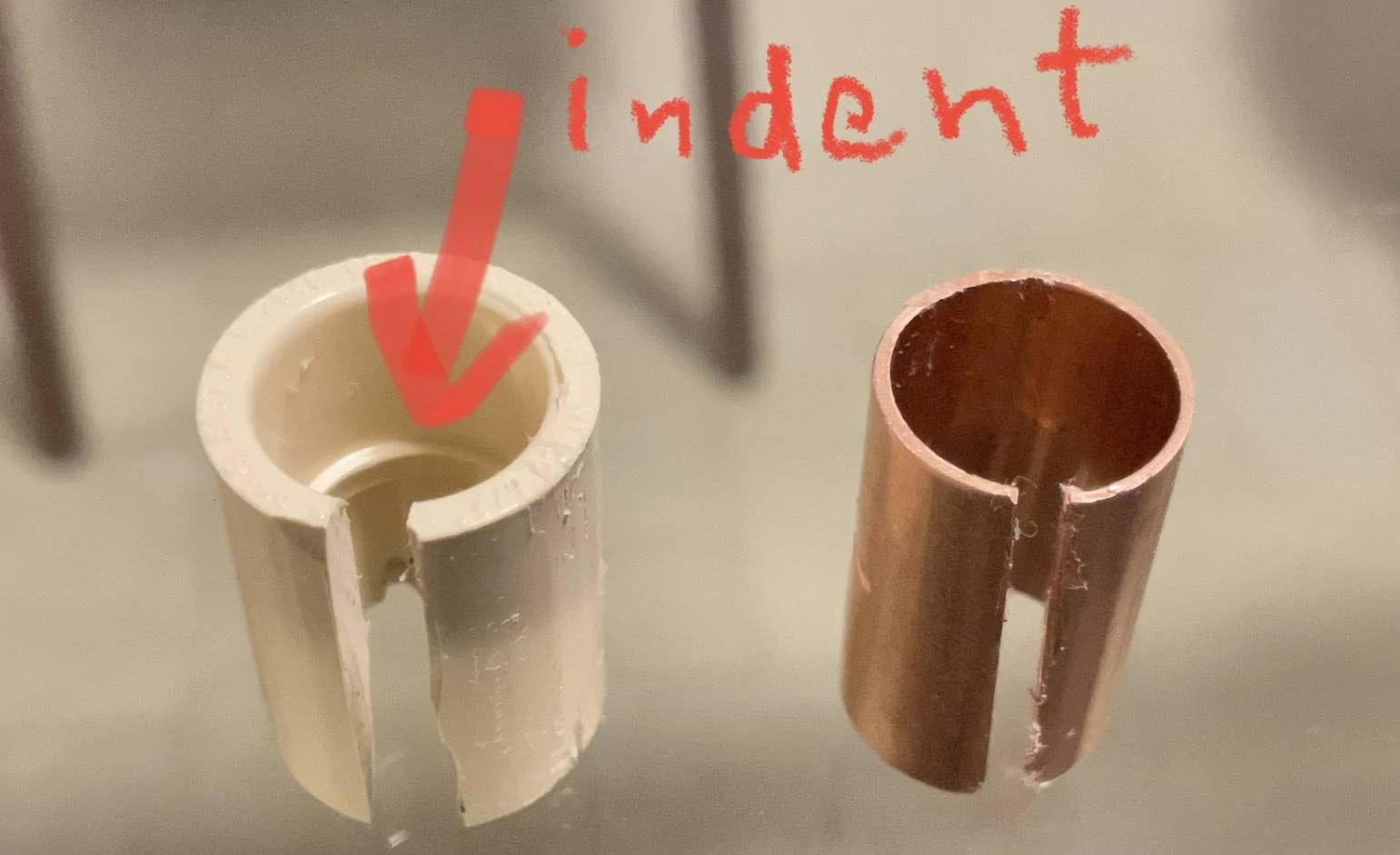

I picked up the same copper part from Home Depot JDJones used. But I saw a similar PVC part so got that too. Both of them together was under $1. Both parts have identical inner diameter. Except the PVC has an indent ring right in the middle which might be an advantage since it hugs even tighter. Cut a slit so it can slide over the 'C' channel of the soft panel.
This shows how the weak 'C' channel gets stretched out after it slips off the rod.
I ended up using the PVC part to wrap around and reinforce it. (The copper part had rougher edges and didn't slide over as easily but I'm sure it would work similar.)
Installed the panel and had the PVC part sit right where the rod ends. Between the panel's 'C' channel and this PVC part, it's completely wrapped around the rod now. The soft top covers over this so you wouldn't see this white piece unless you flip the fabric up.
I'll see if it actually addresses the problem with some time. If this solution works it doesn't actually make the soft top on/off any more difficult. Fingers crossed. :fingerscrossed:

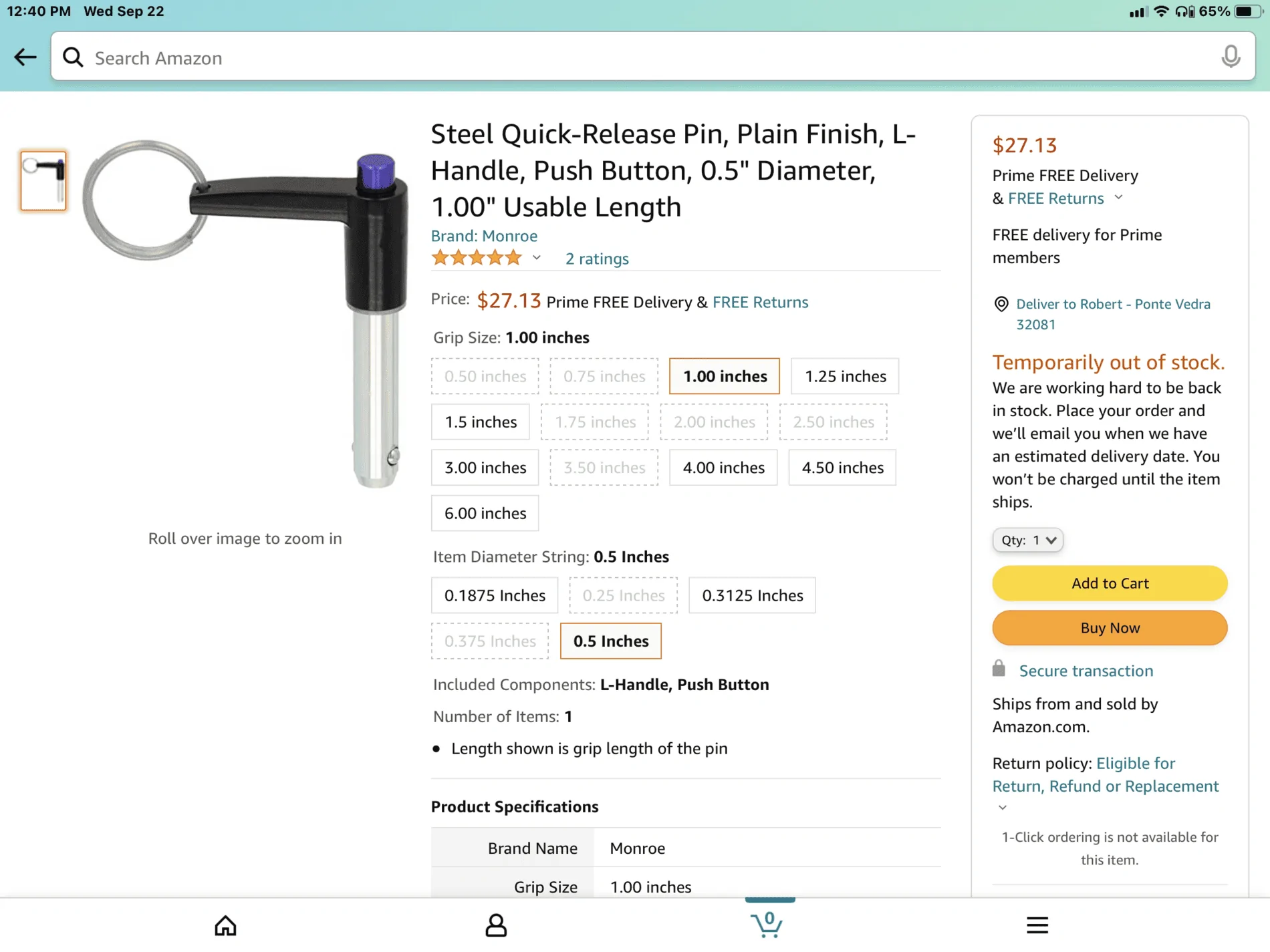

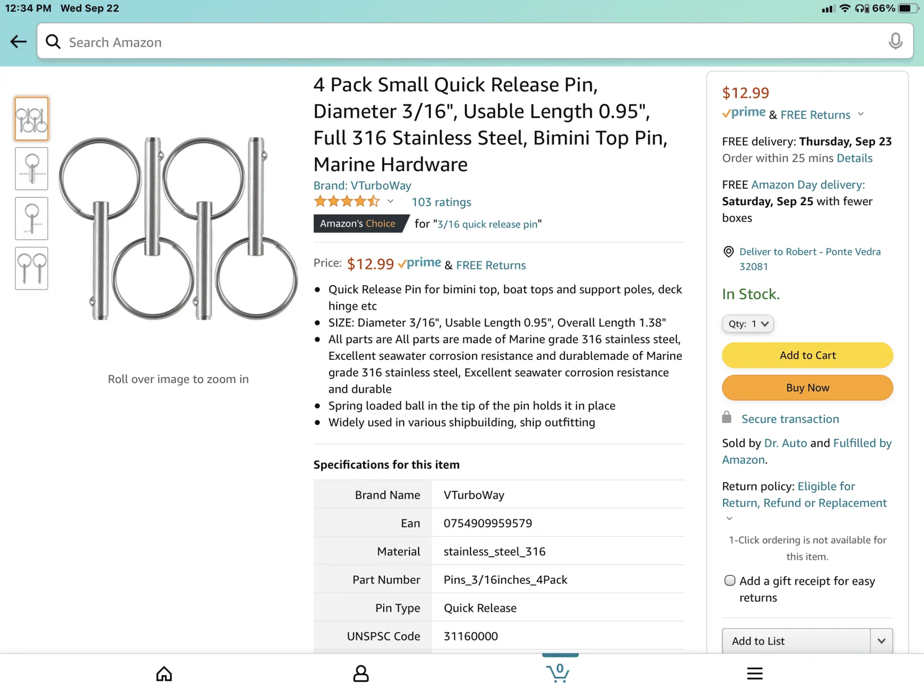

Something like these?
Jeep Wrangler JL Soft Top window blowing out 4ED2EEFD-8572-403D-9783-816CFAE64763

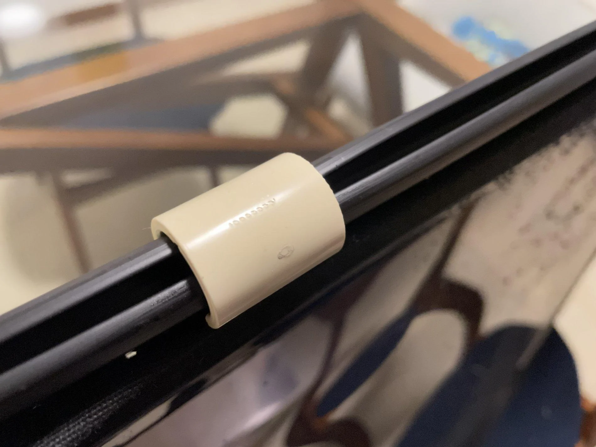

Here is my fix for the issue if it could help someone out. It has held the window in place for over 300 miles of highway speed, with both front windows rolled down. It may be a permanent solution for me until I can conjure up something nicer.
1) Buy a 54 cents 1/2" copper coupling.
https://www.homedepot.com/p/Everbil...Coupling-Fitting-with-Stop-C600HD12/100342365
2) Saw down the length to turn it into a "C" clamp of sort
3) Slip it onto the plastic track flange on the window panel
4) Install the window
5) slide the coupling up to the lolly pop awning rail
Been monitoring this thread since I purchased my JL last Spring, and like your solution. I also noticed the metal snap fastener in your first photo, which I assume you installed, and was curious if that had any effect on securing the window as well.
