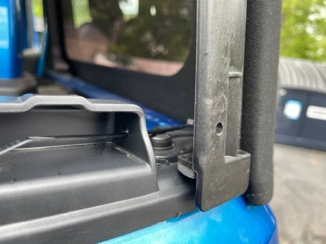

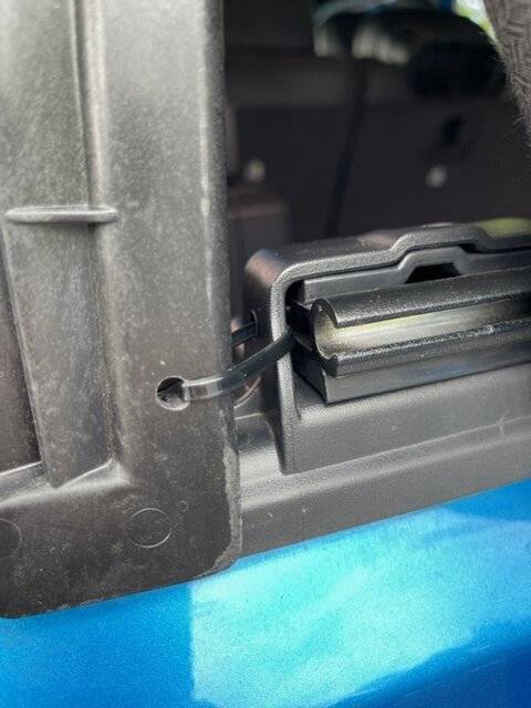

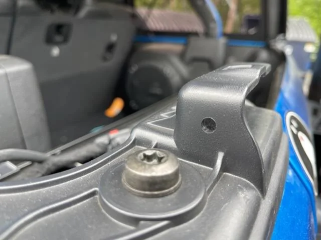

I put a hole in the tailgate retainer and another in the window at the bottom and zip tied them together. I always have cutters or scissors and I have a bag of 4" zip ties.
Great idea! I wonder if the removable zip ties work.... I've never actually used them
