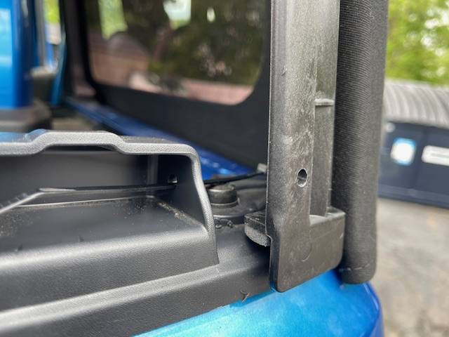

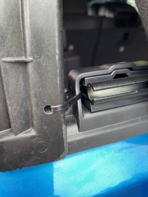

Anyone have a picture of the Zip tie fix? I think I understand it but a visual would be great.
I leave for Windrock next week and don't need another flying window incident.
Thank you!

Years back the proposed solution here was to drill a hole where the tab fits and put something like a hard metal trailer hitch pin to keep it in place. Nope, even under tension those fall out over time.
The zip tie solution is way much better. Easy to keep a bag in the back hatch with some dykes to snip off.

I haven’t lost one since I did it. I got the idea from her Trek Top Ultra where Bestop installed a strap on the side windows that had a snap to attach it to the tailgate retainer.

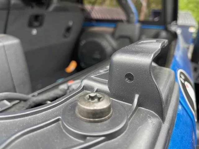

I’m going to do the zip tie but a cotter pin might work just fine.
Edit: nevermind, went out of the Jeep and the angle would be a bit much.
What angle are you referring to?
