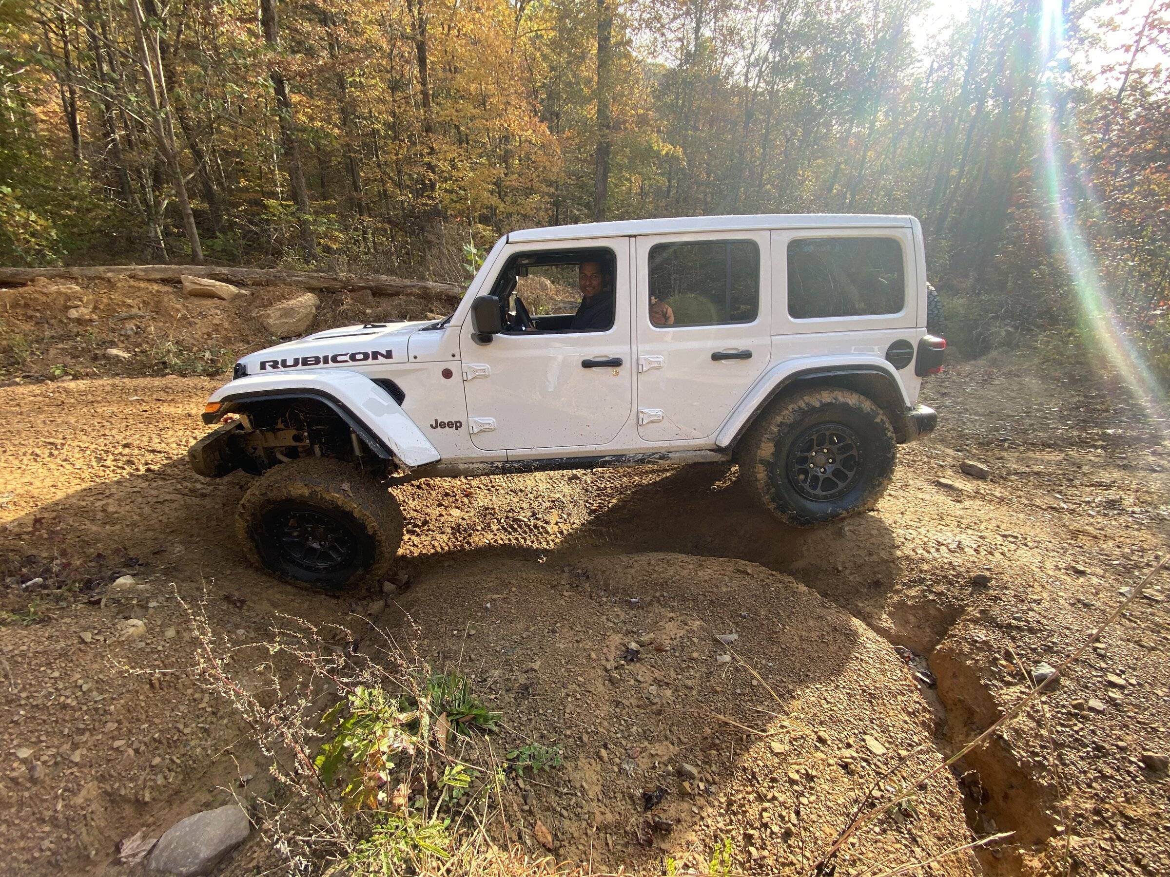

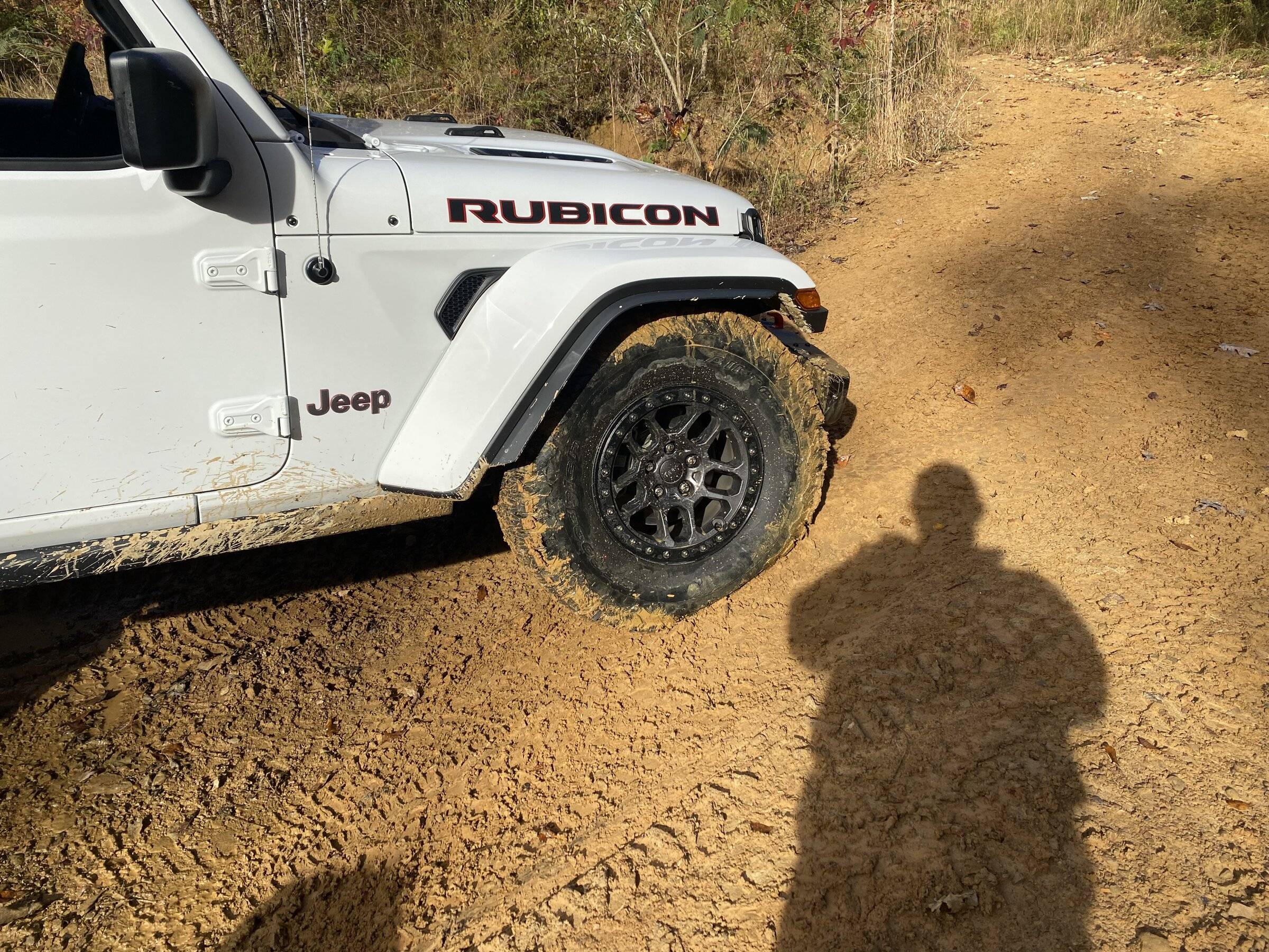

I have an XR that I upgraded to Fox 2.0 shocks. I ordered the one for 0-1.5” lift and it worked perfectly. Full stuff still has a little more room for the shock, and under full droop it allows for a little more travel without maxing out any brake lines etc.
