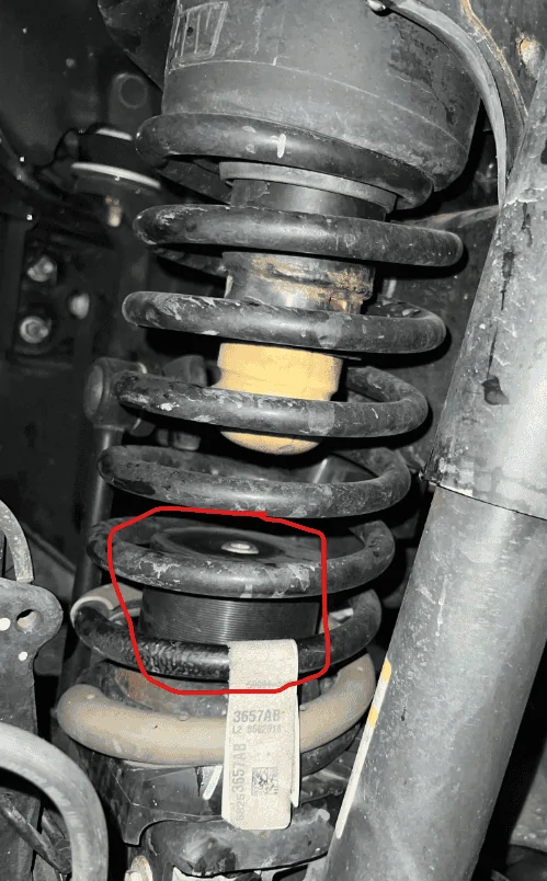

if i only knew what a bump extension is….
This thing inside your spring that looks like an extra thick hockey puck with a bolt vertically through the center of it. Its what allows you to run a larger tire without rubbing the fenders when flexed.

ahh! wouldn’t have even dawned on me to remove that as i am not doing anything with the springs.
