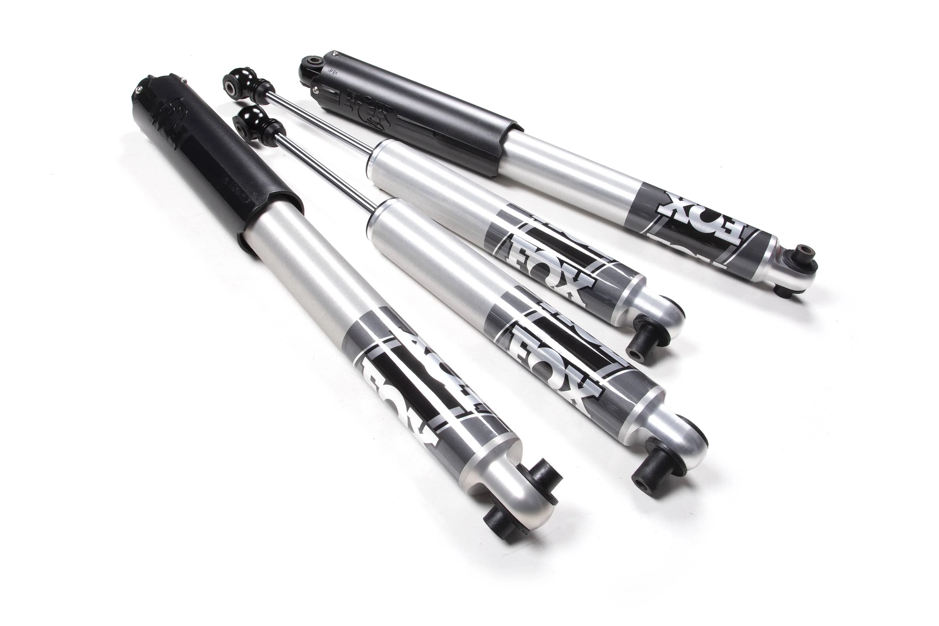

FOX just released a Performance Series 2.5" monotube shock for JL's.
Consistent and fade-resistant performance due to high-quality materials: 2.5-inch aluminum bodies and race-developed main piston with a true internal floating piston (IFP) to separate gas and oil. The 2.5-inch piston offers a greater force capability by moving more fluid and increasing damping and is less prone to cavitation.
The larger diameter valve assembly improves comfort through a wider dynamic range. This allows for a supple feel as velocity increases when transitioning from crawling to fast trail driving:
  • Tuned specifically for optimum ride and performance on larger plus-size wheel and tire packages.
  • The same high-quality aluminum bodies and internal floating piston architecture used in our Performance Series 2.0 shocks.
  • New 2.5-inch diameter shocks have more surface area and increase oil capacity of the shock, allowing for more heat dissipation.
  • Larger diameter valve shims translate to smoother feel: think firmness without harshness, allowing for a softer tune.
  • 50% more piston surface area provides less damping fade and more bottom-out control at higher speeds.

If you are after the best ride, we can get you a set of tuned Fox 2.0 remote reservoir shocks. We would change the valving specific to your Jeeps weight and driving preference. They would not have generic off the shelf valving. These would also be rebuildable later on when the time comes and can be done my most shops. IFP shocks, not so much. You would be looking at about $1500 for all 4 shocks. Tuning and shipping is free
