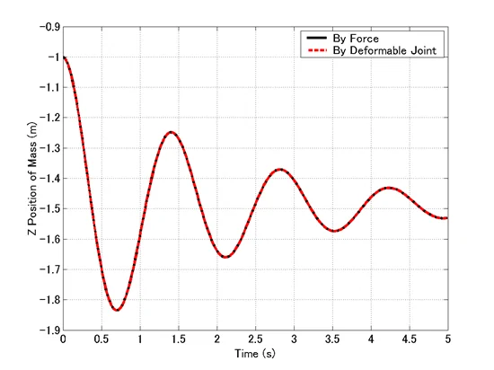

That just shows min/max forces. A completely undamped spring (no shocks) would show the same.
I'm not saying there isn't an improvement with the new shocks, but time is a factor when discussing ride quality.
Undamped:
Damped:
Sure, but note that the extrema of the damped profile are smaller in magnitude -- there's progressively less acceleration at each direction change, which means the magnitude of the accelerometer readings will be lower, which will be reflected in the data. Furthermore, the shocks are operating the whole time, including the initial deflection as well as the follow-on oscillations, so no, even the max acceleration for the profile would also be lower for the damped situation than the undamped. The shocks are working the whole time to resist acceleration including during the initial "bump."
In the last plot, y-axis is displacement, and acceleration is proportional to force, so compare the 2nd derivatives of the "overdamped" vs "undamped" profiles and it's clear the overdamped situation will experience far less acceleration for the same initial displacement.
I think this might be the opposite. Overdamped taken to an extreme would mean zero suspension movement. I expect this to have the highest possible acceleration reading when hitting a bump.
Hmm, yes this is true -- it's the movement of the vehicle we care about not the suspension. So an ideal suspension would provide 0 damping during the initial deflection and then max damping from there on out as long as the wheel returned to ride height before the next bump to prevent "jacking"), but that's not generally feasible, of course.
So the accelerometer is measuring the initial hit (which will be higher for stiffer shocks) as well as the rocking motions until the oscillations settle (which will be lower for stiffer shocks). So we shouldn't expect monotonic changes in acceleration magnitude with respect to shock stiffness. However, I would contend that mean acceleration magnitude is a decent first-order approximation of "ride comfort" under uncontrolled conditions, so finding the shock stiffness that minimizes that value seems like the optimization problem. Of course, given human physiology and psychology, we can imagine that bigger bumps are perceived to be more annoying than smaller ones, in a supra-linear fashion. So maybe mean squared acceleration magnitude is a better minimization target? Or some exponent between 1 and 2? We'd need to calibrate against reports from human volunteers . . .
