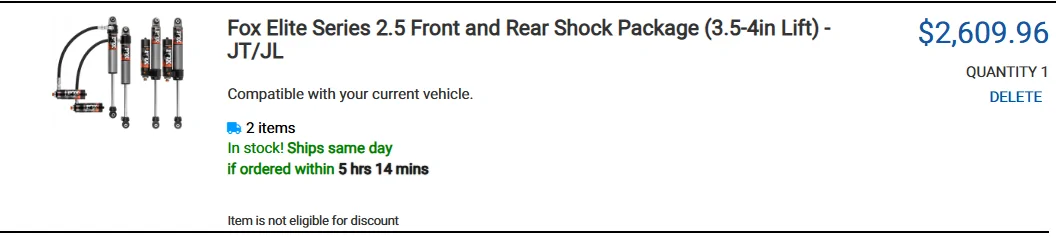

Northridge has a solid deal right now, $2600 for the 3.5-4s:

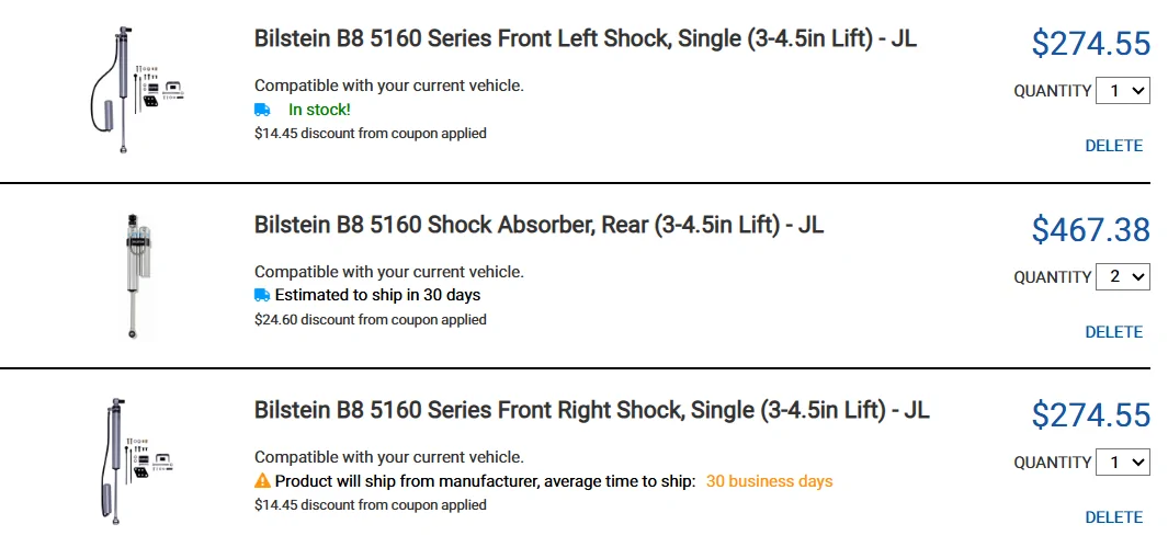

The 5160s I mentioned come in at a grand on NR with Forum discount:
