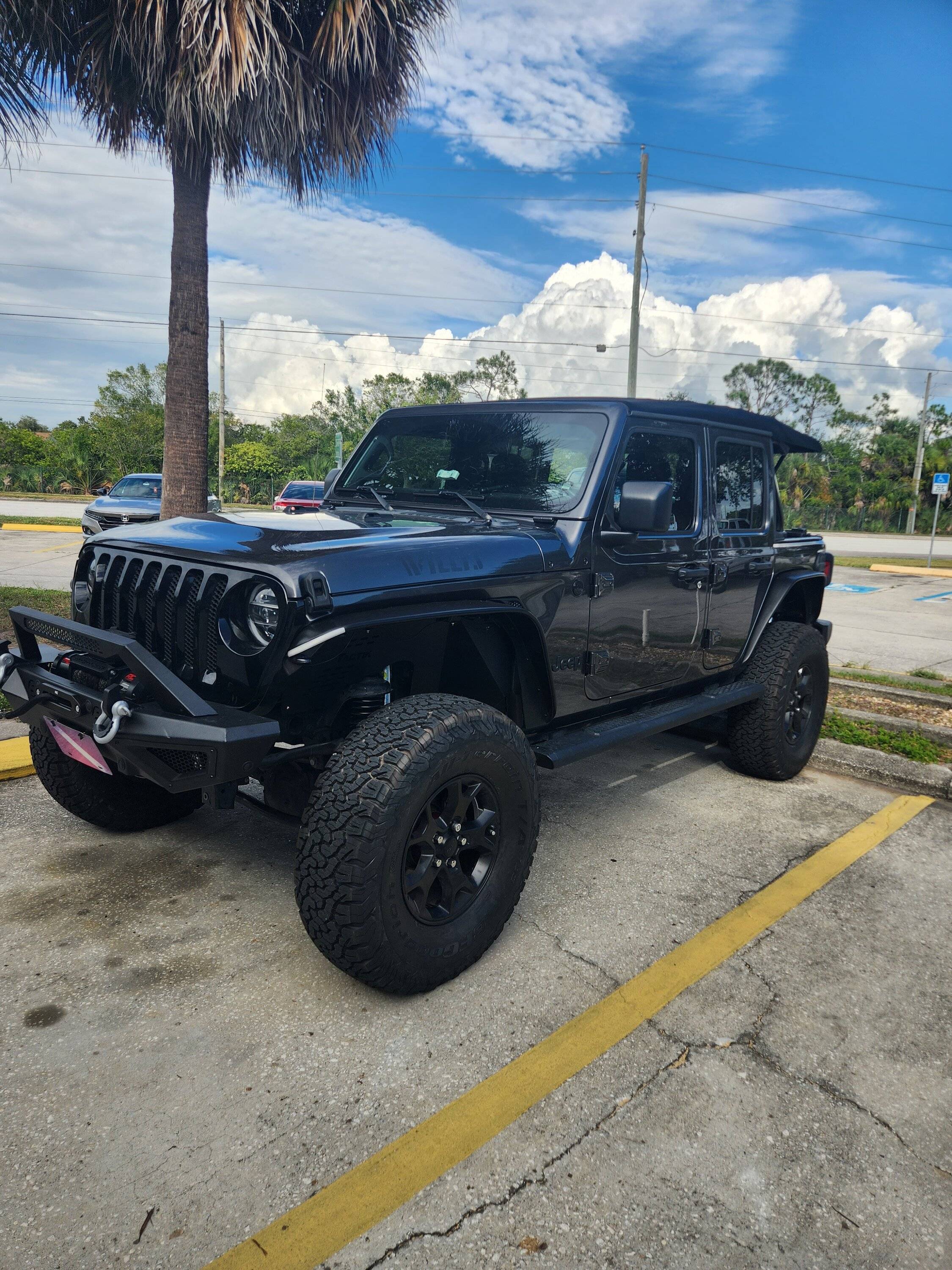

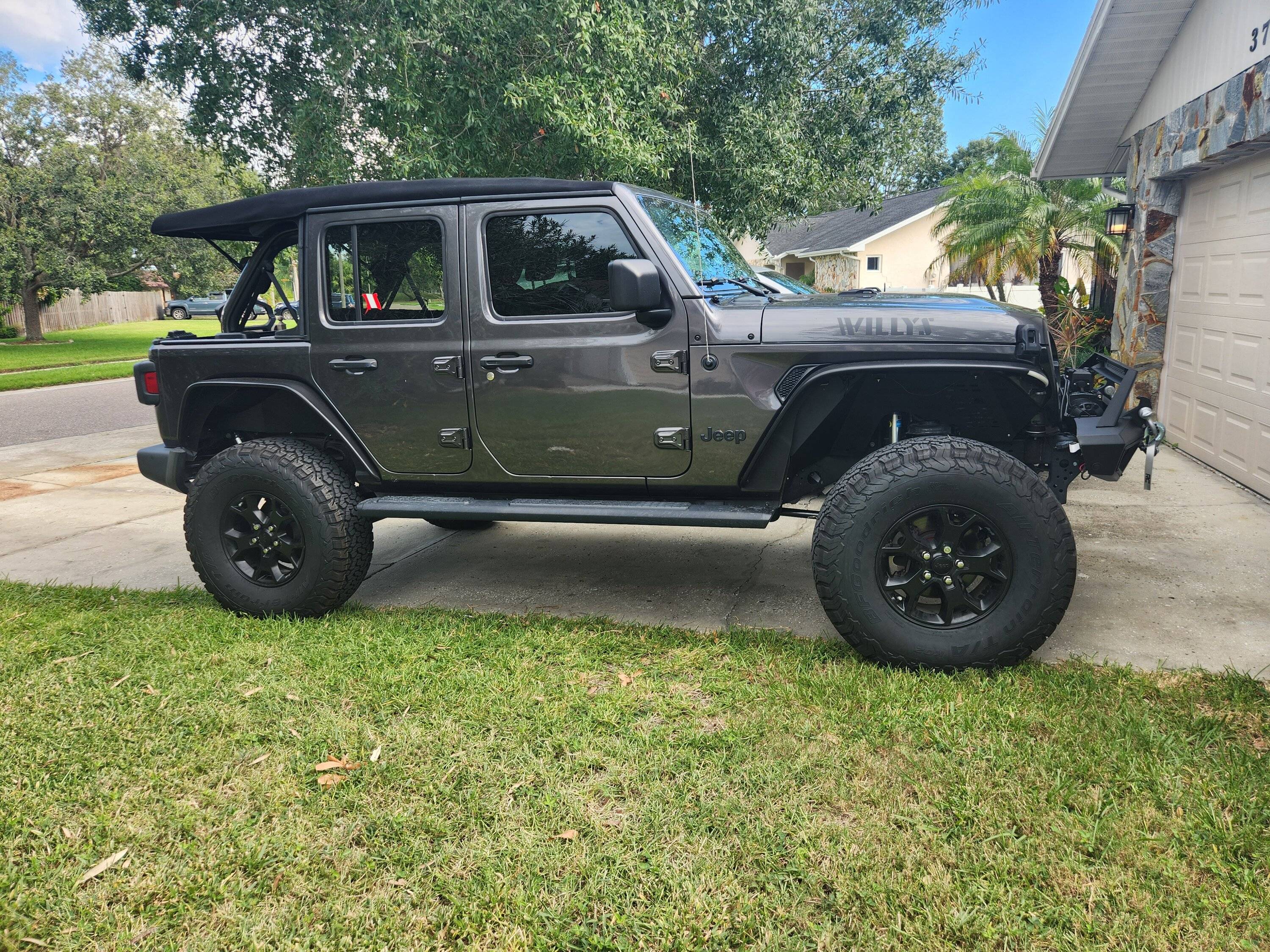

I have 15.5 inches vs the 10 7/8 from the measurements listed for axle to spring capture. This seems more like a 4.5 inch lift. I had 2.5 in my old JK and didn't seem that high. After this one, especially after a Crossfit class, I feel like I am climbing up a mountain. Concerns are drivetrain and making sure I have the shafts updated. I also seem to be rubbing slightly in full turn on the driver side against the front lower arms, but not when turning to the passenger side. I have stock rims but 2.5 inch spacers. A couple of pics of my rig.

Do you seriously have 2.5” wheel spacers??? ?
Anyway, just by looking at your jeep, it looks like it has a 3” lift with 35.5” tires and higher than factory fenders. I don’t see 4.5” of lift there personally.

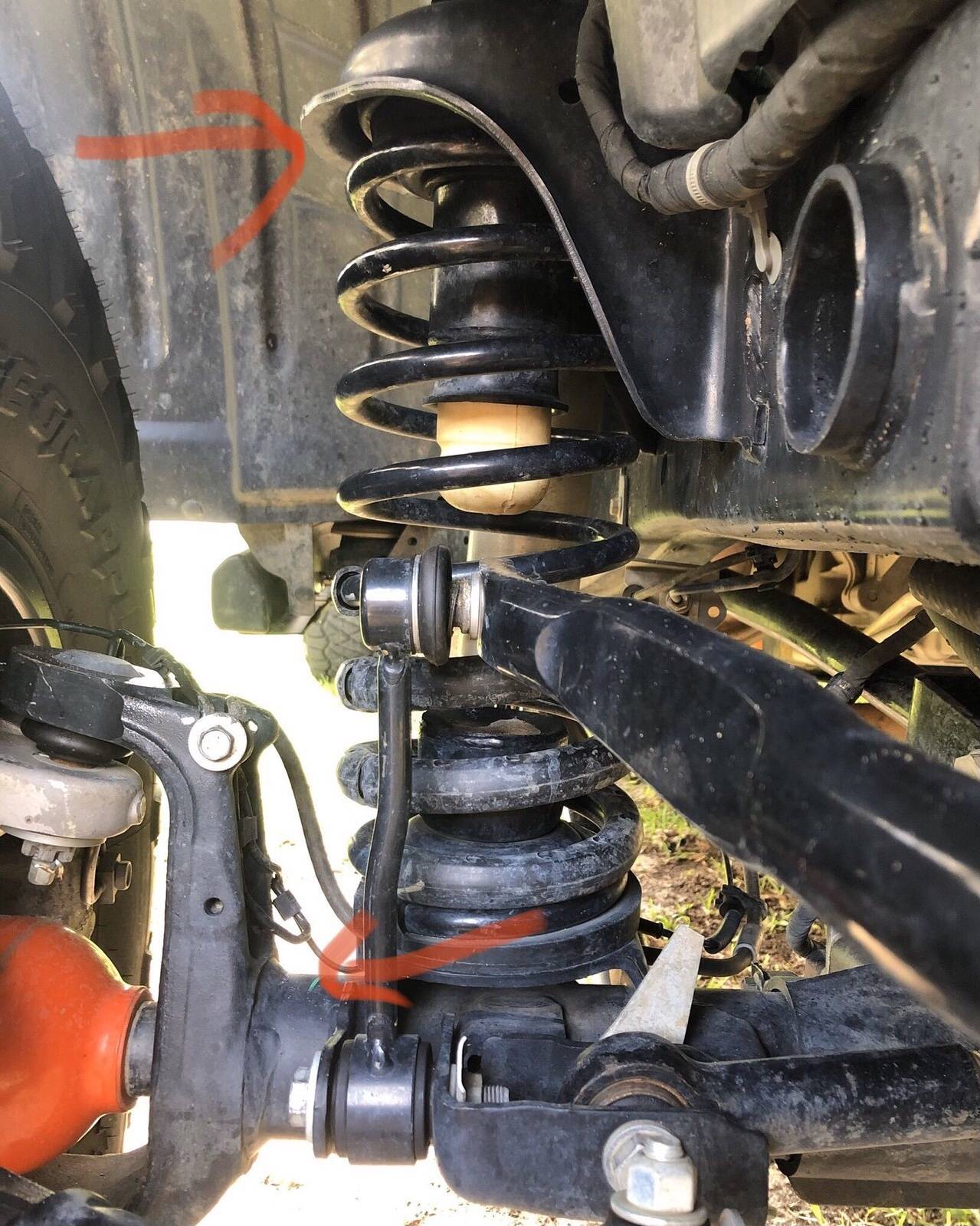

Ask on here, or if you know someone with a stock Willys or stop at a dealership and measure from top of the axle to the upper coil housing like in the pic …… then measure yours, the difference is how much lift you actually got………

I was looking to be sure as I don't remember if I put 2 or 2.5 spacers but needed quite a bit of space to keep the stock wheels and was a lot cheaper. The tires are 37's but technically KO2s are 36.5. I am going to need to find someone with a stock diesel willy's which may be difficult to find to measure exactly but the 10 7/8 was the average according to the link I posted. Per Roky's picture, that is the same measurement I got 15.5.
