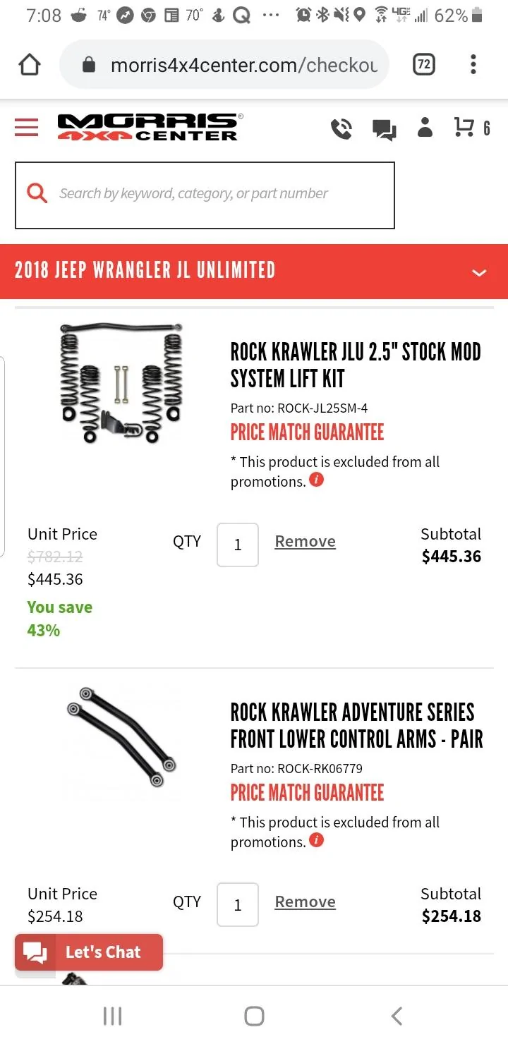

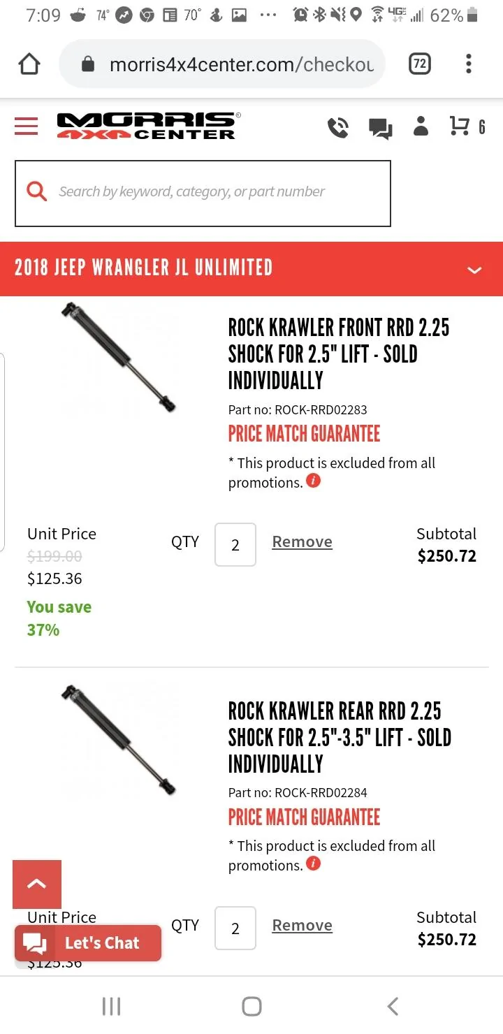

Seriously thinking about scooping this combo up, everything for $1200.98?!? Does it look like everything should work together?
I don’t see they offer any bump stops. Depending on what tire size you go with, you might want to add it to your list. For Rubi on 2.5” lift and 37s you’ll need 2” of bump. I think you can get their front and rear bump package for around 160.00 ish.
Also, at 2.5”, if you want to get an adjustable rear track bar, make sure you don’t use the relocation bracket with it, as it will hit the exhaust loop if you have factory exhaust. You’ll be fine with oem track bar paired with relo bracket.
These are my recommendations.....
Now my suggestions....pick up some rk no limit sway bar links. They’re designed specifically for Rubi electro disco. They have 60 degrees of misalignment and will let sway bar work to it’s full potential. Also, I’m not a fan of fixed lcas either, I like having the ability to fine tune caster.
Anyway......... this is an awesome deal, that imho, you shouldn’t pass up..........:rock:.

Thanks @Roky for the suggestions! It looks like the shocks were either a mistake or a one day deal, they're back up to the regular price. But the stock mod kit is still cheap, I may get it anyway.
I was going with the fixed LCAs because I like the low maintenance aspect of them, and the adjustables were super expensive, but now they're on sale too.
Adding the RK bump stop kit, rear adjustable track bar, Rubicon sway links, switching to the adjustable front LCAs, and ditching the shocks still only comes out to $1228.15, a great deal I would think, just gotta figure out the shocks.
Anyone have much experience with the rock krawler 2.5" lift and shock extensions?

I don't have experience with shock extensions but I have ran the RK 2.5" lift with stock shocks for a couple days (no extensions) and it was terrible. I would suggest looking around for a good deal on Fox shocks as they pair well with the RK lift from my research. Poly performance always has a 12% off deal running or there may be someone on here you can pick up some slightly used ones.
