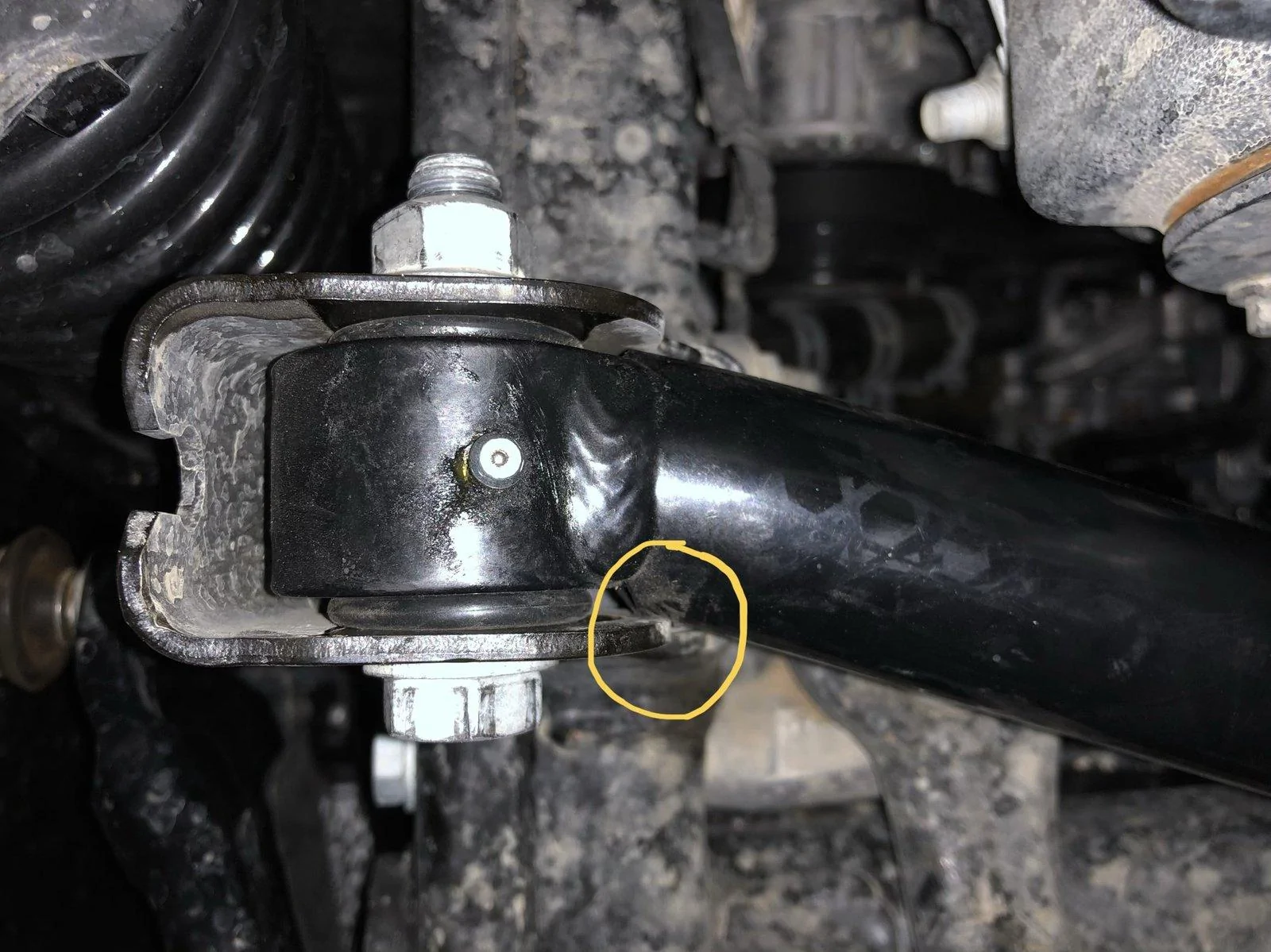

I have this same issue with the track bar hitting the frame side attach bracket. Is this that big of an issue really? My life is the 2.5" Adventure series 1 with the fixed lower control arms, RRD shocks and I added adjustable RK front upper control arms.

I think it's on page 11 of this thread. Track bar just slightly rubs the axle side attach bracket. RK said my axle may be pushed too far forward but I have fixed LCAs so I don't see how that's possible. They still haven't gotten back to me after I sent pics.

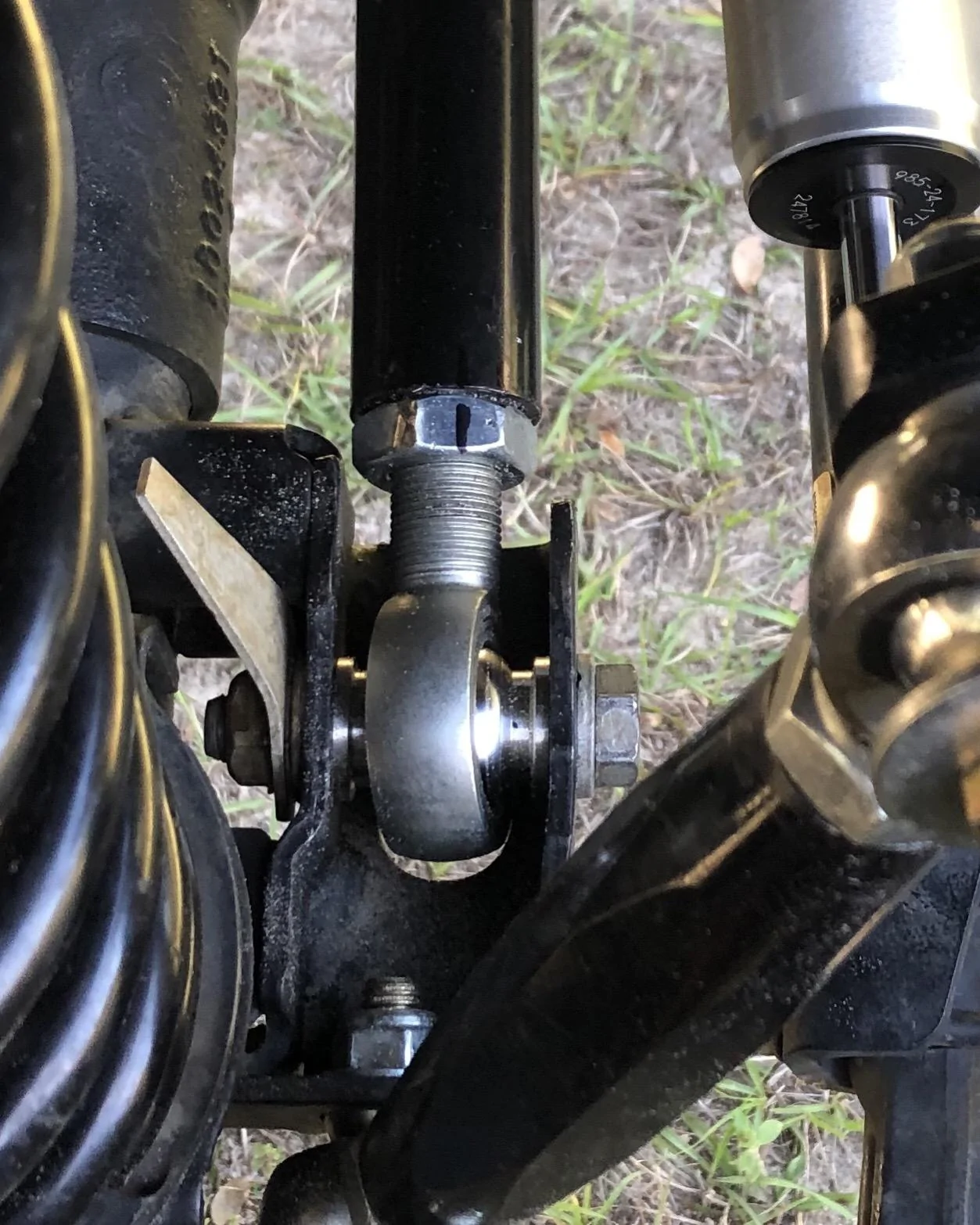

Here’s my axle side mount. The track bar is cocked because I’m on a ramp.
My bad...I meant to say frame side....axle side I'm good.
