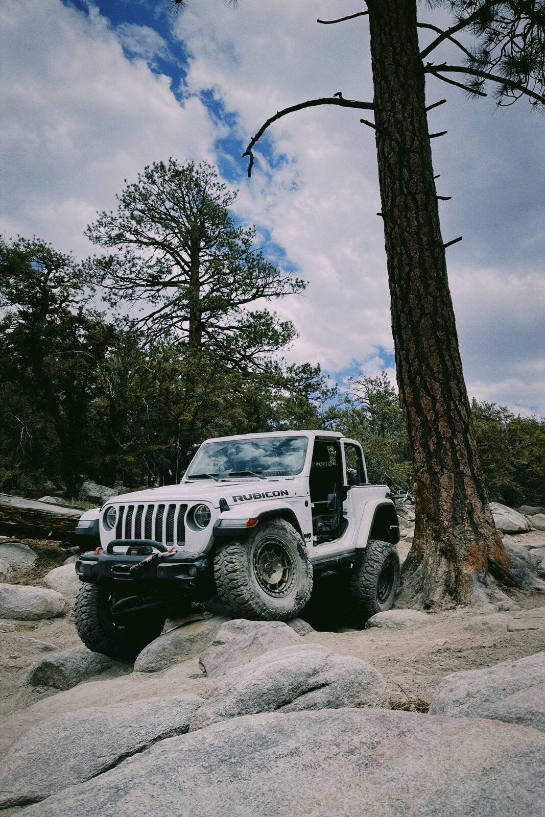

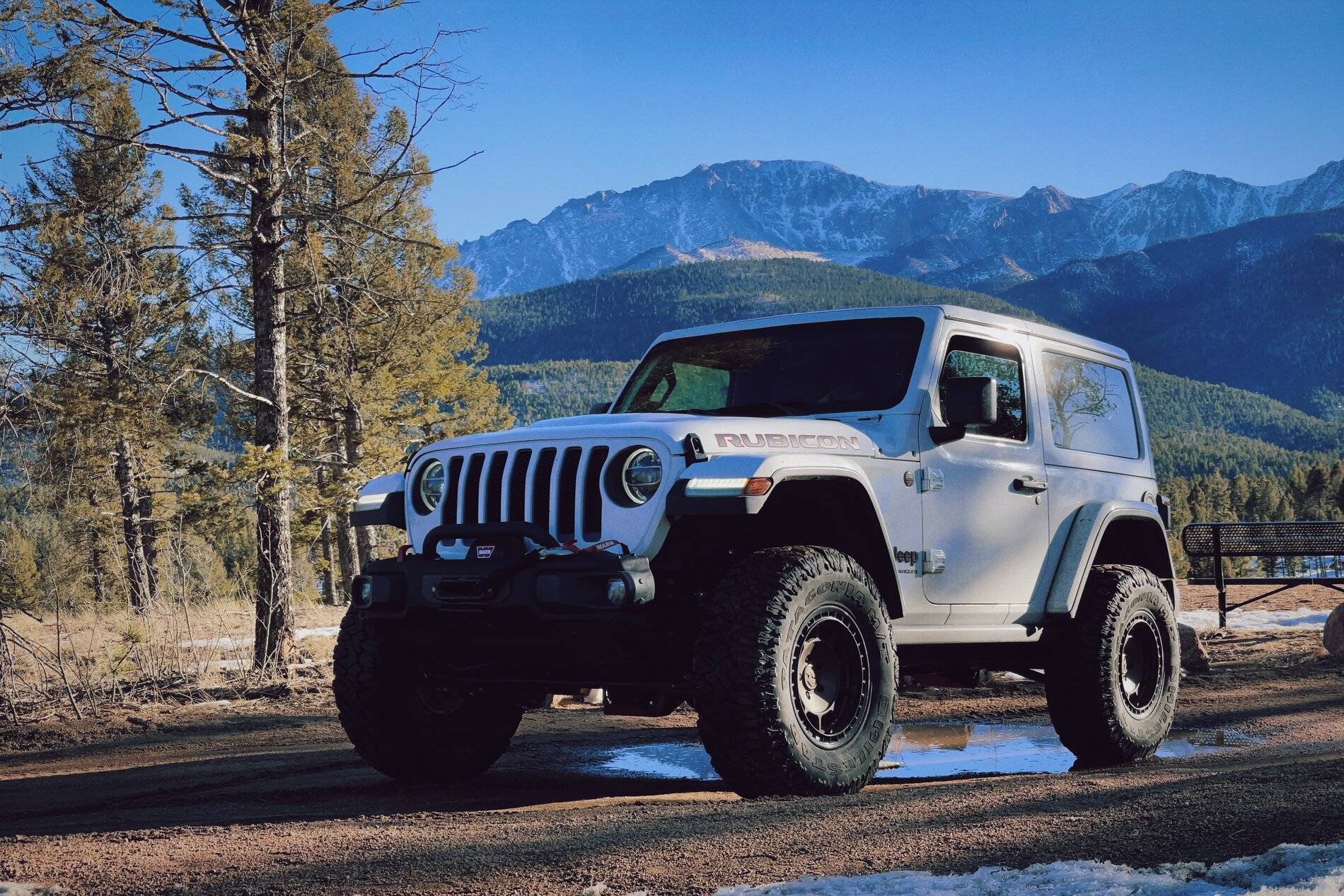

Great, although I ended up on 35” Patagonias. No rubbing at all at full steering lock on the LCAs and the lift is perfect height for me and the wheeling I do. RK didn’t include any bump stops so I’m running zero additional bump stop from stock, and I’m able to stuff the tire completely without rubbing the fender either. I’m sure this will change if I do the 37” route.How did your lift and 4.75” of backspace work out?
I’m undecided but will probably be going to those 37” KM3 next season so will see how that affects everything. Seems like a BFG that runs a tad small will still clear without rubbing.
