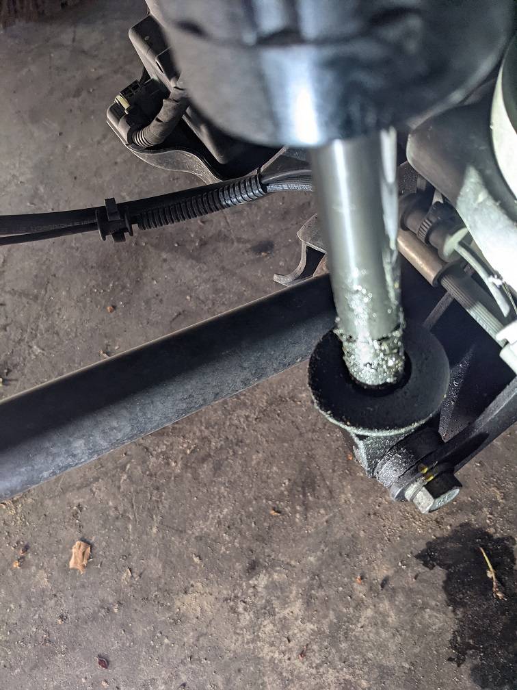

I have the 2.5" Adventure System (stage 1) with the 2.25 RRD shocks and when I was driving home last night on a winding country road, I could tell something was right. This morning I checked around the Jeep and found one of my shocks (front passenger) had leaked a bunch of oil (the other 3 are dry). I only have 11,000 total miles on the Jeep and put the lift on after about 5,000 miles, so there is only about 6,000 miles on the shock, but I have had them for over a year, so I think warranty is out. I haven't had much of a chance to go off-road, so it's just the pounding of our crappy California roads. What good shock options do I have? I'm willing to spend more for something that works better if need be. Thanks

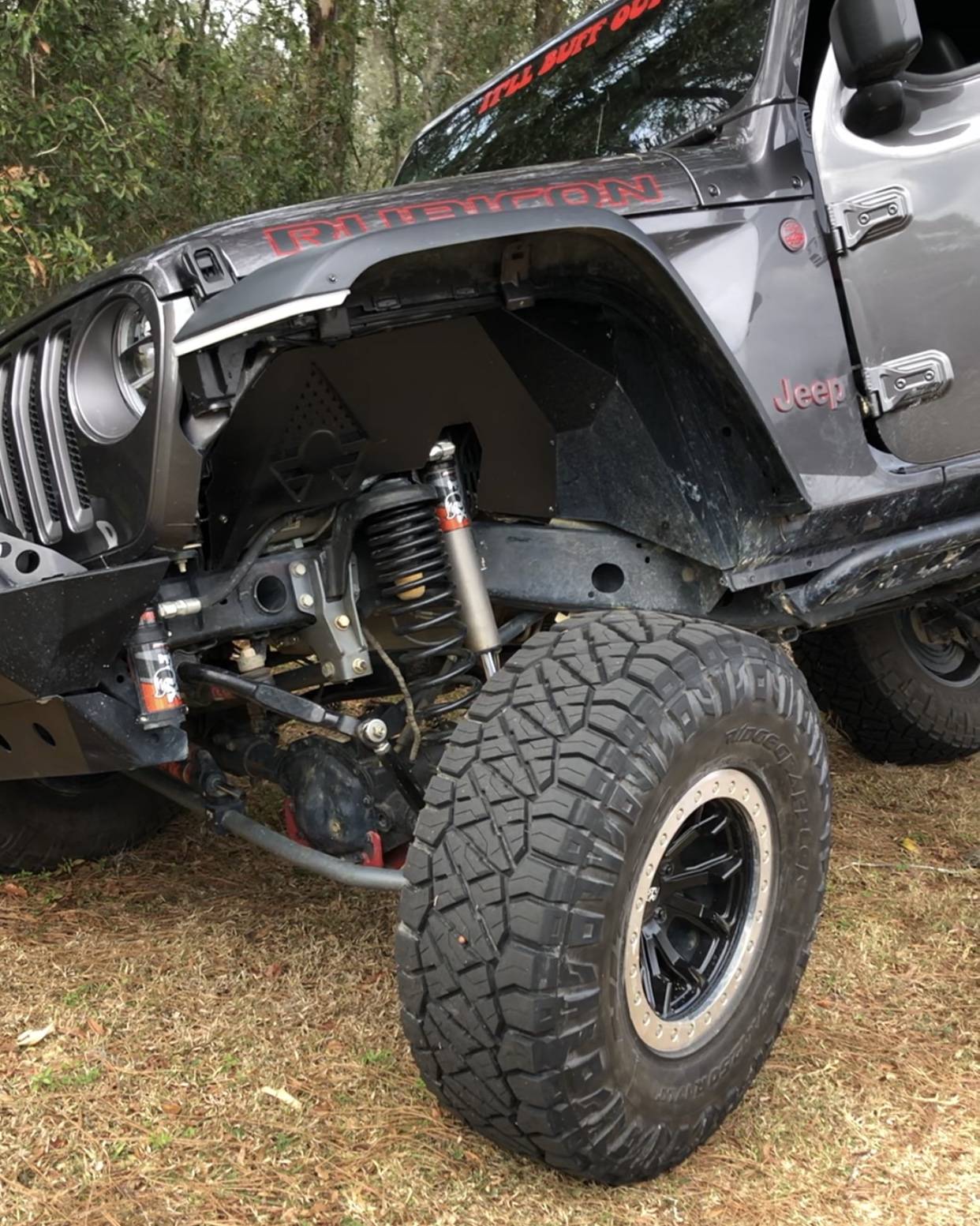

Fox pairs really well with RK springs.

Depends on how you use your rig, if mainly DD, the 2.0 resi would work great. If you want a little better performance and adjustability off road then you might consider the 2.5 s . Best thing to do is talk to @AccuTunedJL . They seem to have a pretty good handle on it. I’m running the 2.5s and they’re great for my setup .

Those are rebuildable and the parts are relatively cheap. I'd probably go that route before dropping 3k on new remote resi's.

I might, or I could just buy one for $250. Normally, that is what I would do, but last year I blew the seals on 3 of 4 kings on my Ram 2500 and I had them re-sealed and it happened again, so I put some foxes on that and have had no issues. I can't figure out how I keep blowing shock seals, I don't beat my vehicles. They are not rusting or exposed to a harsh climate. I just want to fix it once. Thanks for you reply.

Well, I did what I was told and called Accutune, they had Foxes in stock and ready to be tuned. I think I got the same ones that Roky got (adjustable Fox 2.5). In the little bit of time I had to research this, Accutune's name popped up several times. Thanks again for the advice.

Got the shocks on Friday and I installed them on Saturday. I was only expecting it to ride a little better than the old shocks, but was amazed by how much better it rode. I was bombing my windy, bumpy country road like it was a trophy truck. I haven't even had time to mess with the adjustments. I just dialed them all 4 clicks in from the full "-" setting and drove it. No off-road time yet, but I love them so far. My wife agrees that it drives way better too and she has no idea what shocks are or that I paid $3k for them ;). Thanks for all the help and suggestions.

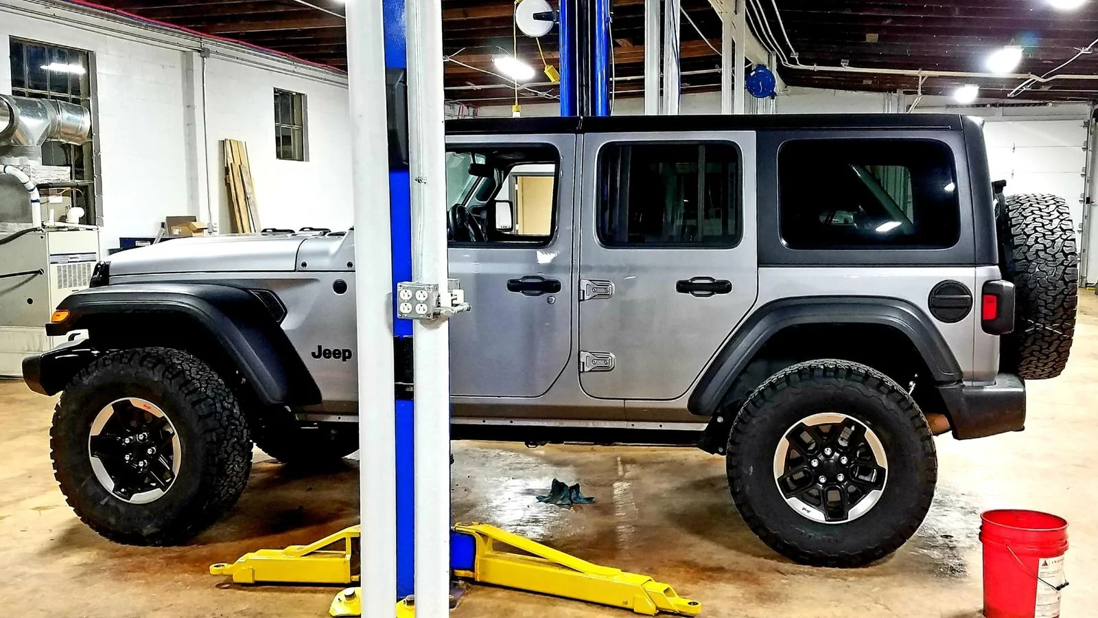

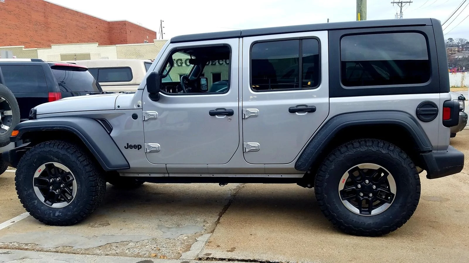

Any help is appreciated...I've been looking at my jl with added RK adventure 2.5" stage 1 lift, can you help me understand how this lift adds 2.5" of lift? I made sure coil pads were used and coils arent bound up. It feels and measures more like a 1.5" lift on my jl sport that has jlur d44 axles. I looked at the coils tonight and they are part # RK 04186 which also googles as being triple rate coils for a 1.5" lift for the wrangler jk and jl. I'm wondering if I was accidentally sent the 1.5" coils or springs for a jk that would offer a smaller lift on a jl. For example:
https://www.northridge4x4.com/part/...f8AYUlN1VVXiYFbUG5p7jc7rGoFMIwxBoClU8QAvD_BwE
Here's jeep pre lift on 315/70/17 tires(camera is slightly angled making front rake look bigger)
On same tires with 2.5" lift:
Considering tires are upsized from stock rubi 285/75/17 ko2(measured 31.75" mounted where tread starts) to a bigger 315/70/17 which is measuring 33" mounted where tread starts. So with tire upgrade alone, it gained approx .6" height(radius of 1.25" diameter bigger tire).
I went to a jeep dealer today and measured the same spot on flat ground on 2 stock rubicon jl's(driver side low point on belly at hole cut out for bolt in tubing crossmember that runs laterally) and both stock rubi's measured 13.25" from the ground. (@TTEChris was also kind enough to measure one) I then measured my 2.5" lifted jeep with .625 radius bigger tires on flat ground and it measured 15.5". Here's my measurement:

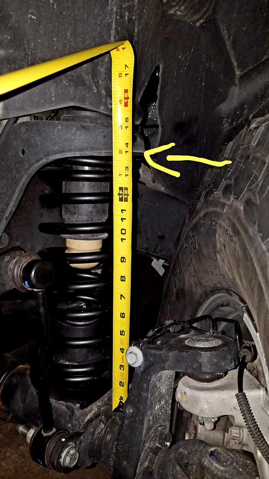

Here's the front driver side measurement from the top of axle to bottom of cup that holds the coil showing 13.75". Would someone with a stock rubi please measure this height for comparison?
In summary, this lightweight jl (plastic bumpers and no winch) is now 2.25" taller than a stock rubi measured at the belly at same spot on flat ground after going to taller 315/70/17 ko2's and adding a claimed 2.5" lift. I was expecting to be atleast 3.25" taller than stock rubi right after the lift before it settles..What am I missing? Could these coils be the wrong size Thanks for any help!
For a 2021 Rubicon Xtreme Recon this measurement is just under 12.0 inches. Bone stock.
