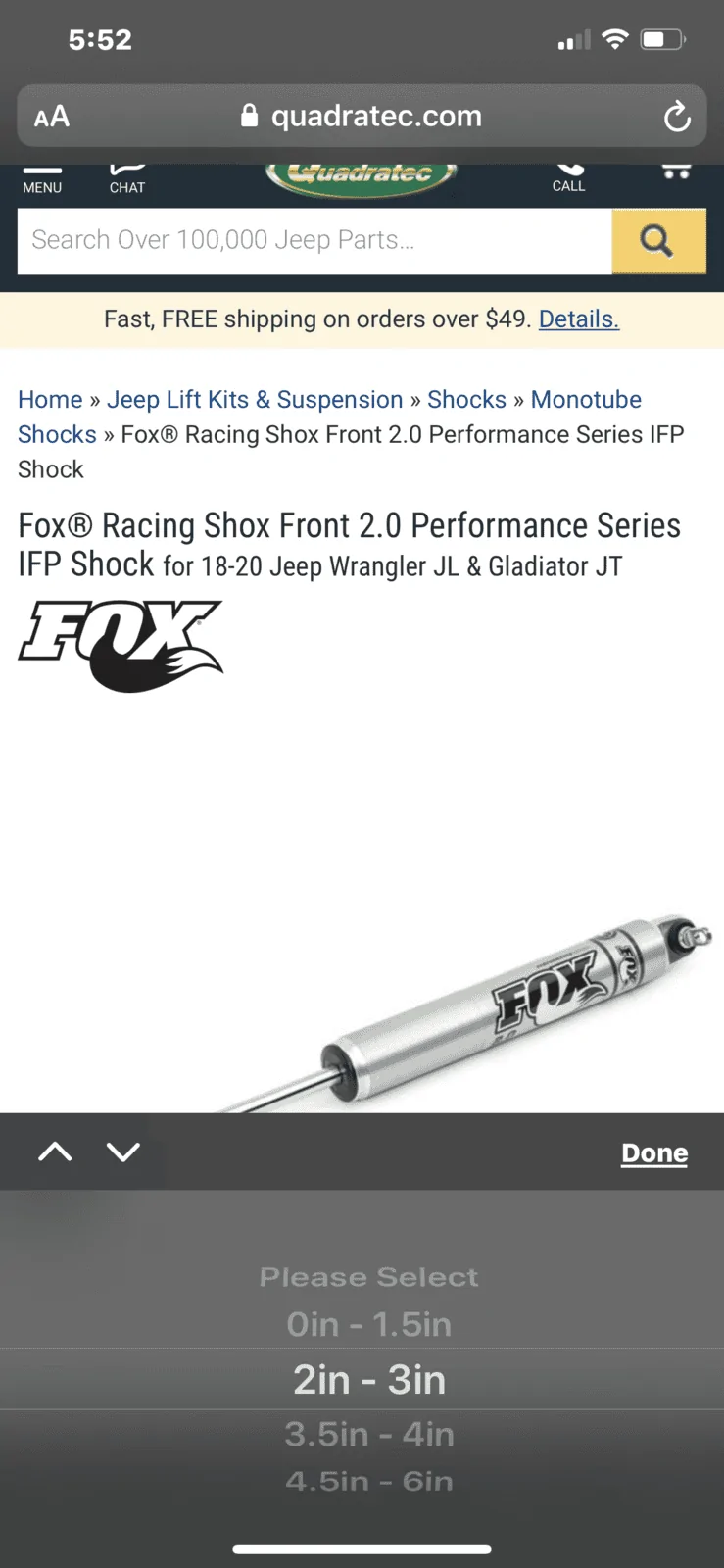

Anyone run the Fox 2.0's with The RK kit? Was thinking about doing this

That’s good to know. Did you use the 2-3” Fox for your 2.5” lift? I see there’s a bunch of options. Also what maintenance is required for the RK kits?

Yes, I went with the 2-3" version.
