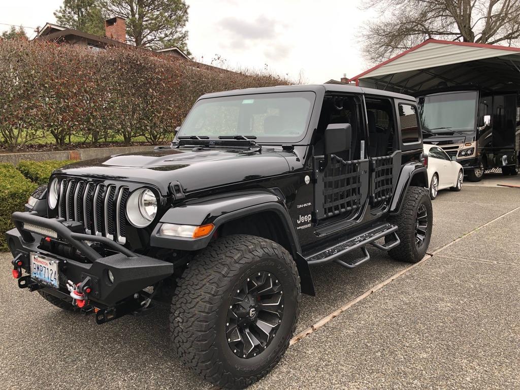

I have the GoRhino Dominator D6 Sliders with removable drop steps one reason I decided on GoRhino was for their powdercoat warranty, GoRhino warranty's their finish for 5 years. While I have only had them since NOV yet live in Washington (one of the wettest states) not a spec of rust, regardless I expect GoRhino back their warranty.

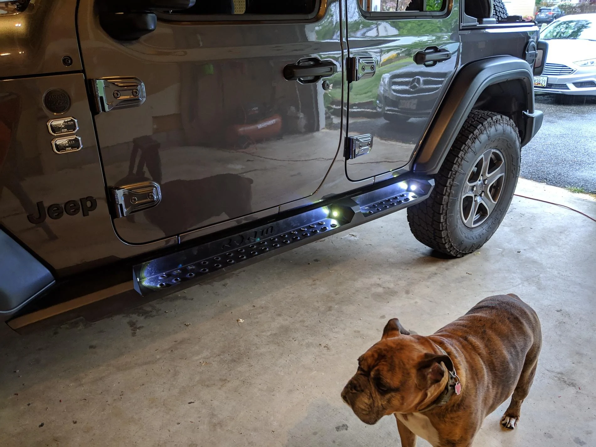

Less then a year on the road and I'm less than happy, The lights? Meh. Pretty much assumed they were junk and they meet my expectations. What I was not expecting was the amount of rust inside the steps. I do live in a state that salt/brine treats its roads in the winter. And I know salt and powder coat don't play well together. However, I have never experienced this kind of rust after 8 months with any of my other powder coated metal over the years.
Jeep Wrangler JL Roam sidestep Rust IMG-20190505-111200
Jeep Wrangler JL Roam sidestep Rust IMG-20190505-111210
Jeep Wrangler JL Roam sidestep Rust IMG-20190505-111228
Jeep Wrangler JL Roam sidestep Rust IMG-20190505-111242
I replaced the led's with 1w 11mm bullets from Oznium. I used a step bit to open the holes a little.
Jeep Wrangler JL Roam sidestep Rust IMG-20190505-125137
I coated the inside of the steps with Eastwood frame paint. This paint comes with a 24" flexible nozzle to reach in all the nooks and crannies. It both encapsulates the rust and has a zinc protectant for future rust resistance. If it's good enough to coat in inside of frames, I think it should work in this application.
Jeep Wrangler JL Roam sidestep Rust IMG-20190505-122400 Jeep Wrangler JL Roam sidestep Rust IMG-20190505-122353 Jeep Wrangler JL Roam sidestep Rust IMG-20190505-114449
$70 in parts. Really hoping to get another year out of these.
Jeep Wrangler JL Roam sidestep Rust IMG-20190505-152826
