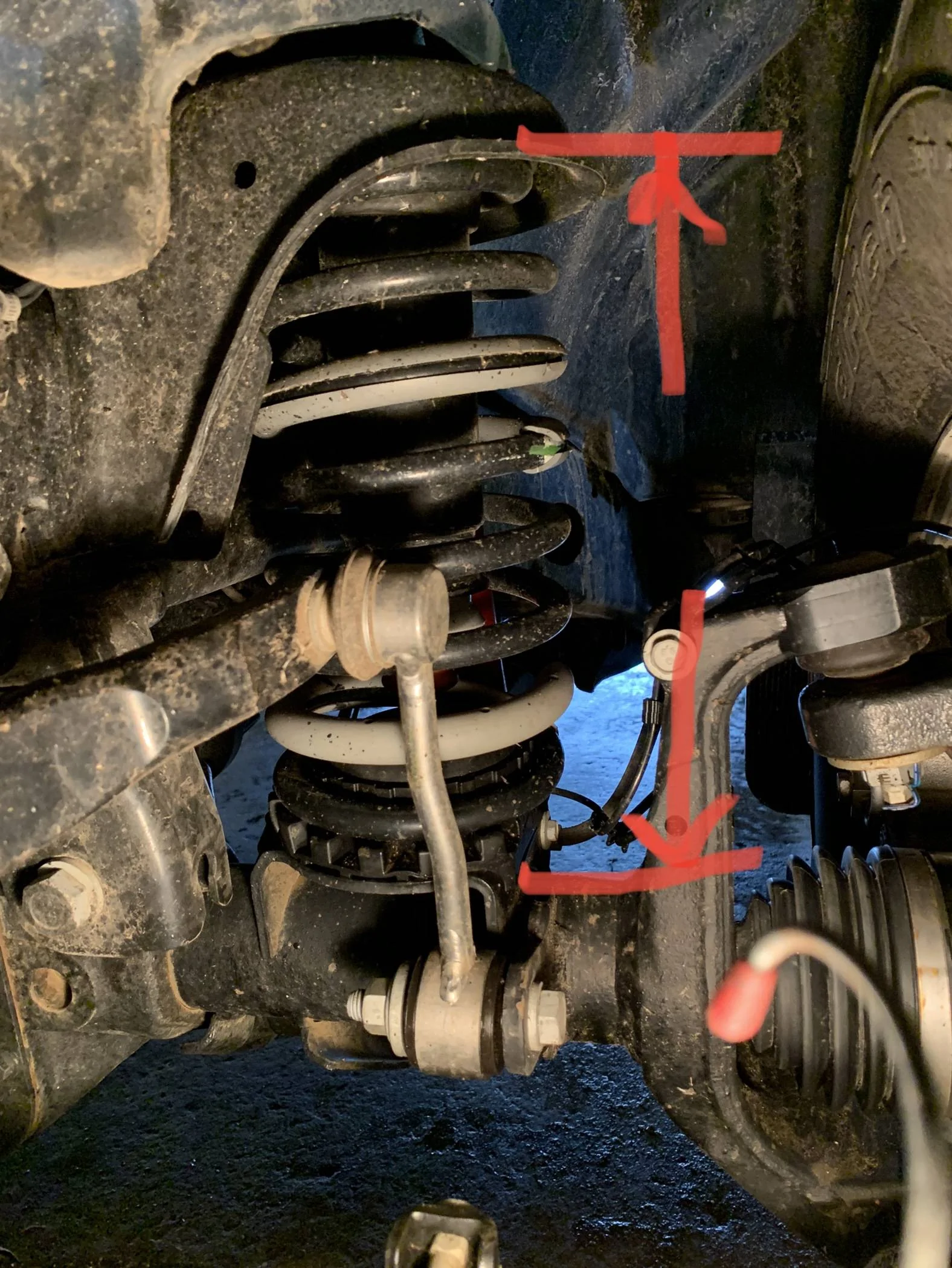

This argument went on for years with the JK as well. And yes, You are correct, There are no absolutes. It’s a one by one deal.
Bottom line is and it doesn’t change the fact that OEM springs are weight rated not lift sized or intended. The only reason they give lift is because of a heavier weight rating as I explained a post or two back. If they sit higher then stock average you loose free length.
Measure for yourself from front bottom spring base plate to upper spring perch lip and see what you get and I’ll tell you how much lift you have.
and when you come back here with a number I’ll tell you what the number is (with video proof) of a base 2 door sport with no mods.

Exactly what I’ve been trying to say all along. In the JK world the only guys interested in Rubi springs were the 2 door guys searching out FREE 4door Rubi springs preferably dual top, tow package models.
If the Rubicon was suppose to be taller it would also have different trackbars and swaybar links then the sport or Sahara, just like the XR does.
