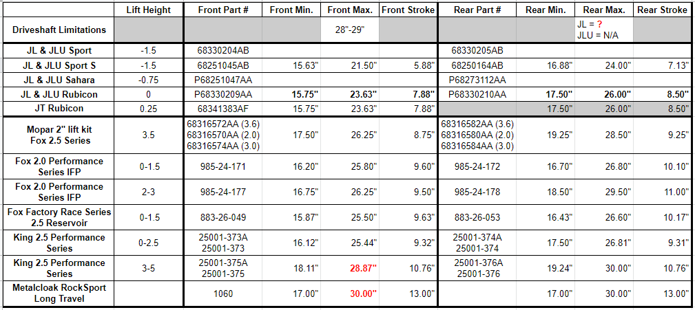

There is a Mopar chart that explains that Rubicon is the strandard Wrangler suspension and considered as 0
Rubicon: 0
Sahara: -0.75’’
Sport: -1.50’’
I guess we can now add XR : +1.50’’
Now all kind of springs are adressing the weight of steel bumpers, engine, hardtop and tow package.
So putting Rubicon springs made for a 3.0 steel bumpers, hardtop with tow package on a 4 cyl plastic bumpers and soft top sport will lift you much more than 1.5’’.
same goes for putting springs made for a 4cyl rubi on a 6cyl Sahara, you won’t get no lift at all. ( ask me how I know ?‍?)

THIS is something I didn't know. I'd love to see this chart, as that's exactly what the OP was looking for I think.

Having the hardest time finding the one I meant, and there's been quite a few other Rubicon specified charts making searches even harder, but this one here gives a good idea where you see what I mentionned.
Jeep Wrangler JL Ride height by model 1668438554986

Exactly, thanks! I still wonder/assume if the Altitude family has the same springs as the Sahara?

I would think if it's a Sport Altitude it would be the sport height & if it's a Sahara Altitude it would have the Sahara height. I could be wrong but I think the "altitude" is just a blacked-out appearance package

The Altitude package includes heavy-duty suspension, which is the same as the Sahara and Sahara Altitude, so a Sport Altitude is only .75" lower than a Rubicon, equally optioned. The Sport Altitude also includes the bigger brakes that the Sahara and Rubi use.
