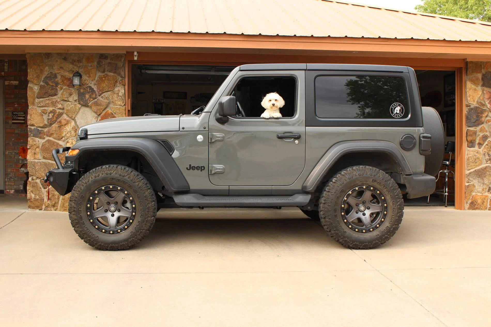

After I bolted all my goodies on the front of my rig, the sag is very noticeable from behind the wheel. I have been researching ways to lift the front back up.
There is almost endless debate here, and on all the 4WD forums for all the popular trucks and SUVs about whether to add spacers or add springs. I have decided to go with springs.
I only have one tag from my front springs, and I don't remember which side it came from. I could only find one tag, and I just had my head up my ass not making a note of which side it was. The spring is a 658. According to the chart floating around here, the choices for a 658 are 657/658 and 658/659. I can't prove it, but I'm assuming I have 658/659 on a Willys.
The lowest tier springs used on Rubicons are 659/660. It is not clear, but my gut says I will want to go one notch more than that. I decided to order a pair of 660/661 springs.
First of all, does this sound reasonable so far? I'm trying like hell to do my homework here, but all of this stuff is pretty far beyond my experience.
Second, I understand that I have Rubicon shocks, and that these are literally the same part numbers as a Rubicon. I expect, therefore, that if the shocks work with the rest of my suspension, then throwing in some beefier springs won't require me to make any further adjustments or swap any additional parts. The goal is to just get back to factory geometry, without screwing up the camber, or necessitating lower control arms or sway bar links.
In a nutshell, I'm just trying to do what the factory does when you order a metal vs. a plastic bumper, or a hard top vs. a soft top. They put beefier springs in to offset the weight. That's ALL I want to do. I just want to put it back like it was. Making it higher is an entirely separate project, and one for another day.
Much obliged.
