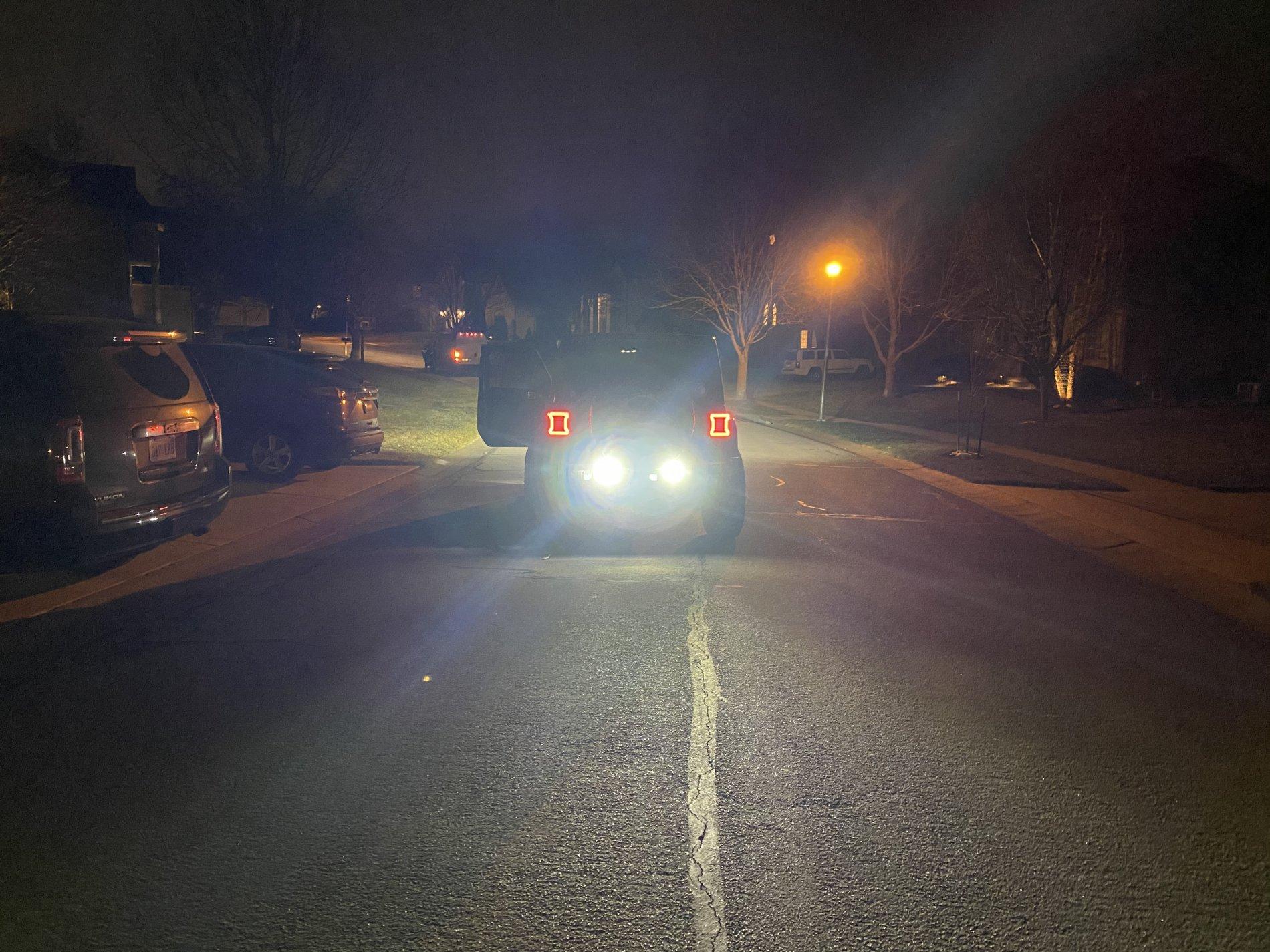

Had mine installed to Aux 2 by a local shop and they turned out great. He knew about the fit problem going in and trimmed the steel bumper for an easier installation. He did point out that he thought my drivers side light had a production defect in it though. Looks like the top was melted almost? Odd. I didn't realize how much salt I picked up on a 10 mile drive home until I looked at these pics! Gotta love Chicago ... not.
