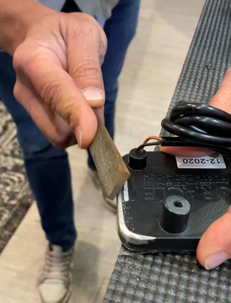

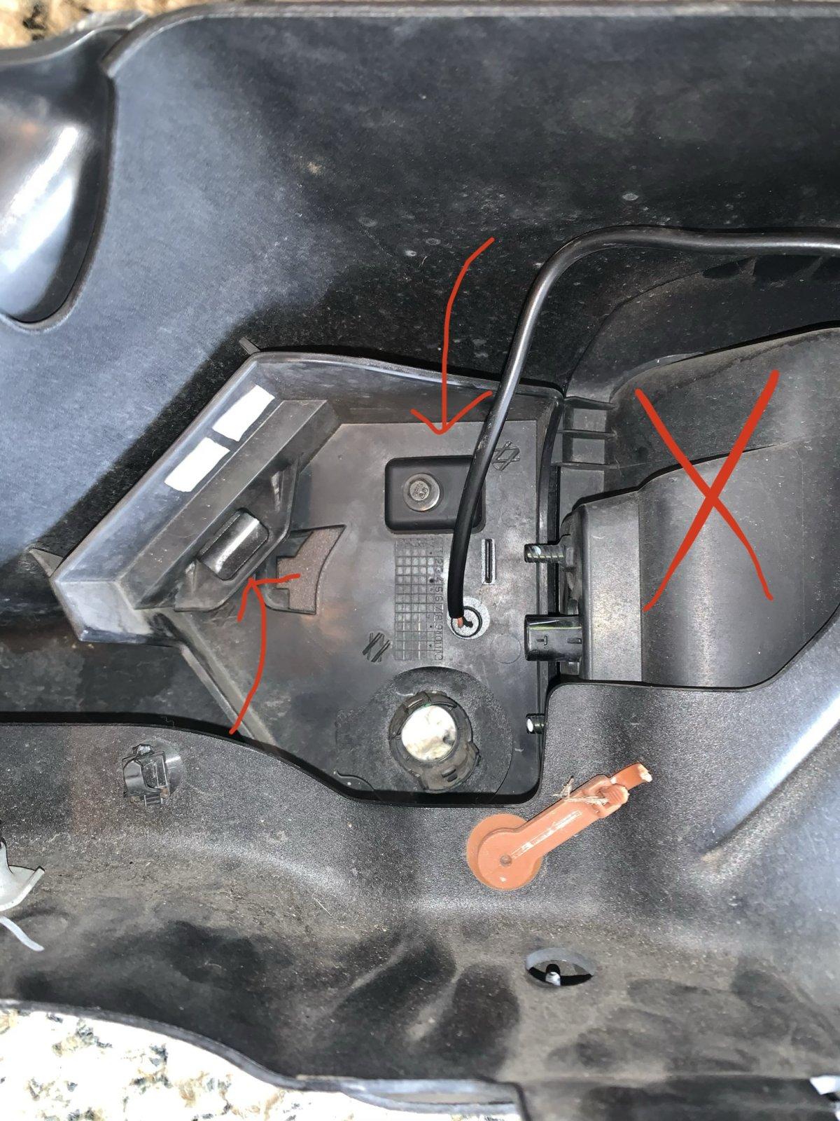

Thanks @ORACLElights for jumping back into the discussion and acknowledging our challenges. JP responded to my email last night with a similar and helpful explanation and a photo showing the adjustments required which looks like a steel file shaving off some of the bevel along the back and corners.
Now that I understand the necessary adjustments and how to do them, I’d rather get a replacement left light versus a full refund. Can you PM me whether or not I can return the cracked left light for a replacement one and then I’ll do the necessary shaving? I guess it’s not much different than just returning the entire product and then repurchasing a new kit afterwards and doing the modifications - it may just save time. Appreciate your willingness to take the return.
Here’s the pic showing the modifications needed for steel bumpers...
Jeep Wrangler JL Rear Bumper Integrated LED Reverse Lights A19035B1-DD82-408C-8CD5-DC0825EE508A

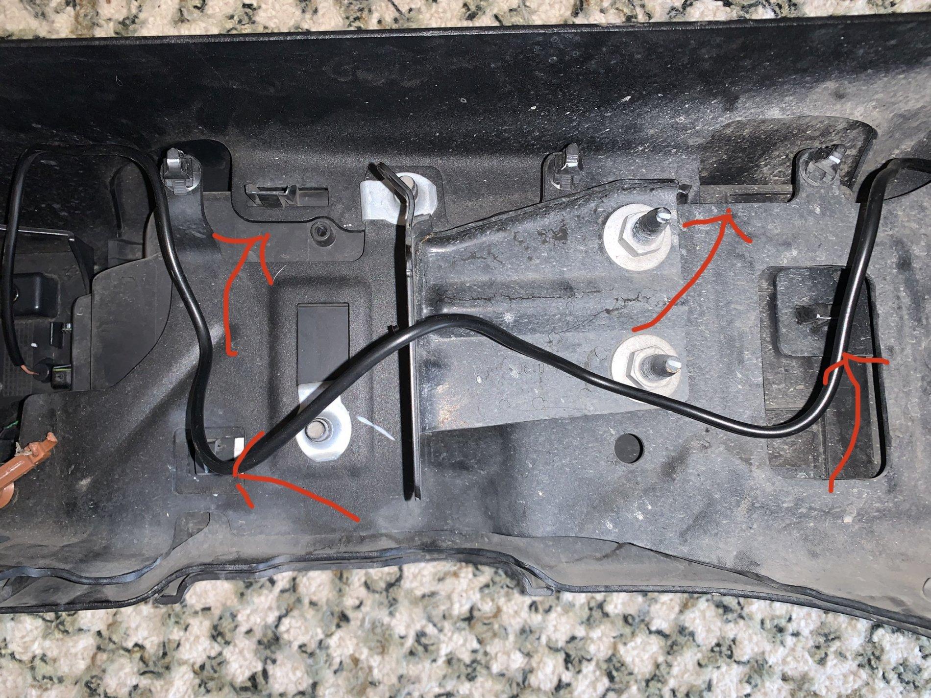

Okay, I am in the middle of this install on a steel bumper. I chose to take the bumper apart previously since I was considering the rigid lights so I got to play around with the best install. Here is what I believe would be the easiest install...
1. Remove bumper.
2. Remove license plate trim. Just a few plastic tabs.
Jeep Wrangler JL Rear Bumper Integrated LED Reverse Lights 62CF267F-1BBF-4507-BF63-C4361BEA70FE
3. Remove 7mm screw on the inside of the bumper holding in the reflectors.
4. Remove the plastic tab on that same bracket holding in the reflectors.
Jeep Wrangler JL Rear Bumper Integrated LED Reverse Lights 1EEC4FB5-5B05-45C1-9F23-4EF013A06288
5. Steps 3 & 4 will allow you to pop off the bracket enough to remove the reflectors from inside the bumper.
6. Feed wiring through hole and install Oracle lights the same way you removed the reflectors. Note removing the license plate trim gives good access to the driver’s side now.
7. Reinstall bracket, reinstall screw, and reinstall the tab.
8. Reinstall license plate trim.
9. Reinstall bumper.
Steps 2-8 took 30 to 40 minutes.
Now I still have connect everything but I didn’t have to trim or modify the lights (or bumper). Like everyone has noted the driver’s side light wouldn’t fit from the outside of the bumper without modifications.
