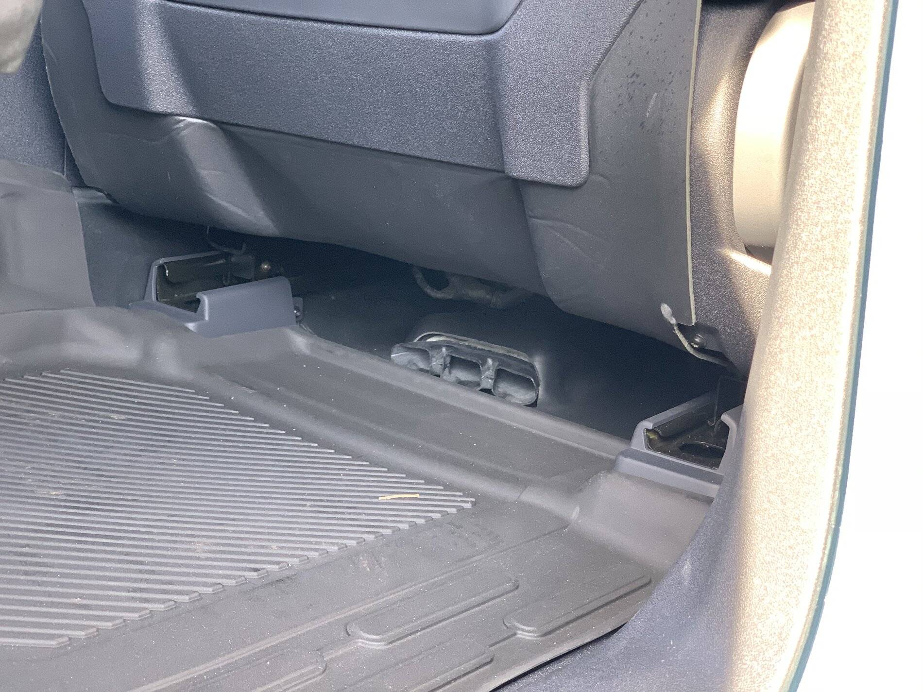

…..Stuff like this makes me hope the Bronco kicks Jeeps a**. What a joke.
Bronco has air vent issues of their own. This is the vent all models have for rear passengers. It’s located under the front seats.

What's the alleged issue with that design?
The vents are ONLY on the floor, unlike the wrangler which has two conveniently placed air vents in the center console for your passengers convenience.
Nothing if you only want air to blow in your toes. And I believe it’s only under one seat so the othe passengers gets nada. There are no moving louvers to direct the flow.
“Alleged” ha ha ha. That’s funny talk right there mr lawyer.
It is when the context-impaired leave us hanging.
Undefined "issues" ha ha ha. That's funny talk right there mr grammar.
And you believe the vent is only under one seat? Do your due diligence and get back to us.

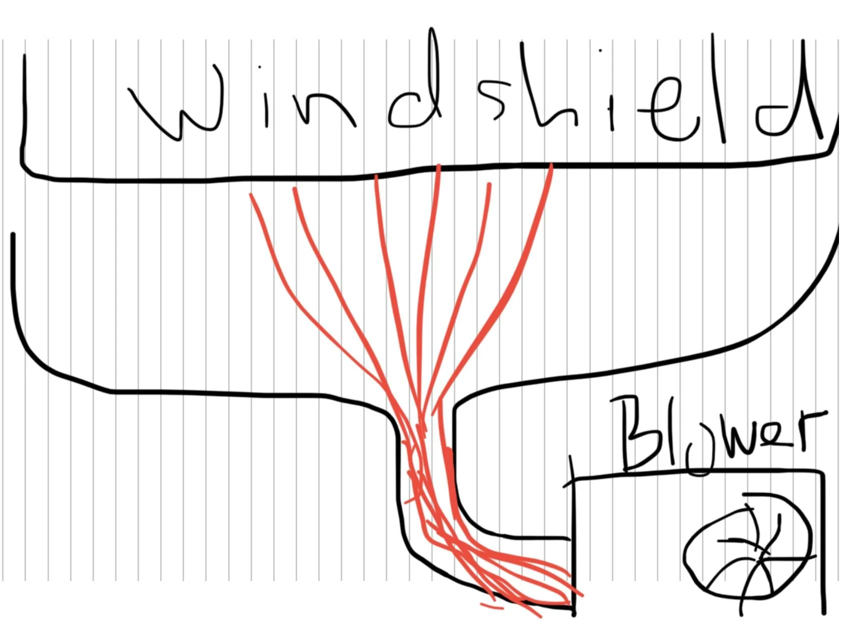

I was under the impression this issue was long understood and it was concluded that it was a design issue, not a manufacturing defect or any other defect. It was just designed terribly.
The small number of people who claim they get air at the ends indeed do get air at the ends, it’s just that the air flow at the ends is less than 5% of the center. Once again, this isn’t a manufacturing defect. It’s just a terrible, inefficient design. This is why the dealers say that it works as intended because it was designed that way. They can’t “fix” something that “works” according to Jeep’s standards.
I drew these diagrams really quick on my phone but you can get the idea of what’s going on.
This is most likely the design of the JL windshield vent:
Jeep Wrangler JL Question regarding the Windsheld defrost 52725807-10FD-47DB-8F70-545900F4066A
Air, like all other fluids, and like electricity, will take the shortest and most efficient path possible. Because the vent from the blower widens up to the entire width of the windshield, it is only physically logical that most of the air will blow from the center, where the air exists the blower vent. There is absolutely no way the air will change direction to the far left/right unless a physical object forces the air to change direction. Because of the fact that 80-90 percent of the air blows out from the center area, it leads me to believe that the above diagram is pretty much how the JL windshield vent was designed.

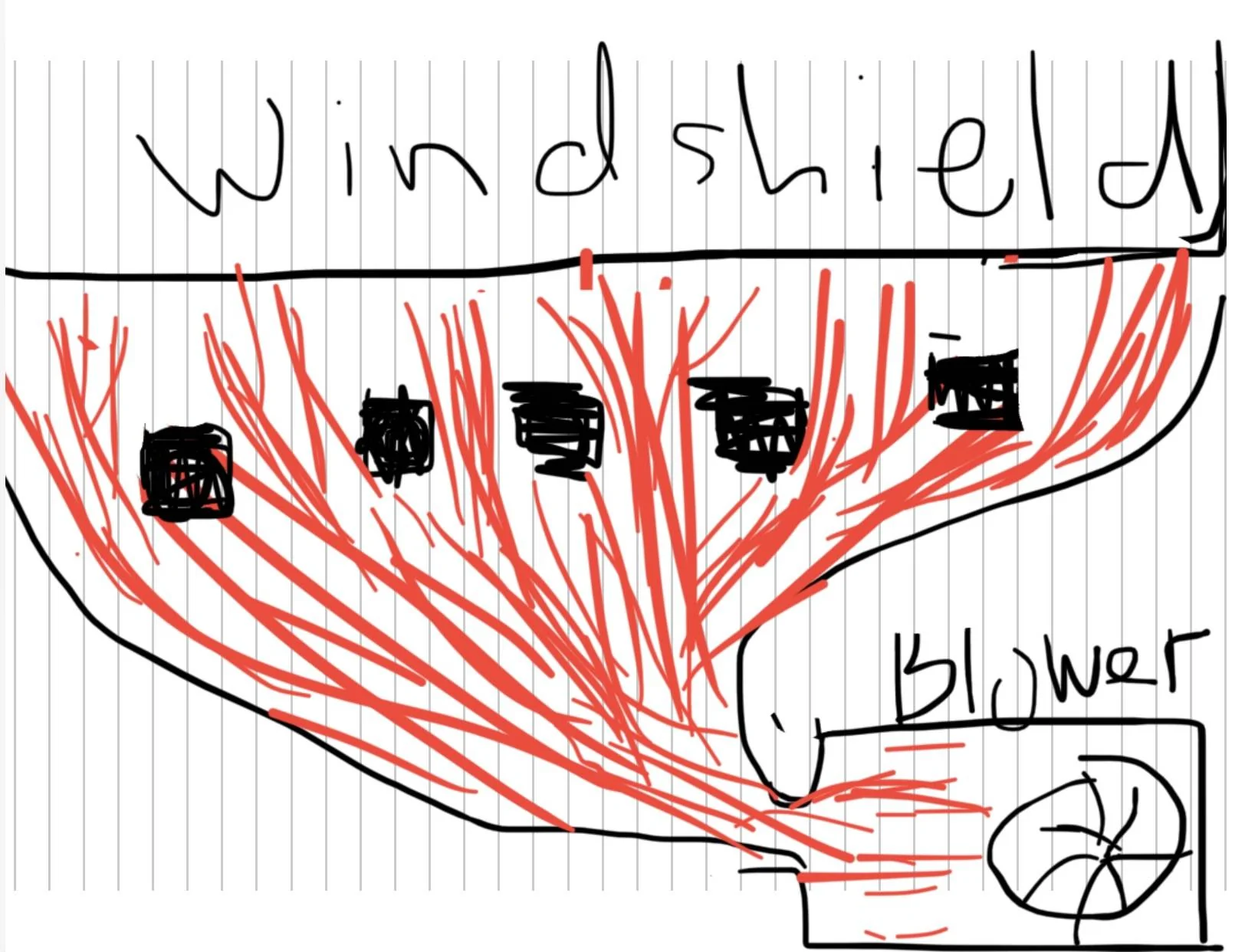

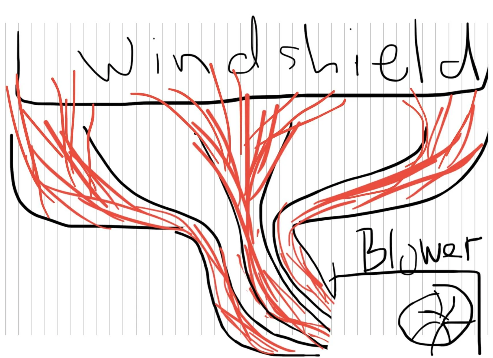

The unfortunate thing is that it would have been very easy for Jeep to design the vent properly, like it is in pretty much every other vehicle on the road. Here are two very simple designs that would have been easy to implement and that would work well, at least much better than it does currently:

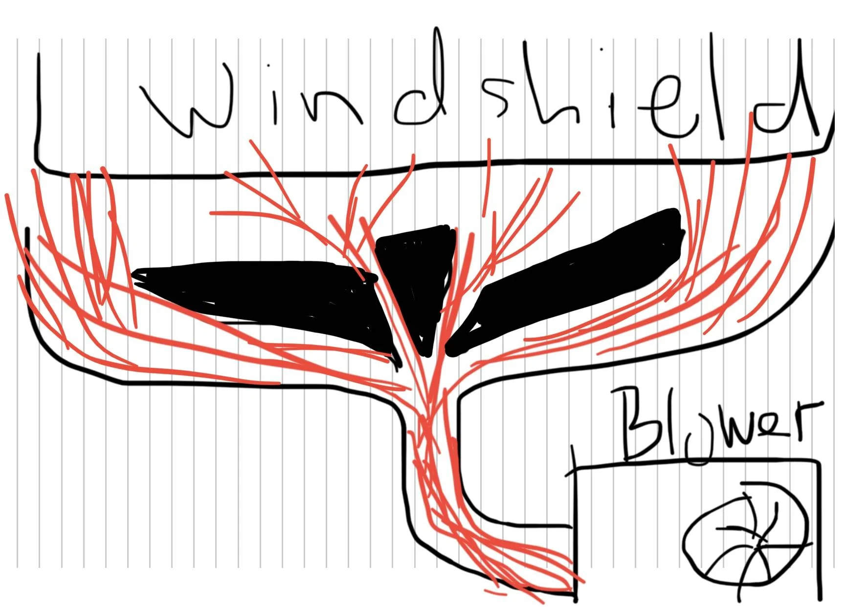

Hell, even the DIY method that many people are implementing would be much better than the inefficient design they chose to go with:
