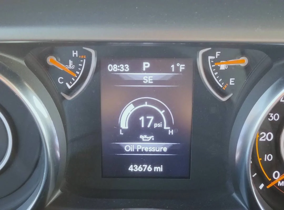

No.
I've installed these end cap plugs in a staggered formation across my dashboard. Recent temperature trends havecompelled me to run the defroster on max heat. If they were sensitive to the Jeep's nuclear-grade heater, I'd have surely smelled something by now.
