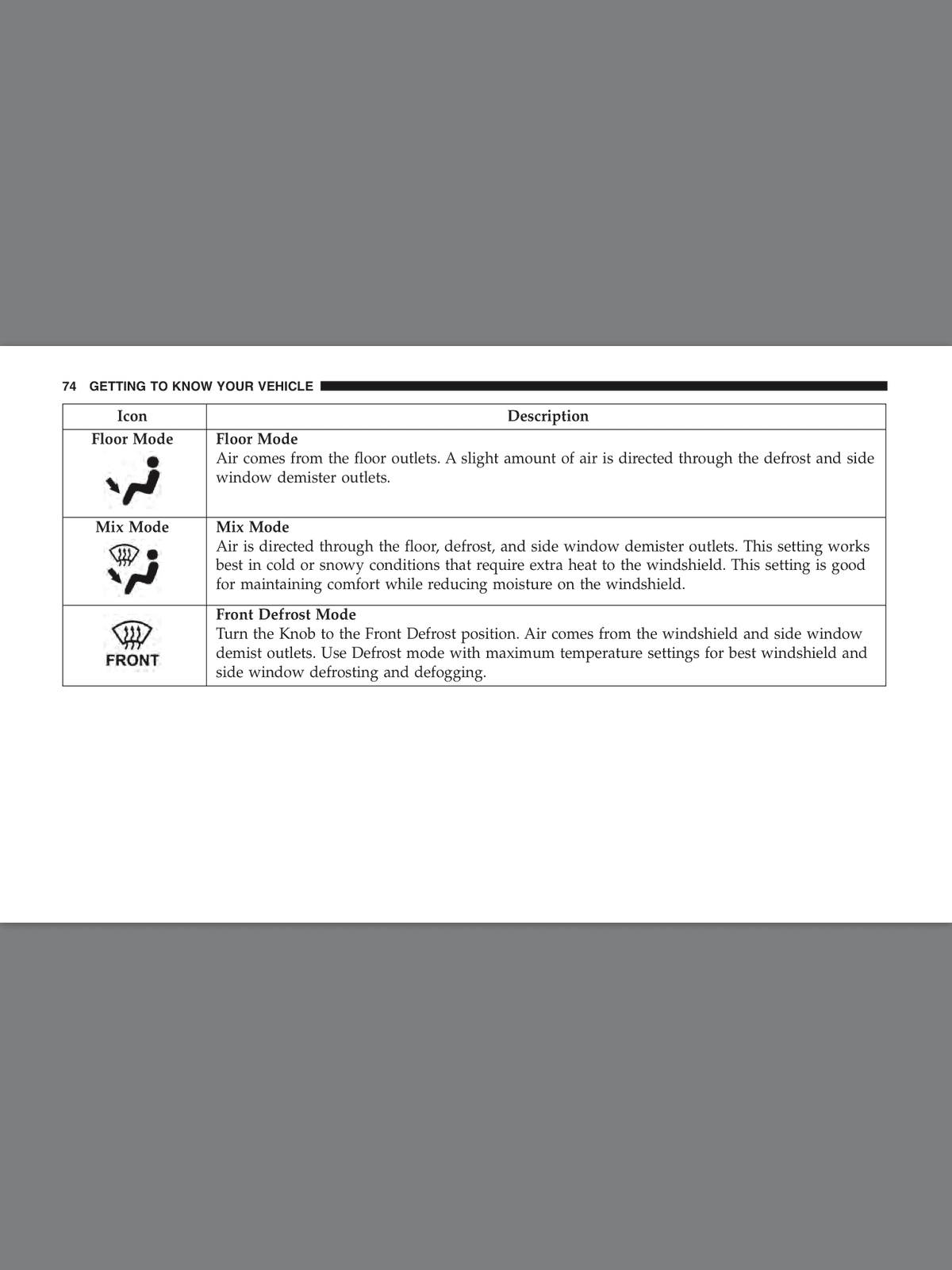

Anyways, I finally had a chance to use the windshield defrost (top left button on center console) but noticed that it only warms up the center portion of the windshield. The 1/4 on both ends don't receive any warm air.
Thought it was strange because there seems to be vents on the ends but I couldn't find a setting which forced any (warm) air out of those vents.
Anyone else get a chance to play around with the windshield defrost vents?
It seems your doing things right according to the owners manual.
