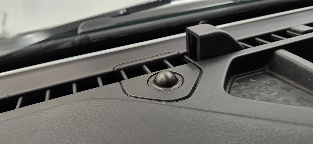

I'll just pipe in on this as we're currently experiencing the great seattle snowpocalypse of '22, so I recall what visibility was like when I first drove through the mountains in my new jeep.
I bought the small plastic plugs & installed them..seems to alleviate all the issues & I'm happy with the results: highly recommend this as a viable solution to the lousy defroster design/output

Do you happen to have a pic of which slots you placed these plugs into?

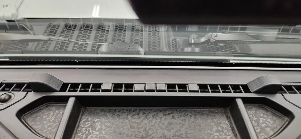

sure, make me go out in 25 degree weather to take a picture...AS IF! ;)
I used 11 of the plugs: basically one in the direct center & then 5 to each side, with a "vacant" hole between each.
I probably could have continued further to the sides, but I figure I wanted to move some of the air to the sides, not move it & then block it again...play around & see what works best for YOU
Thank you very much. Hope ya didn’t get too cold.
I filled up 20 center defrost holes with those plugs and works good enough for now. (2020 JLUR here)
