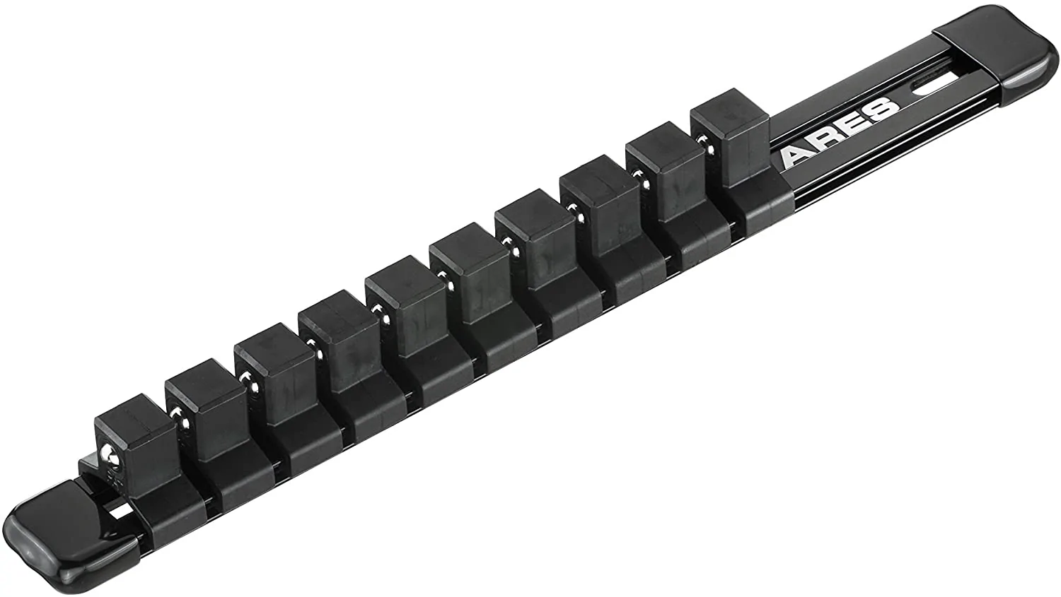

I used a socket holder, works great and the black looks good. Does not look like a socket holder at all when in the jeep. You can remove them if to many and space accordingly. This is for 1/2"
