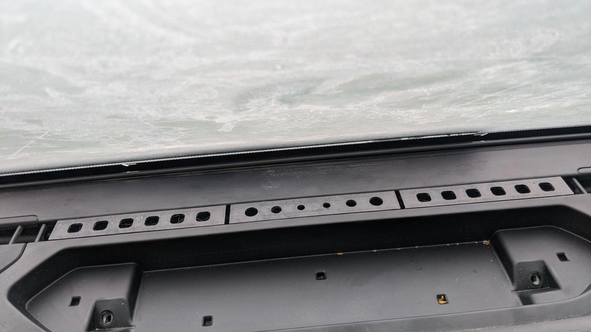

Latest pictures from mine, I was delayed because I had to make a design change since it turns out there is a lip/bar inside the vents on the side closer to the interior that interfered with my "ramps". As of now I am very happy with the results, there are just two things I am looking to resolve before printing these for other people (both related to my printer/the design):
- I ordered a new spring steel build plate because my current one has a few minor lumps/creases in it that show up slightly in the prints sometimes (should be here this week)
- I am going to modify the design a bit to have the ends of the two side covers interlock under the center cover to prevent that little lip you can see between the left cover and the center cover in the picture below. That lip is also caused by said build plate issues which I am resolving though, so this is more just to make the design a bit more "compliant" with any tolerance issues.
All of that being said, I cannot see the covers from a regular driving position and even when I actively look for them, they don't stick out as a "not stock" which was my main goal. The air definitely gets spread to the sides a lot more and seems to be pretty even to me. I would really like to test these in the cold/snow, but for some reason it's going to be 40+ in New England for this whole week....

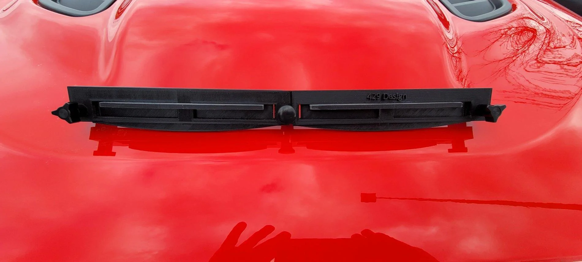

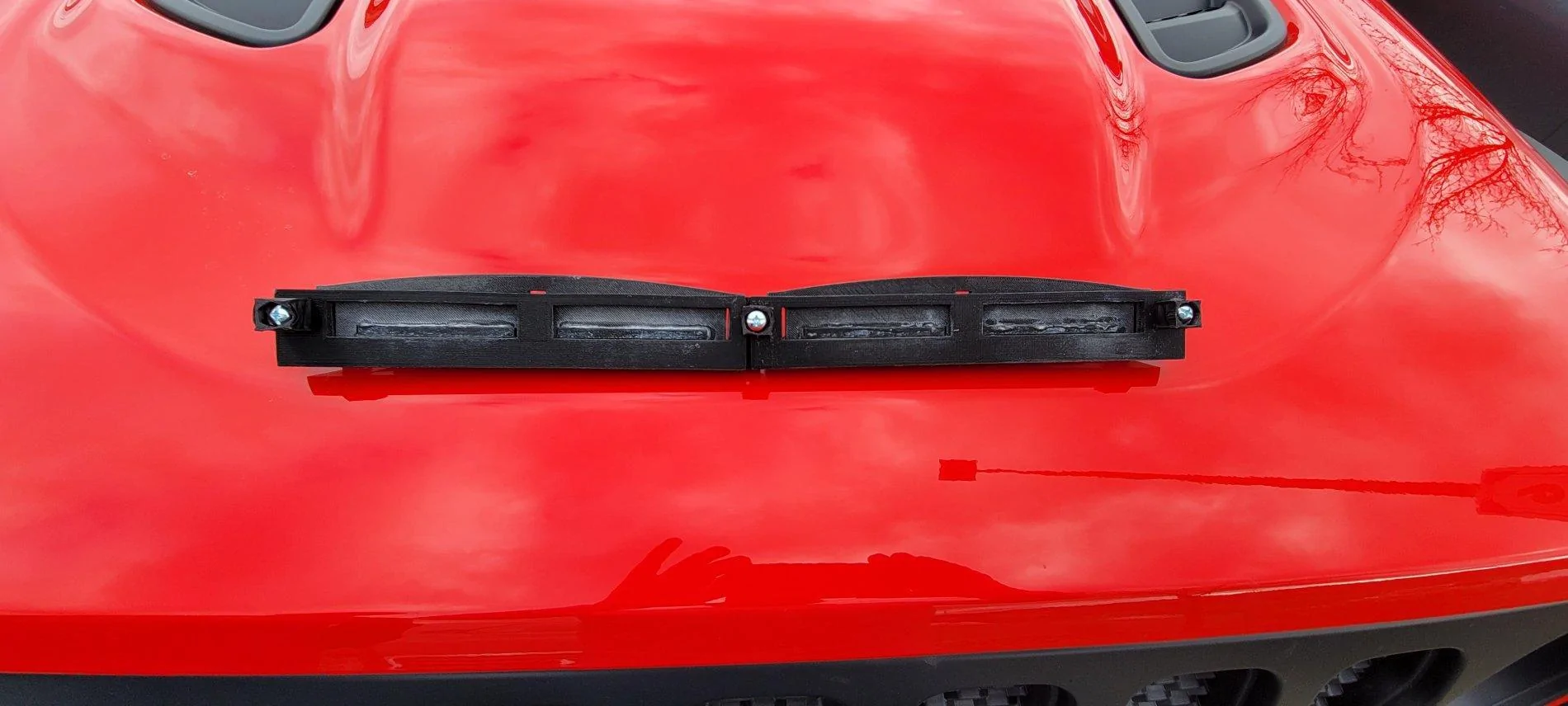

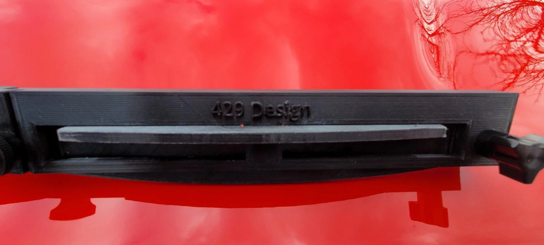

Our prototype/alpha is currently being tested. This unit allows blockage of the center front windshield defroster in two separate adjustment points via a slider. From fully open, and increments to full close. More to come on the JLMaxDefrost3000..... ?

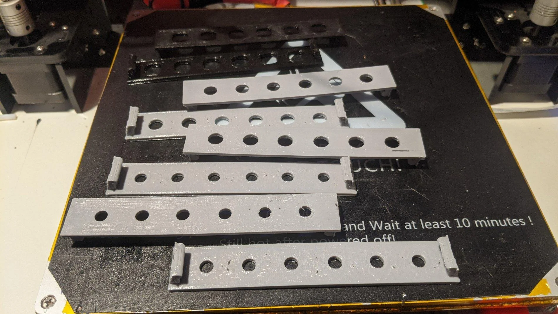

I've seen what everyone else has tried and I think it time to share what I came up with. I have designed a very simple vent block in a short modular design. The parts are 3D printed in PETG and click-in across 8 vent holes. I have been testing different hole sizes, but it varies a lot depending on how strong the fan is blowing. When I confirm that the designs work, I'll upload the model to Thingiverse so others can try it too. So far, the best test uses 5-7 of these strips starting with 6mm holes for the middle 3 and moving to 8mm and then 10mm towards the edge. I have found that restricting the air flow across the whole dash works well on high, but I have not done long-term testing yet. The part do not signigicantly change the blower noise and they are easily remove

That looks like a great design concept. The whole goal is to reduce the amount of airflow through the central portion of the defrost vent and force the air to exit the farther reaches of the vent. Did you try 5 plates across (an extra on either side with the all 10 mm holes, which may ensure good heating nearer the edge of the window and help airflow over the windshield remove slushy ice/snow buildup from the wiper? I have a friend with a 3D printer and will try these out.
I actually think that 7 across will work best, with 3x 6mm in the middle, flanked by an 8mm and 10mm on each side. It's -15ºC here today, so I should be able to finally test it. The point of my design is to provide options for different conditions and make them easily removable. I'll have some local JL/JT friends test them too before I make the models public.

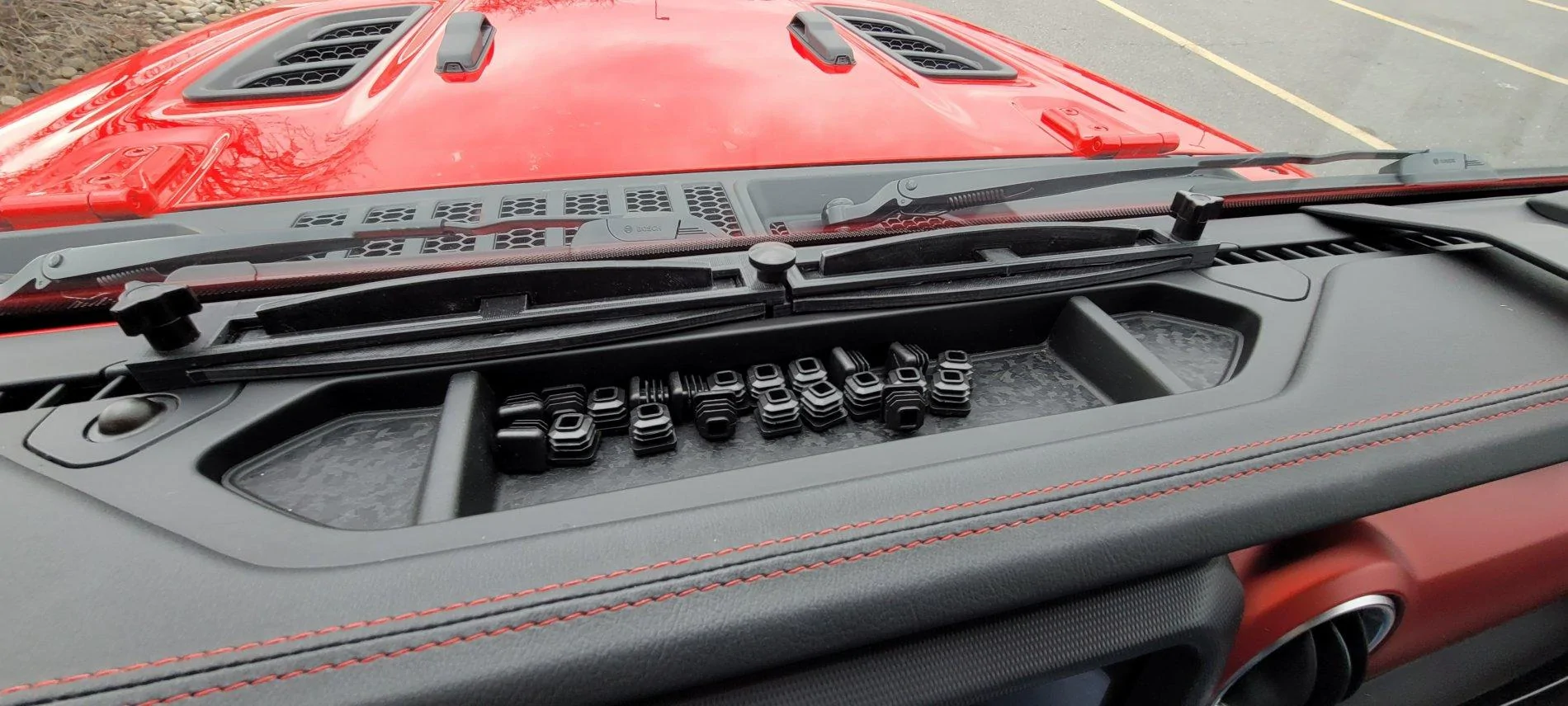

I’ve had the opportunity to try out my plugs a few time since my install and made a few tweaks. At first, it was much better towards the sides, but I noticed a little icing in the center because not enough hot air was hitting the windshield. Rather than remove some of the plugs, I drilled small holes in the plugs that are located under where the driver-side windshield wiper sits so a touch mire hot air can hit the wiper. It seems to be working how Jeep should have designed the vents in the first place. I drove around in record snow yesterday (snow falling at 2” per hour with over 20” in to total), and only had a little icing on the driver’s side, where the wiper hits the end of its reach and deposits the snow. This is to be expected. My wipers never iced over and my view was always clear. Not once did I have to stop and scrape ice off the windshield. Very happy!!
