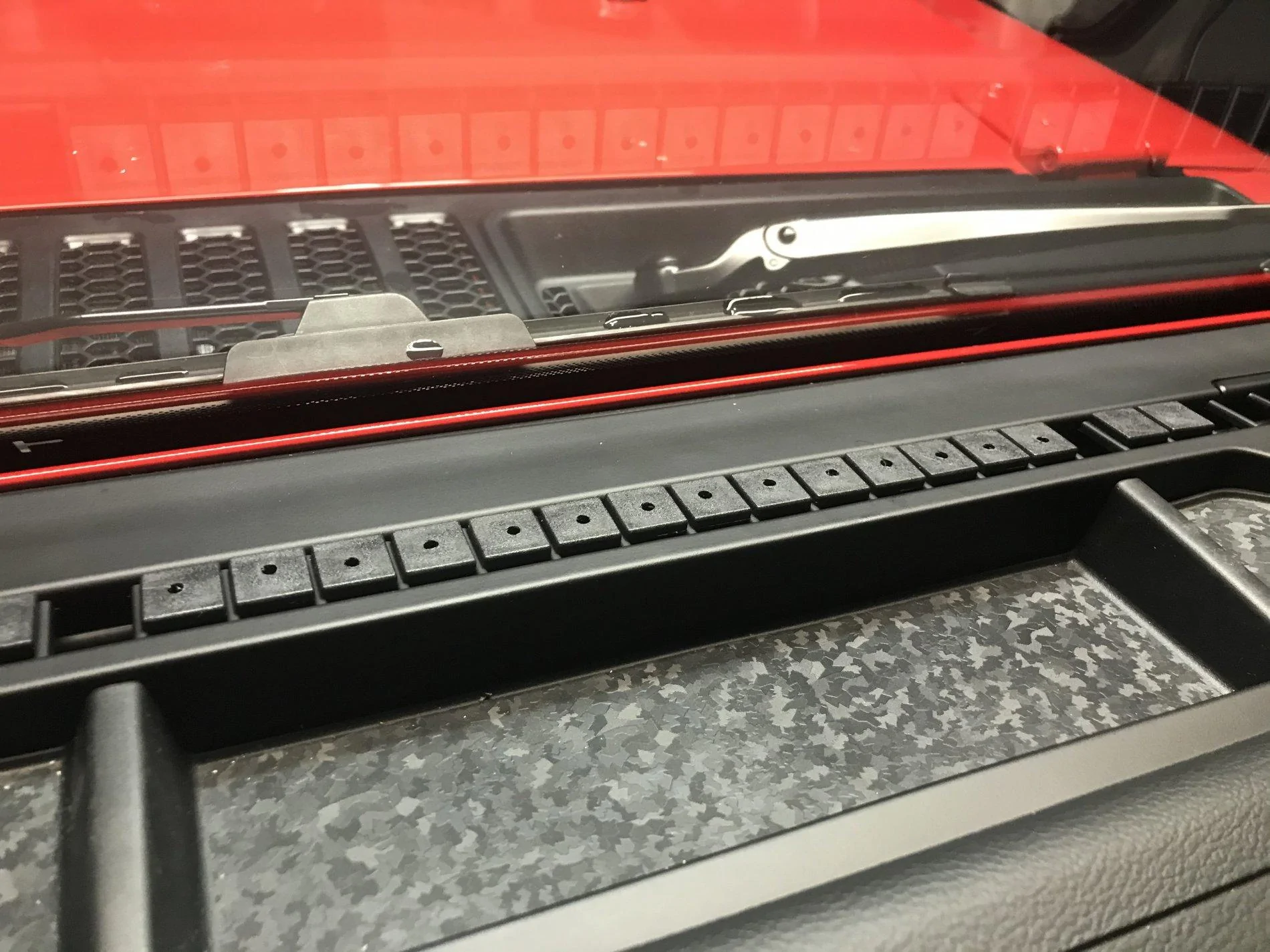

I’ve had the opportunity to try out my plugs a few time since my install and made a few tweaks. At first, it was much better towards the sides, but I noticed a little icing in the center because not enough hot air was hitting the windshield. Rather than remove some of the plugs, I drilled small holes in the plugs that are located under where the driver-side windshield wiper sits so a touch mire hot air can hit the wiper. It seems to be working how Jeep should have designed the vents in the first place. I drove around in record snow yesterday (snow falling at 2” per hour with over 20” in to total), and only had a little icing on the driver’s side, where the wiper hits the end of its reach and deposits the snow. This is to be expected. My wipers never iced over and my view was always clear. Not once did I have to stop and scrape ice off the windshield. Very happy!!

What size drill bit did you use?

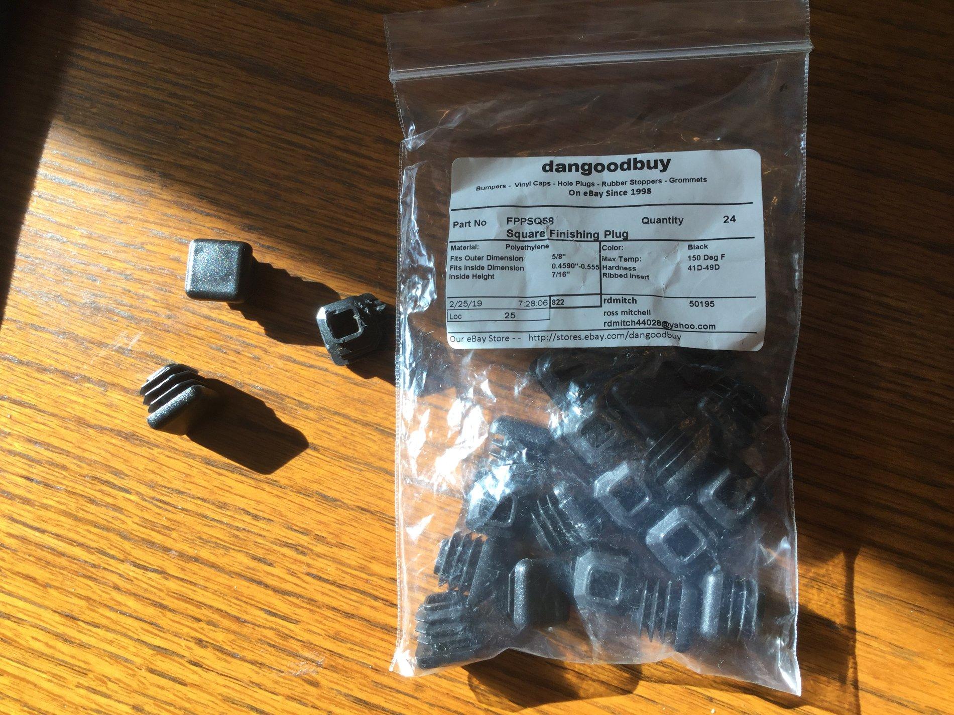

O K you made me go look for these. Here is a picture of the plugs showing top, side and bottom views. Also is the packing bag with the guys name i got them from.
Don’t know if he’s still on ebay.
A word of caution....if your not careful and put them in straight they can possibly fall into the hole and be a real bear to get out.

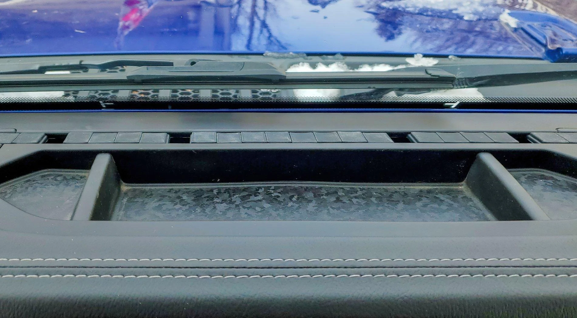

I only started noticing the uneven defrost issue when I put my 35s on and my Jeep no longer fit in my Garage. :) I bought the same bag of 5/8" plugs from dangoodbuy. They came in, I installed them like this (x is a plug; 0 is noplug).
0000000000xxxxxxxxxx00xx00xx00xxxxxxxxxx0000000000
The windshield is defrosting more evenly, but I doubt it'll ever be completely even.
I also noticed one of the plugs fell through the hole when I pushed it in just a bit too hard.
Luckily I had my Swiss Army Knife with me, and was able to grab it and pull it out.
They've got a dozen or so packs of 24 left if anyone is looking:
https://www.ebay.com/itm/24-Square-...Great-for-Jeep-Wrangler-JL-Vents/254075679696
