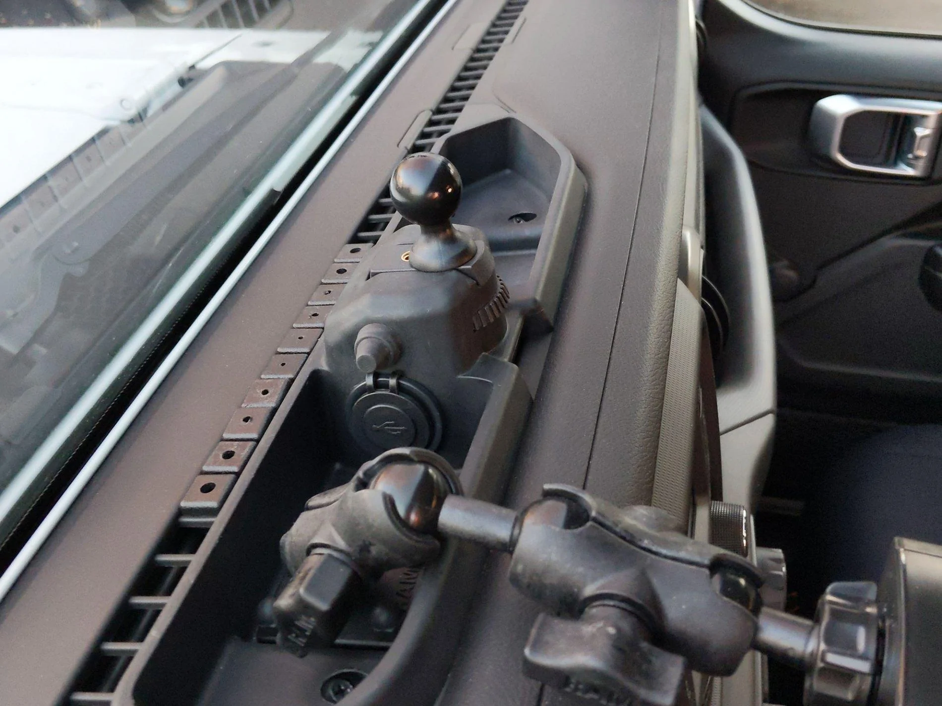

@iblowatsports - the design looks good, I really like the addition of the grill! FYI - I was printing mine with a flexible filament that seems to hold up really well with the temps, grips the vent holes, and doesn't scrap the vents. Here is my latest print.
Is that TPU? I wondered if that might work. I just picked up a roll to try.

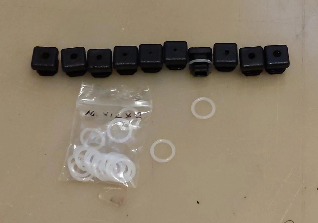

Here's my contribution to a solution. I added O rings to the plugs to hold them in place and drilled increasingly larger holes in them to manage the air flow. Installed, but not tested.

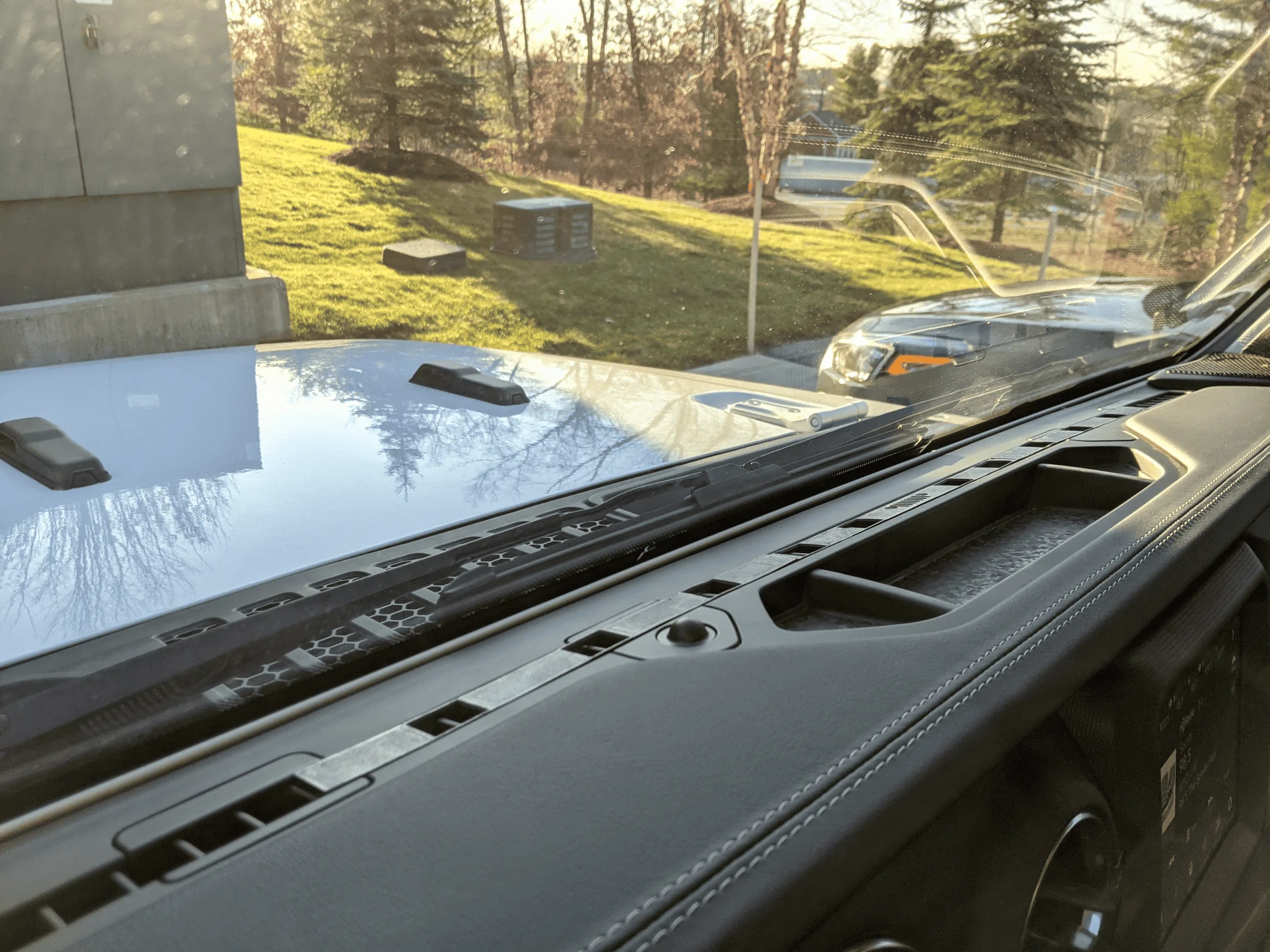

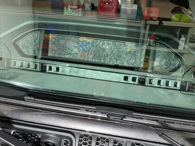

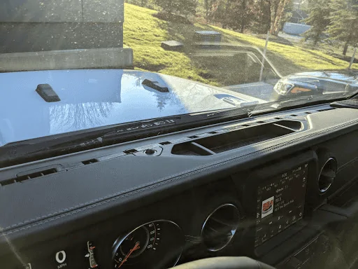

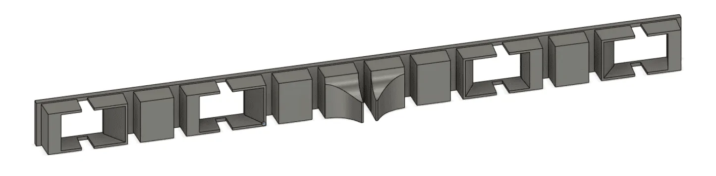

Latest pictures from mine, I was delayed because I had to make a design change since it turns out there is a lip/bar inside the vents on the side closer to the interior that interfered with my "ramps". As of now I am very happy with the results, there are just two things I am looking to resolve before printing these for other people (both related to my printer/the design):
- I ordered a new spring steel build plate because my current one has a few minor lumps/creases in it that show up slightly in the prints sometimes (should be here this week)
- I am going to modify the design a bit to have the ends of the two side covers interlock under the center cover to prevent that little lip you can see between the left cover and the center cover in the picture below. That lip is also caused by said build plate issues which I am resolving though, so this is more just to make the design a bit more "compliant" with any tolerance issues.
All of that being said, I cannot see the covers from a regular driving position and even when I actively look for them, they don't stick out as a "not stock" which was my main goal. The air definitely gets spread to the sides a lot more and seems to be pretty even to me. I would really like to test these in the cold/snow, but for some reason it's going to be 40+ in New England for this whole week....

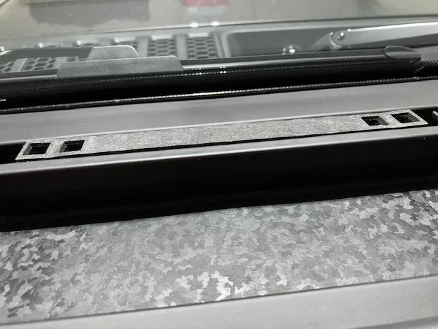

I'm currently using TPU - it has held up well so far - including three 8 hour plus road trips this last month with frosty mornings, so I'm hopeful that the TPU will hold up. I'm happy to help out fellow Jeepers, so I can print either of designs out for those interested in the flexible filament option (I can do more traditional plastics such as PLA and ABS as well). Also it is easy to shift/add openings for custom airflows with my design if some one has a desire to move around the plugs/openings.
