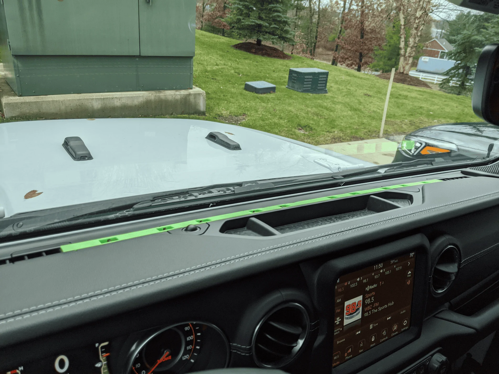

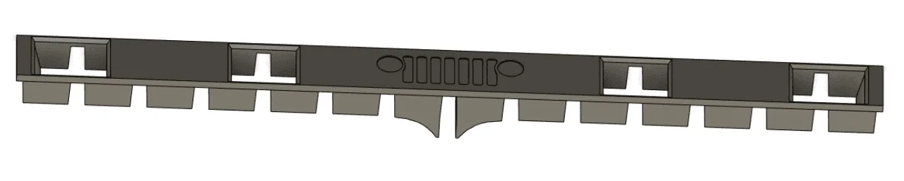

I liked @Tapper881 s idea for the printed covers, so I started modeling/printing up my own as well. Trying out my latest ones today, including this center one with some "ramps" to attempt to divert the air to the sides a bit better
Very cool. Keep us posted. Have you found a material to print with that can handle the direct heat?

These were just test pieces to check the airflow and fit (not looking to have green PLA on my dash)
I am all about supporting this effort. This design looks real cool. Nice touch with the grill logo too! How do we make it a reality?
I hear ya...I have my design printed in orange PETG (only color I had in PETG) for testing ATM.
I have already been printing prototype ones (see above) and I am now printing them in black as a "finished" print. Assuming I don't have any major changes, I'll probably put these models up on Thingiverse for anyone who wants to print them out. The only restriction really is that they are long prints, so you need a larger bed (I have to turn them 45 degrees to fit them on my print bed)
For those of us that do not have a printer - would you be willing to sell them (obviously for a profit)?
Depending on how many people are interested, I don't think I'd have a problem printing them for people if they pay for shipping/plastic (which the plastic cost is negligible for a print like this anyway)
