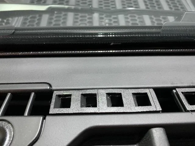

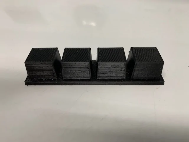

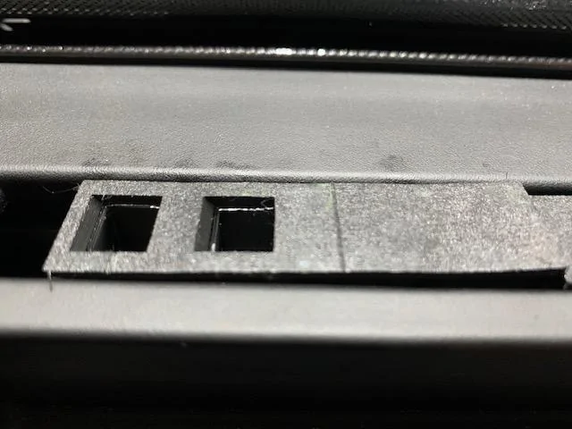

I 3d printed these. Currently, I printed 2 strips long enough to cover 10 vent holes each. I can go larger on my printer;s bed by a few more holes at least, but the holes seem to taper a bit as they go out past where I have the strips currently. Time will tell if the design works or needs to be tweaked. Also, I printed this with PLA which is not known for high temperature resistance so I also need to monitor if they are affected by the defroster on high heat settings and how they hold up in summer temperatures. The latter wont be able to be tested until next summer but, worst case I can just take them out in the summer. If it can't stand up to the hot defroster temperature, I may be forced to learn how to print ABS which is much more temperature resistant.
Any chance you could put the models up for these? I print in PETG most often, which should hopefully handle the temperature a bit better than PLA
As fall is upon us -- I figured I better get busy and do a little design work and 3D print some vent plugs. Here is what I cam up with: Some are designed to block the airflow, while others angle the airflow to the wings. Thoughts? Anyone want to test/provide feedback for improvements?
I would be up for trying them in PETG as well. I like the angled design.

What I'd really like to do is having something underneath the defroster vent grill, rather than just plugging up some of the vents. I have no idea how hard it'd be to get the grill off (without damaging it), but I think having something that mounts to the underside that is a continuous wedge shape to divert the flow of air to each side (with some holes to keep center flow as well) would be the best setup and would look stock if done right
