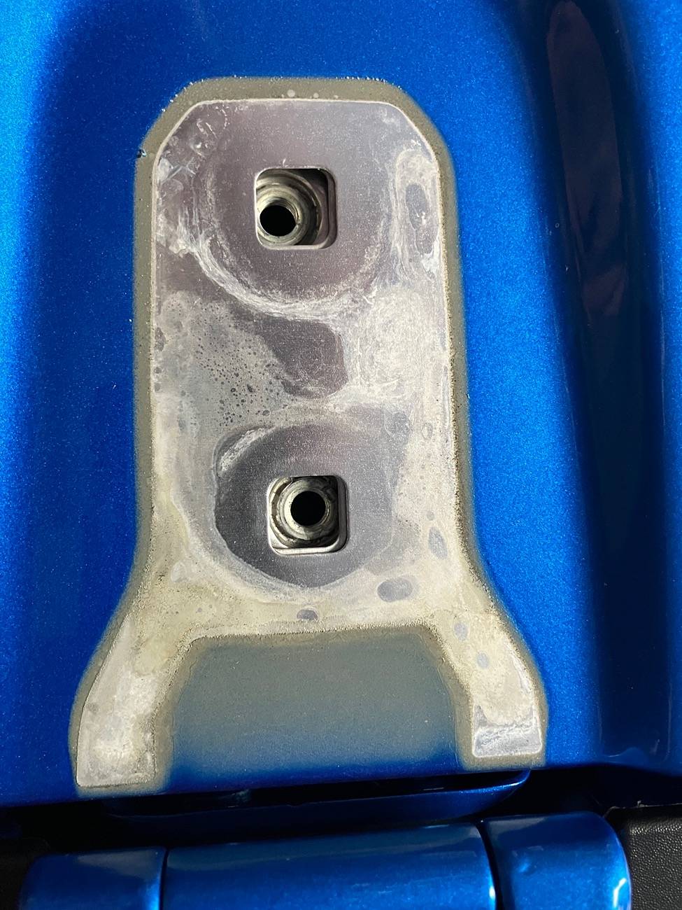

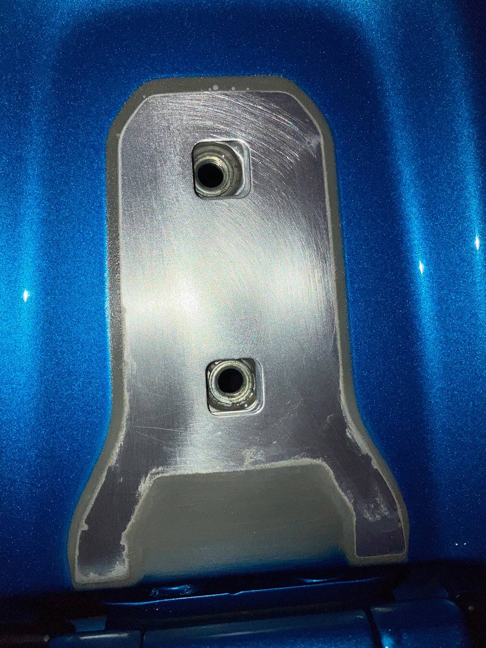

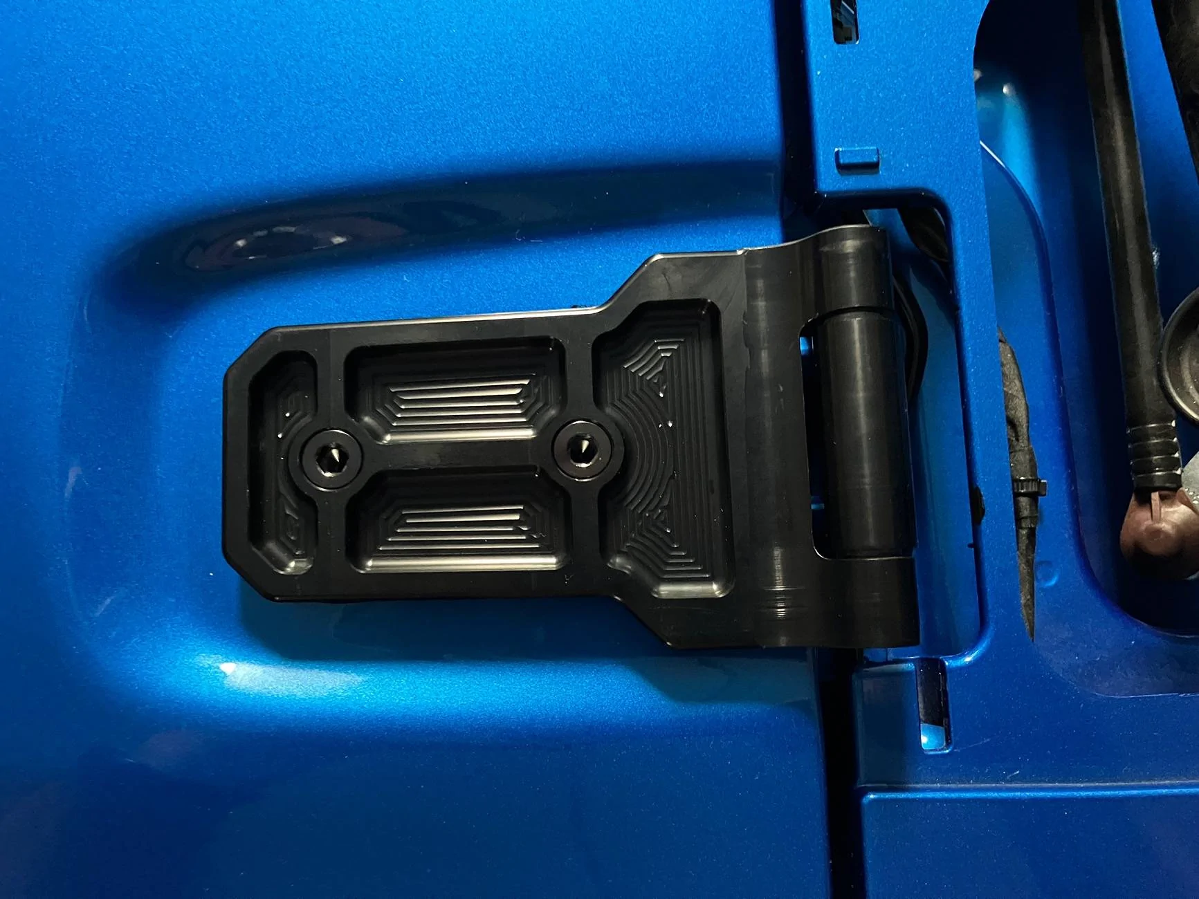

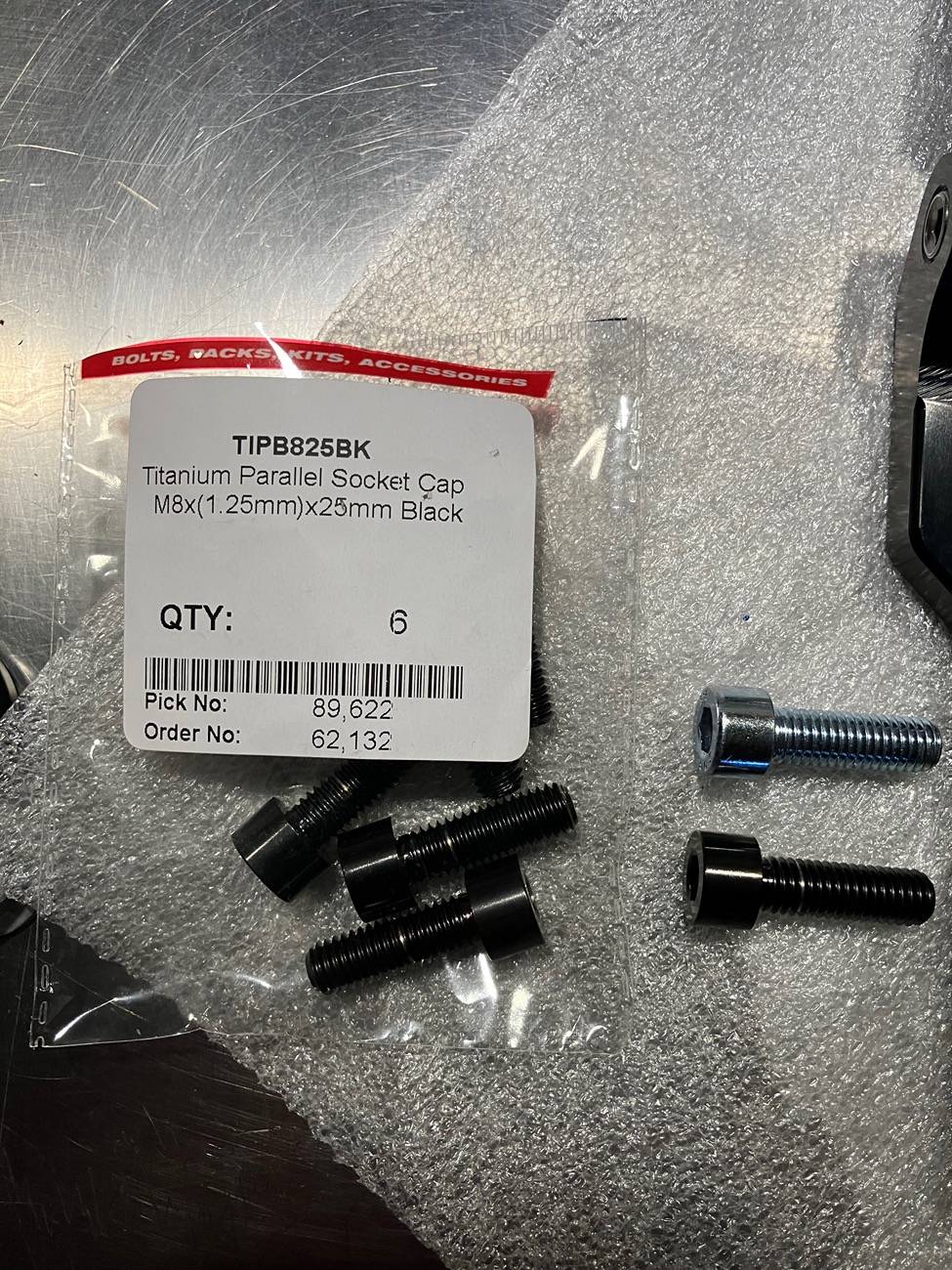

I did that. Replaced all my hinges, and sealed the raw aluminum.
Which hinges did you replace them with? What did you seal the raw aluminum with?
ScotM
Scot
Jan 3, 2023
39
1,259
1,930
Southern California
2022 Jeep Willy's JL 2 Door
I used 74Weld for the door hinges, royal hooks for the hood, and teraflex tailgate reinforcement on the rear. I used POR15, but I wish I had used Eastwood 2k epoxy instead. I think that would have been a better choice. It’s been 2.5 years and no issues with the POR15. I also put a thin 3M automotive gasket between the hinges and the body, just to get a good seal. I just got a 8x10 sheet and cut out a template. Here is what my hood hinges look like. I did upgrade the hardware to black on the hood hinges, and used a 2k epoxy on the door hinges to make them black as well
