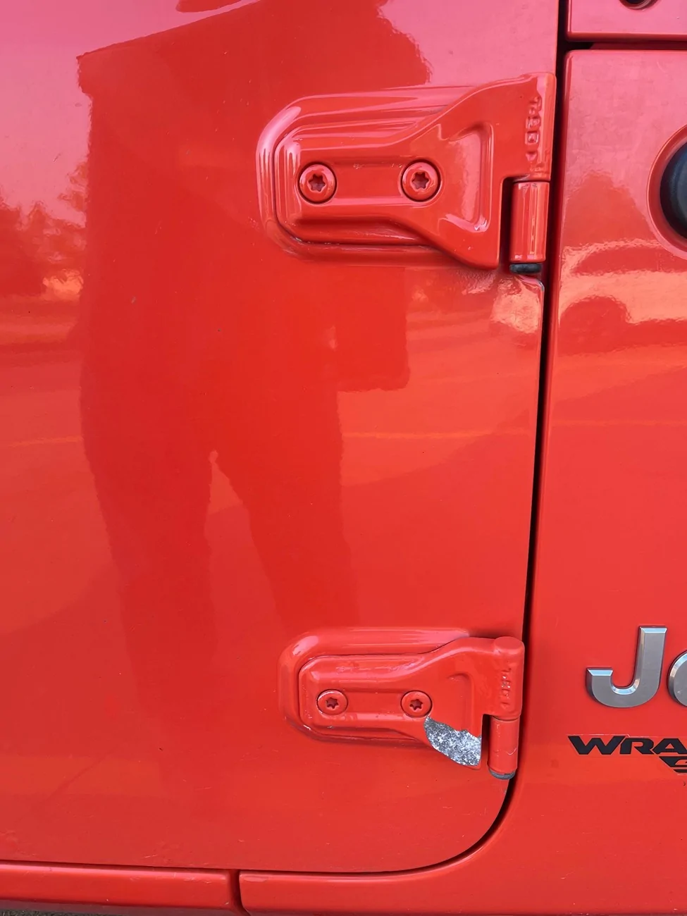

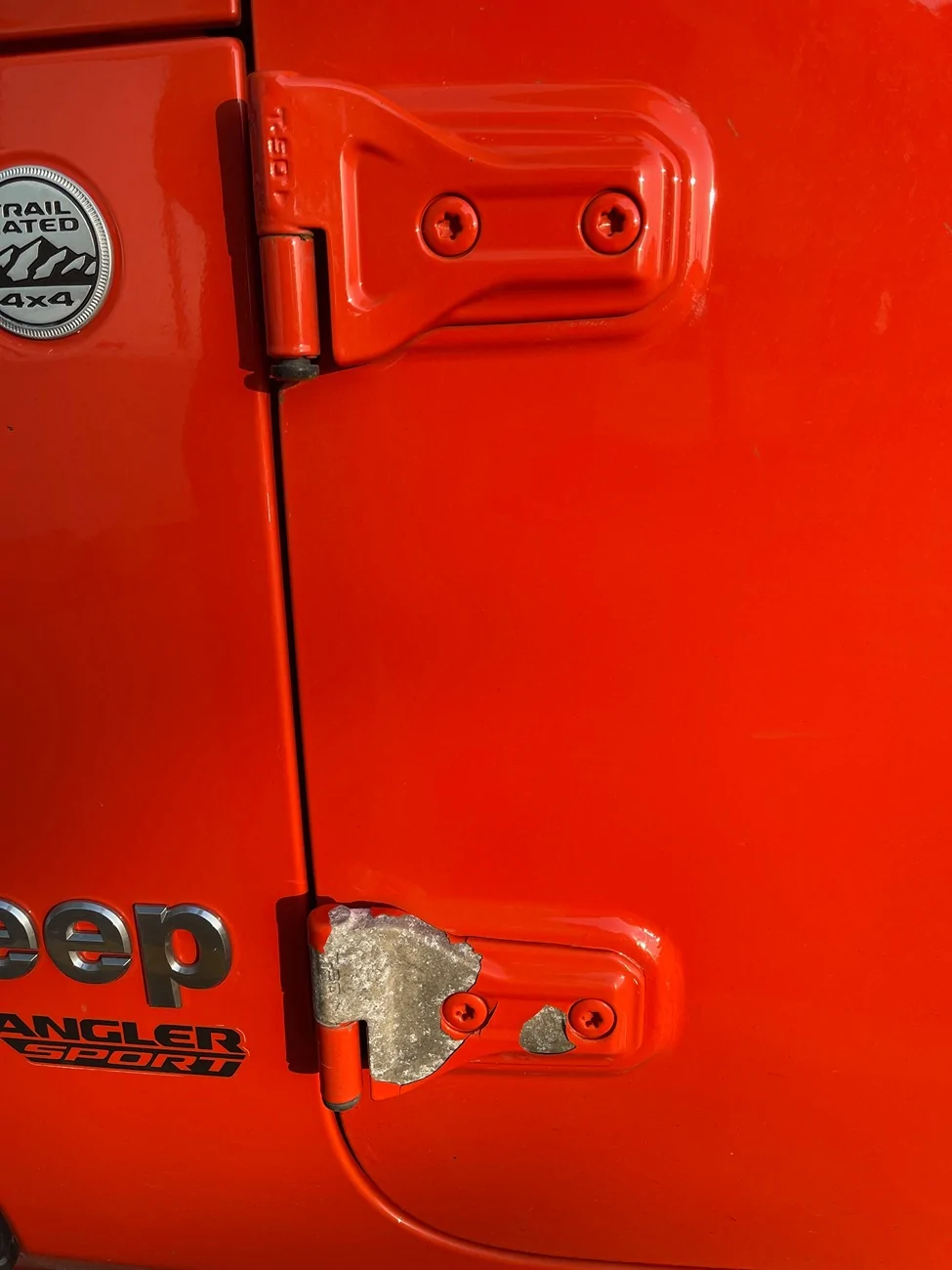

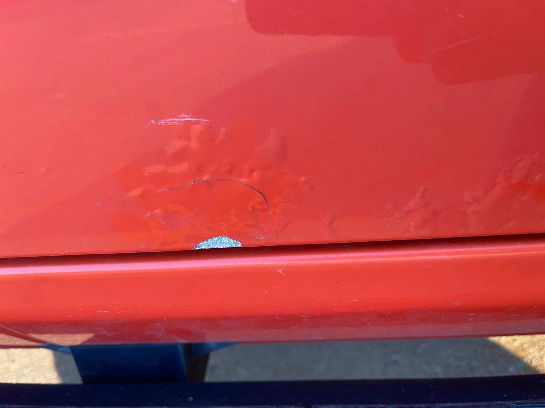

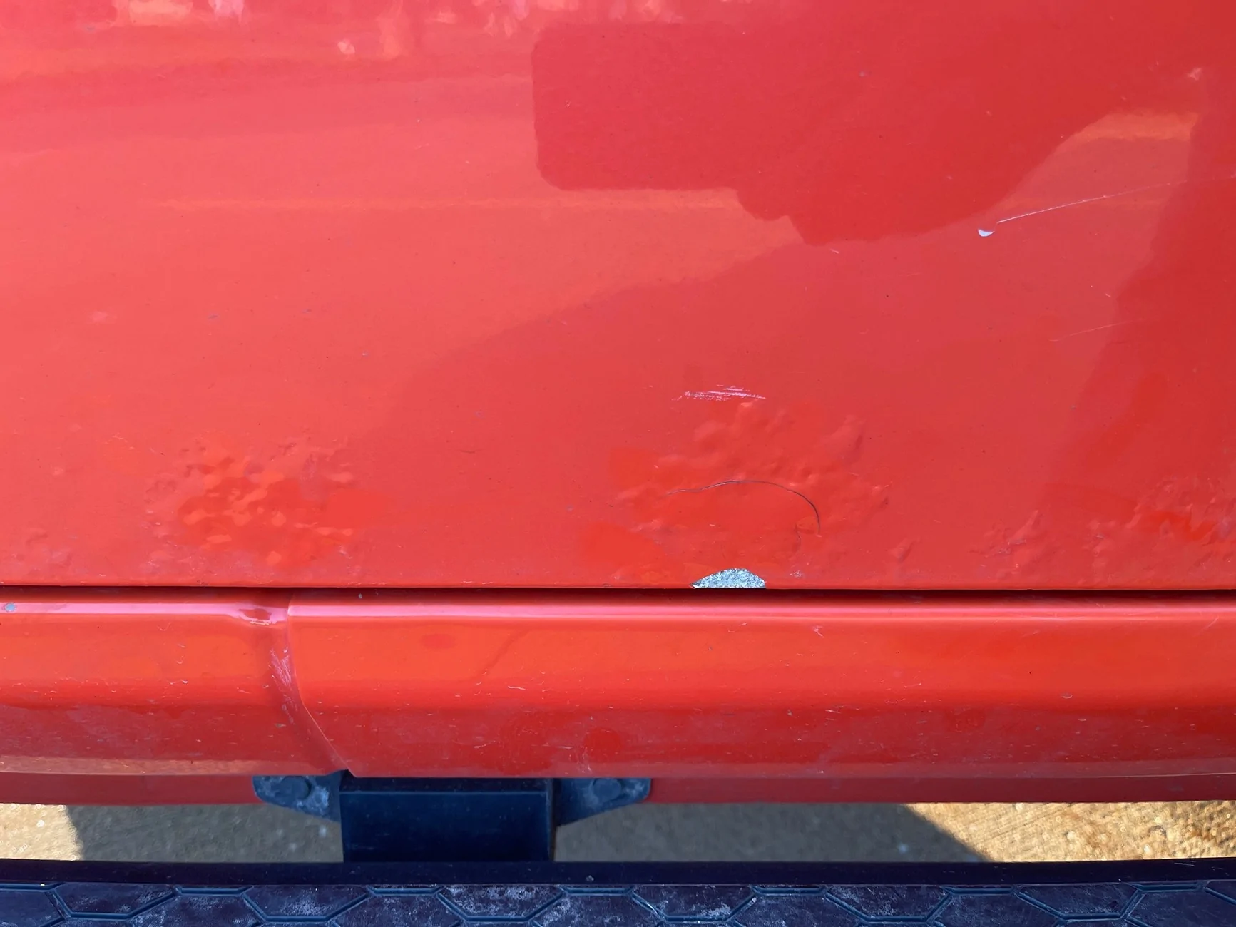

@JeepCares I customer ordered my 2018 JL Wrangler Sport in the fall of 2017. Last year the paint on both lower door hinges started flaking off and this year I noticed paint bubbling and cracking. I waited 15 years to buy that Jeep and, after this experience, I doubt I'll buy another one, unless Jeep steps up and makes this right. I got a quote for over $6000 to fix both doors and blend in the paint color to the side panels but I should have to do this on a vehicle I purchased (ordered!) new. I could drive around with a Jeep missing paint on the doors and let that reflect back on Jeep but it's becoming embarrassing. What do I do?

First, let me say: my condolences.
Good luck with @JeepCares . the best you can hope for is a dealership agreeing to pay 1/2 of "Their Total Cost" for the repair. I would take the doors off, and have them sand blasted. Then repainted at a reputable shop. Do as much of the prep work yourself.
