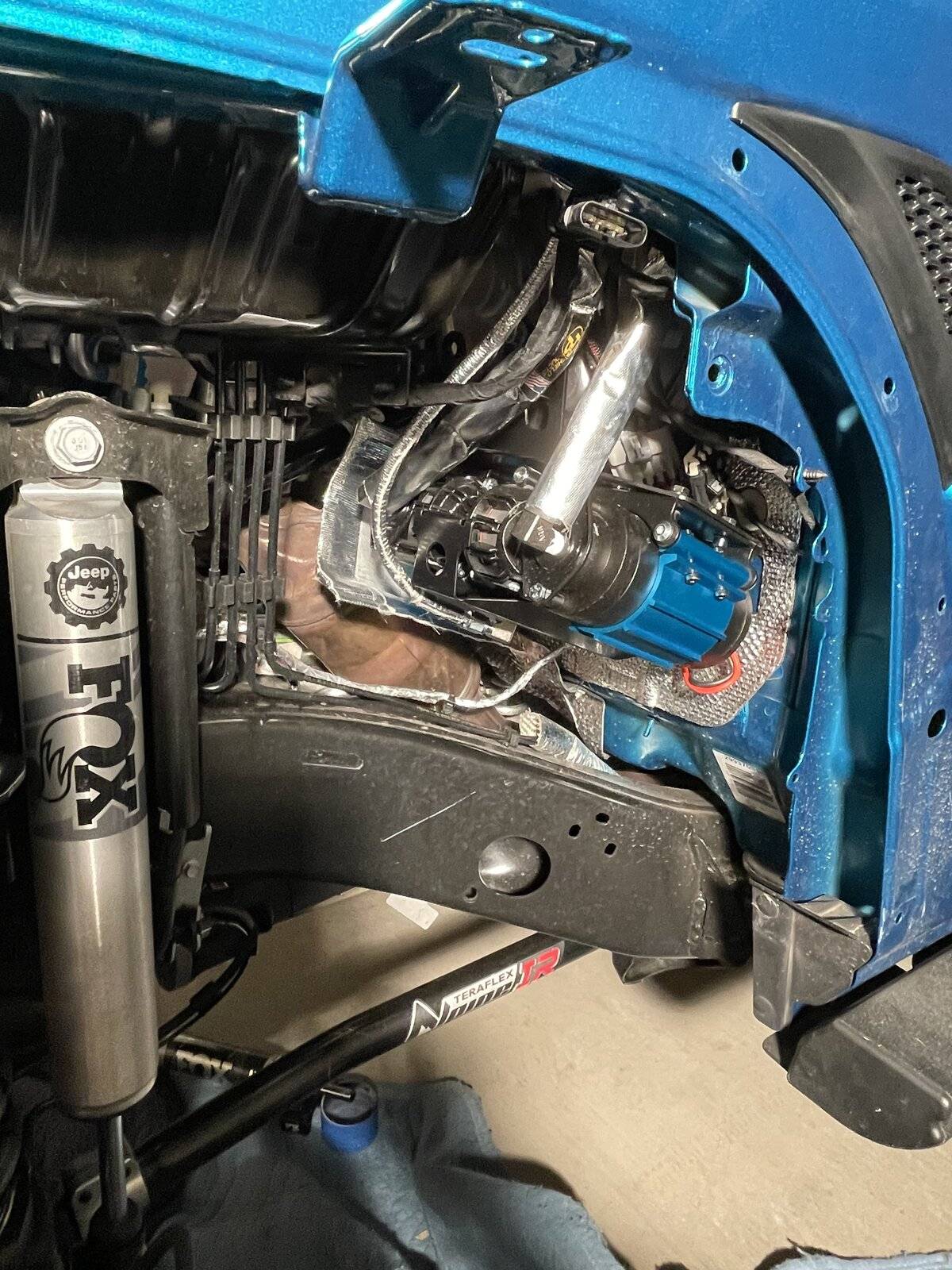

As others have posted, I went with the ARB Twin using the Grimm Off Road underhood mount. The only thing I did different and since I do live in Hells Acres, (AKA Arizona) I added some additional heat shielding to the included heat shield as well as use heat shield sleeves on all lines. Could not be happier with this setup!
Jeep Wrangler JL Onboard Air Mounts IMG_2064

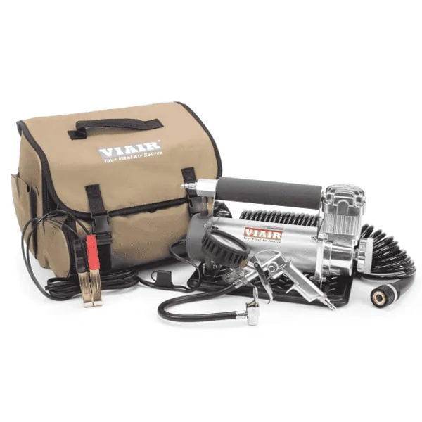

Like this:
There's always a clown in the crowd somewhere. ?
I've got one of these and definitely like the portability. But it'd be nice to have a good mounted compressor, especially tucked away somewhere to optimize available space.
